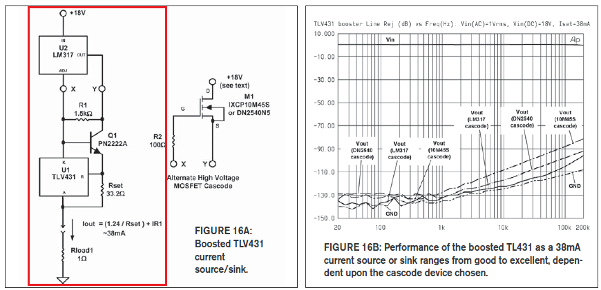

"I don't even know what type of CCS to use"
The most critical value is the available voltage on the first stage cathodes: +3V
If you want to use such solution (CCS between cathodes and "ground"), only BJT can be considered as CCS.
Instead of this, I suggest to use negative voltage (12...20V) for CCS "negative" point, so wider variety CCS will be usable.

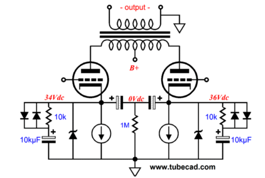

The output stage looks a little like this Tubecad idea:
For what it's worth Eli recommended ECC81 run with 200V on anodes and 3 mA per tube as a "sweet spot", but YMMV.
What is R9/C3 for? Some kind of active PSRR improvement? I don't think I've seen that before.
- Dual CCS to allow unmatched tubes (different DC on cathodes, but cathodes AC coupled through capacitors)
- 1M resistor at capacitor junction to provide a DC bias across each capacitor
- zeners to prevent cathode voltage rising during sustained bursts of high power, shifting the bias point
- Capacitor/10k resistor/diodes (missing from your circuit) softens the transition when the zener conducts
- Broskie usually shows LM317 based CCS for output stages
Thank you all for advices. I just got the book from Morgan Jones Valve amplifiers 4. edition.
CCS with BJT and FET for vacuum tubes applications are well described here. Various variants. I recommend for study.

tikiroo,
Push pull output stages that have individual CCS in the cathodes, are intrinsically Class A circuits.
A long sustained 30 foot organ pipe will take the charge out of the bypass caps, so the long term output stage cathode current will be limited; can not sustain Class AB for long periods.
Instead of CCS, individual self bias resistors with bypass caps will work well for Class AB.
Or, if it is desired to not need bypass caps; a single self bias resistor connected to parallel cathodes will work well for Class AB.
