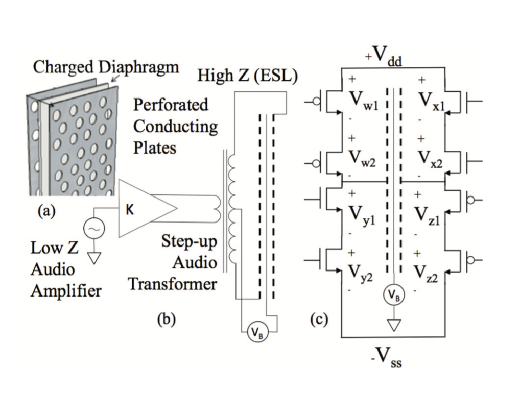

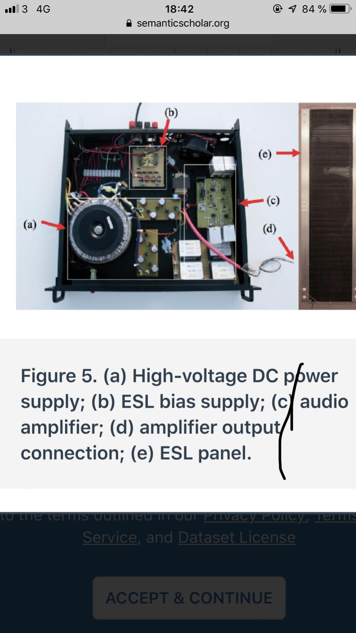

Back to ESL direct drive, some more focused Internet searching reveals that this area is not completely new territory (HV MOSFETs were already used back in 2012)
High-voltage class-D direct-drive audio amplifier for electrostatic loudspeakers
John Kota, Daniel Holman, +3 authors Malik E. Elbuluk Published in IEEE 55th International Midwest Symposium on… 2012
DOI:10.1109/MWSCAS.2012.6292085
Electrostatic loudspeakers (ESLs) are capable of low distortion and have desirably flat frequency response within the audio frequency range. In this paper, a novel approach is proposed for audio amplification using a high-voltage direct-digital solid-state class-D amplifier as a method that replaces impedance matching ESL audio transformers. Optical coupling is used to achieve isolation from the high-voltage side. The proposed stacked MOSFET output stage provides a solution to the voltage swing limitations of the available switching power MOSFETs.
(Research done at Univ of Akron, OH)
MOSFETs used were STFW3N150 Vds=1500 V @ 2.5A

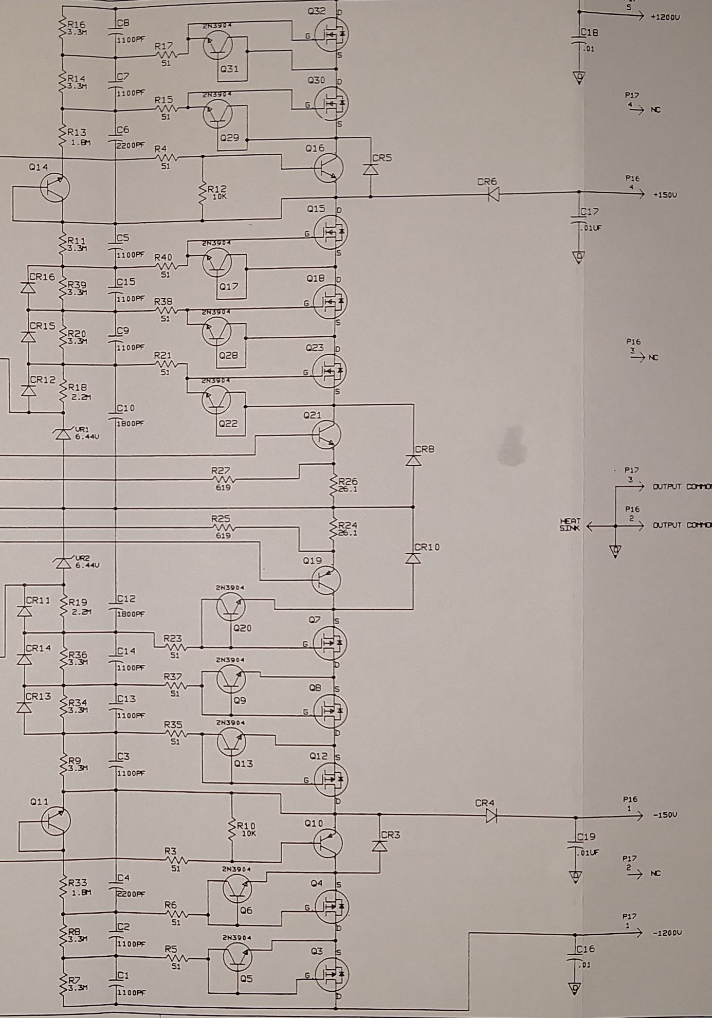

Attached is an output amplifier stage that runs off of + /- 1200V rails.
It is not an audio product. You could call it an industrial product. It is probably overkill for audio.
I have built ESLs including everything, panels and power supply. I used UTC transformers to step up the audio voltage.
One technical hurdle is how much current your speakers will require. This current at high voltage will likely be lethal.
From an amplifier standpoint, the heat problem may not be huge. If the load is largely capacitive, the current will be out of phase with the voltage.
To the extent that the speakers actually consume real power, which they must to make acoustid SPLs there will a resistive component to the speaker and so some current will be in phase with some voltage.
The good news is that most likely the actual acoustic watts will be a few watts and the speaker will probably only consume a few watts. Just a guess. Measurements would tell the actual story.
If I really wanted to know, I would place a resistor in series with a normal ESL system and have a look at phase of the current vs voltage at various frequencies and SPLs.
The Acoustat Answer Man on the Exotics forum here may know how much real power is consumed by the venerable Acoustat Monitor X direct drive system as well as how much current is needed at the high voltage.
