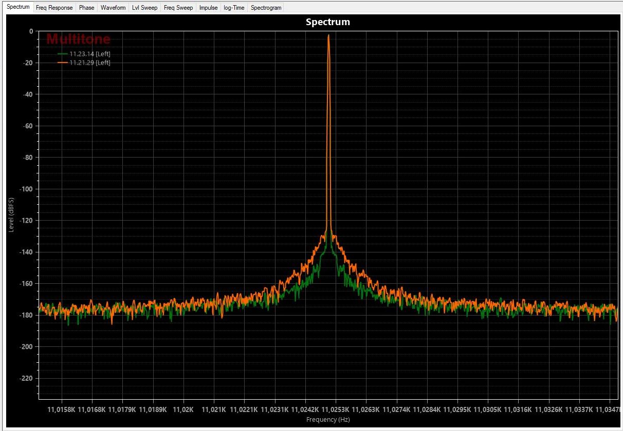

If the purpose is to look at close-in phase noise (e.g. +-10Hz around the fundamental) the clocks of dac and adc should be coherent. Otherwise FFT spectral leakage will result in high noise skirts that effectively hide all differences between clocks or Vrefs. That is why Cosmos ADC as is does not really work for this type of measurement. But of course for wide band J-test measurements clocks can be non-coherent.
With coherent clocks it is possible to see differences in close-in phase noise between dac chips.
E.g. here is ES9038Q2M (orange) vs. AK4493 (green) with more or less same Vref and clocking.

What you are looking at there is the additive phase noise of the internal stages of the DAC and the clock distribution to drive both DAC and ADC with a common clock. The jitter in the source clock will cancel out to some degree. Spectral leakage will also come from different window functions and may be real and hidden with a common clock. I may try this if I can find the time to see what happens.
Its interesting but I'm not convinced its significant, especially if the first bit of noise is at -130 dB. How many samples in the fft? How many averages? Effective bandwidth? Could the analog stages after the DAC introduce the phase noise you see?
Its interesting that the AKM is a little better than the ESS.
I doubt its physically possible to maintain that phase noise with transducers and air in the chain. It would be an interesting experiment.
I haven't made any claims about the audibility. IMO this is similar to chasing ppm distortions or >120SINAD. Low close-in phase noise is an indication that there are no significant faults in the clock or Vref implementation. Besides a DAC having high noise skirts (e.g. due to poor Vref) can still have SINAD > 120dB. This just goes to show that high SINAD does not tell everything.
IME there are practical problems with these measurements. ADCs have limited resolution (about 20 bits). Also it is difficult to have low enough DAC Vref noise that does not overshadow clock noise.
These were about 15 minutes recordings at 44.1 kHz so there are over 32M samples. Results can be viewed at e.g. 32M FFT with no averaging or 4M FFT with 8 averages and in both cases even without FFT windowing as that is possible with coherent clocks. Bandwidth is not very relevant. The horizontal scale on the graph is +-10Hz around the fundamental (11015Hz to 11035Hz).
The resulting phase noise probably includes lots of noise sources. E.g. DAC/ADC Vref, DAC/ADC clock, DAC output stage, ADC input stage. However as ADC is the same the differences come mainly from DAC.

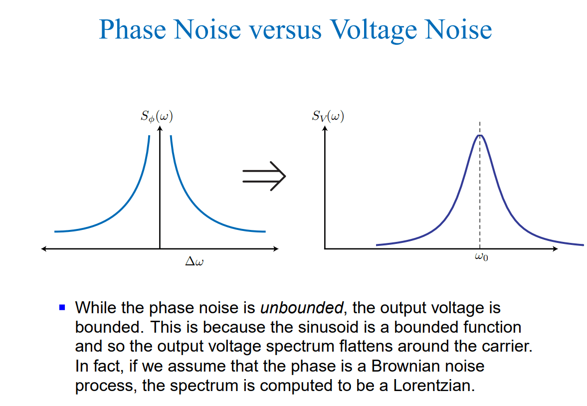

A brief comment on noise: Correlated noise and uncorrelated noise are two different things. They should look different on an FFT. Correlated noise is produced by some process like multiplication in the time domain. Uncorrelated noise is additive. Most of the noise produced in a dac output stage would presumably be additive, and thus uncorrelated. However, noise that becomes intermodulated with a music signal or test signal would be correlated. It is correlated noise that shows up as noise skirts. Uncorrlated noise shows up as a change in the overall noise floor.
Also, phase noise is not equivalent to noise skirts. Noise skirts are the sum of phase noise and amplitude noise each of which are intermodulated with the signal. Phase noise in the frequency domain only corresponds with random timing errors in the time domain. Correlated amplitude noise in the frequency domain corresponds with multiplicative amplitude errors in the time domain, such as those produced by Vref (which is multiplied by the the music signal or test signal inside a dac as viewed in the time domain).
Some additional information attached.
  • Phase-Noise_and_Amplitude-Noise_Measurement_of_DACs_and_DDSs.pdf
