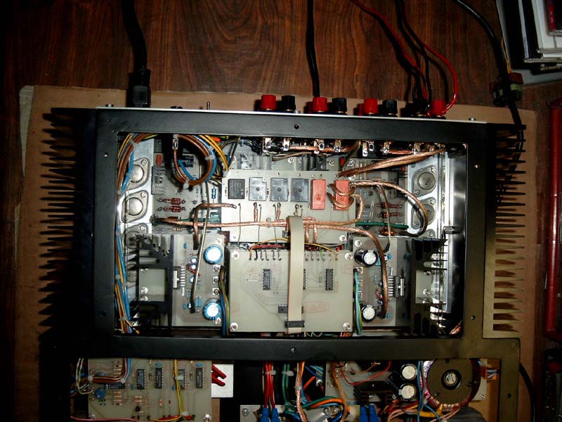

I almost have finished my Crescendo amplifier. It took me 5years to build this beast.
It uses 2x (2 x 2sk135 en 2x 2sj50) mosfet's from Hitachi. You can visit my homepage, where you can find some foto's. In the same enclosure, I builded also 4 smaller amplifiers. The supply consists of 3 toroidal's from 500VA each and a total of 130000µF on capacitors.

Well, I can't really compare this amp with many others. But I've build also the crescendo ME with the newer output devices. And my opinion is that the "old" amp sounds better than the new one.
I can't realy describe how it sounds. I think this comes from these devices, many say that these are one of teh best audio MOSFET's ever made.

I wouldn't build the crescendo 1982 with only 2 devices in parralel, in 4ohm, you are far over the SOA curve off these devices.

hi
i dont know how much this would help but we have driven the crecendo with 2 X 750 VA ie 1 750 Va per channel with a few mods as higher voltage rating input trannies and 1 with a seperate suuply for the original input trannies while the mosfet output was fed with 750 VA
We Had Used Only J 56 & K 156 , they yet rock after 13 years and are going strong as ever
we use these for testing drivers - have fed them all type of wave forms - short circuited the out - put - when our test drivers have blown !
no probs with the amps - rock solid
suranjan
