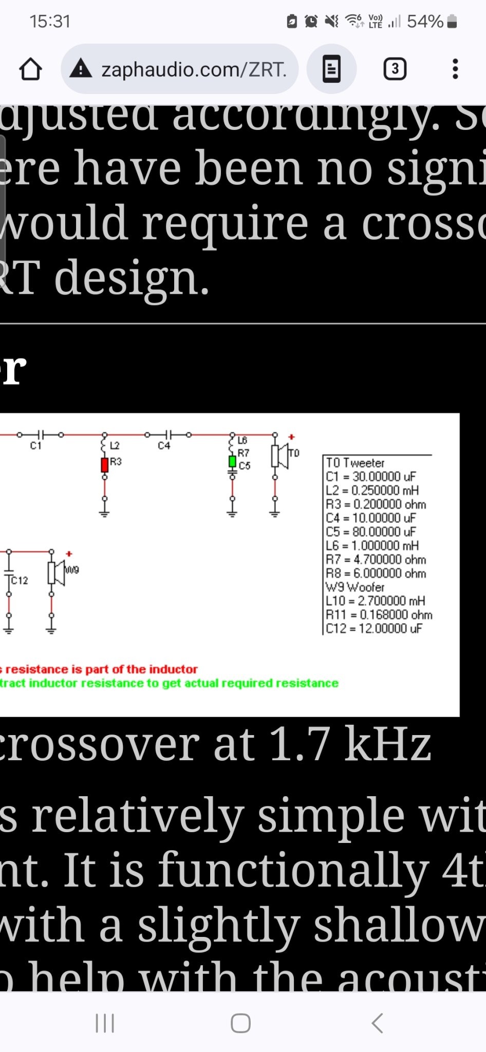

Hp: serie 4,7 ohm- 8,2uF
parallel 0,300mH - 2,2uF-3,3ohm (series)
Your high pass filter would appear to be 3rd order (18 db/octave), i.e., capacitor in series followed by a parallel coil, followed by a capacitor in series.
In that case, your existing 1.7 kHz crossover point certainly won't damage your tweeter.
If you use it as a two way with limited power input, you should be just fine with the crossover. You could see how long this works well, if you had distortion measurements of the tweeter.
On the other hand, if you add a subwoofer and a low cut for the combination, you can have a lot more SPL and the tweeter will have problems. With 2.500 Hz x-over you should have a speaker that is fine in both cases. I don't see any advantage for 1.700 Hz. Both tunes will sound just fine.

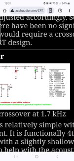

zaphaudio cut the same tweeter like this
In that circuit, C1, L2 and C4 form a 3rd order high pass filter - the other components will be there to tweak the tweeter's response.
On balance, particularly if the combination sounds good to you, you may be best to leave well enough alone!

It is not possible to answer your question. It all depends on the response of the midrange or tweeter. Take a look at the on-axis and off-axis response curves of your drivers in your box/baffle. You'll want to aim for a smooth off-axis response (dispersion).hi, based on these graphs what frequency of xo would you use for the crossover? Thank you
do you mean that I might be better off leaving the values I thought of instead of the zaph ones?
You said the crossover you were currently using "cut at around 1.7khz" and that's the one to which I was referring.
