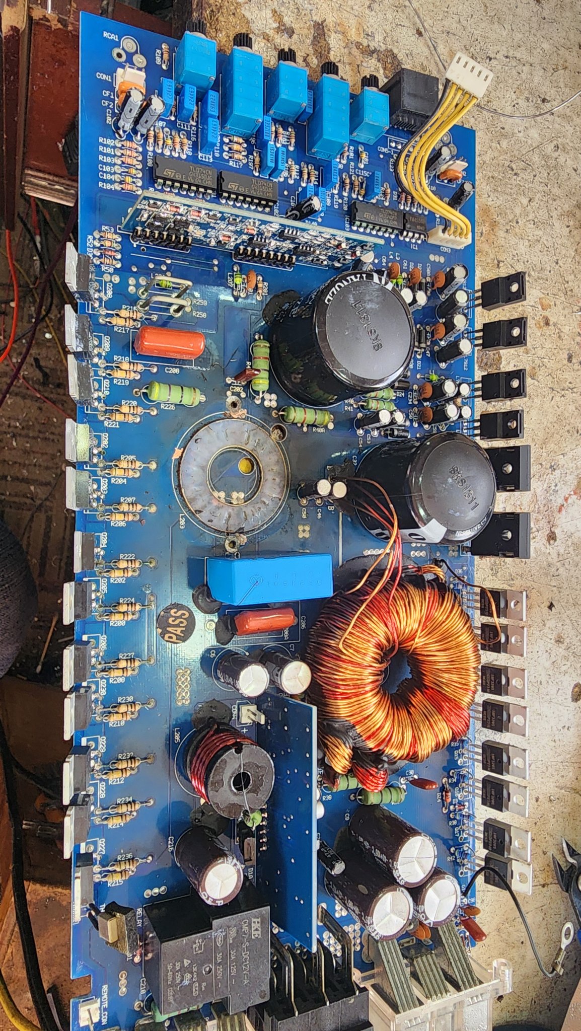

CT Sounds AT900-1D

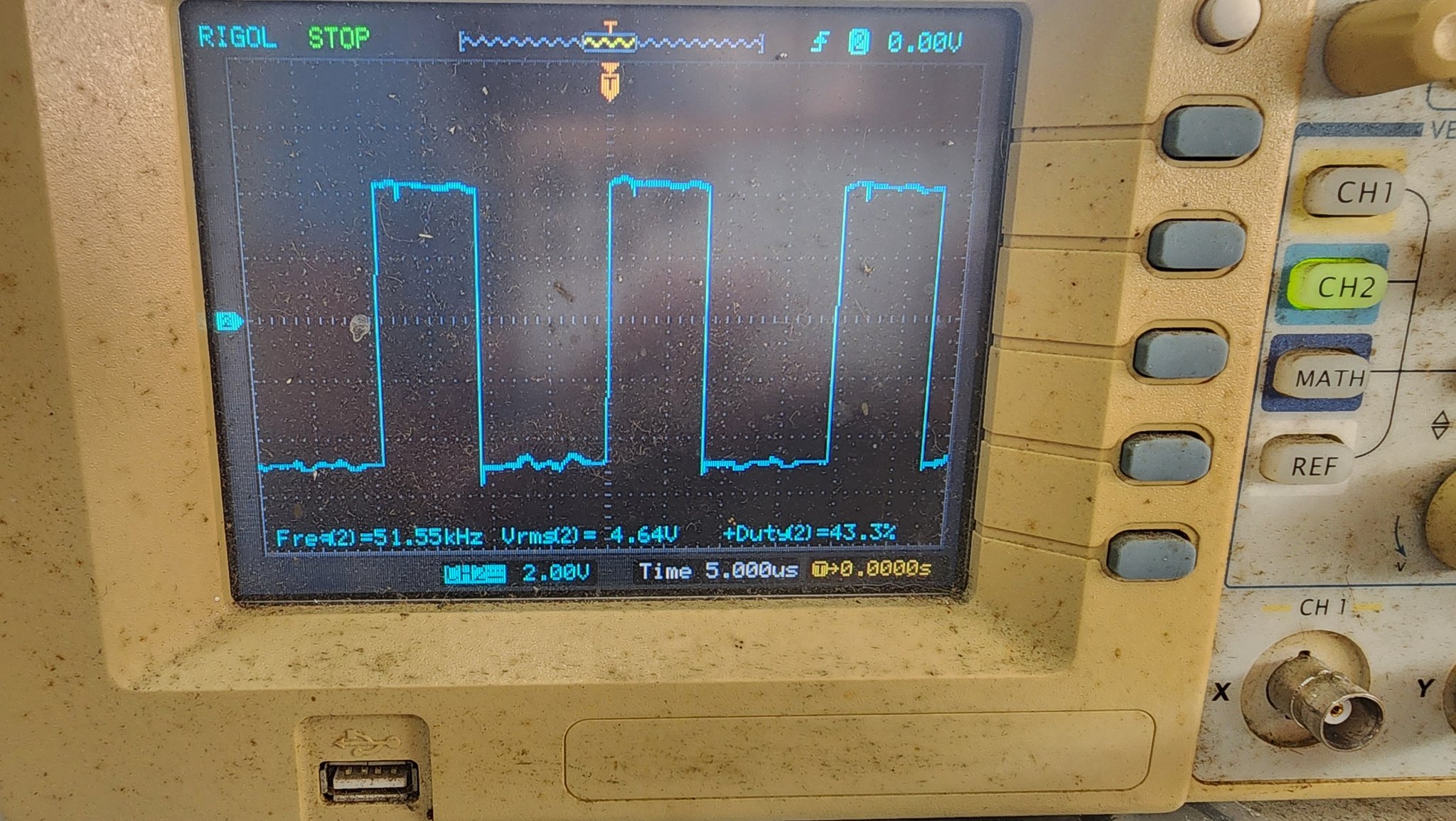

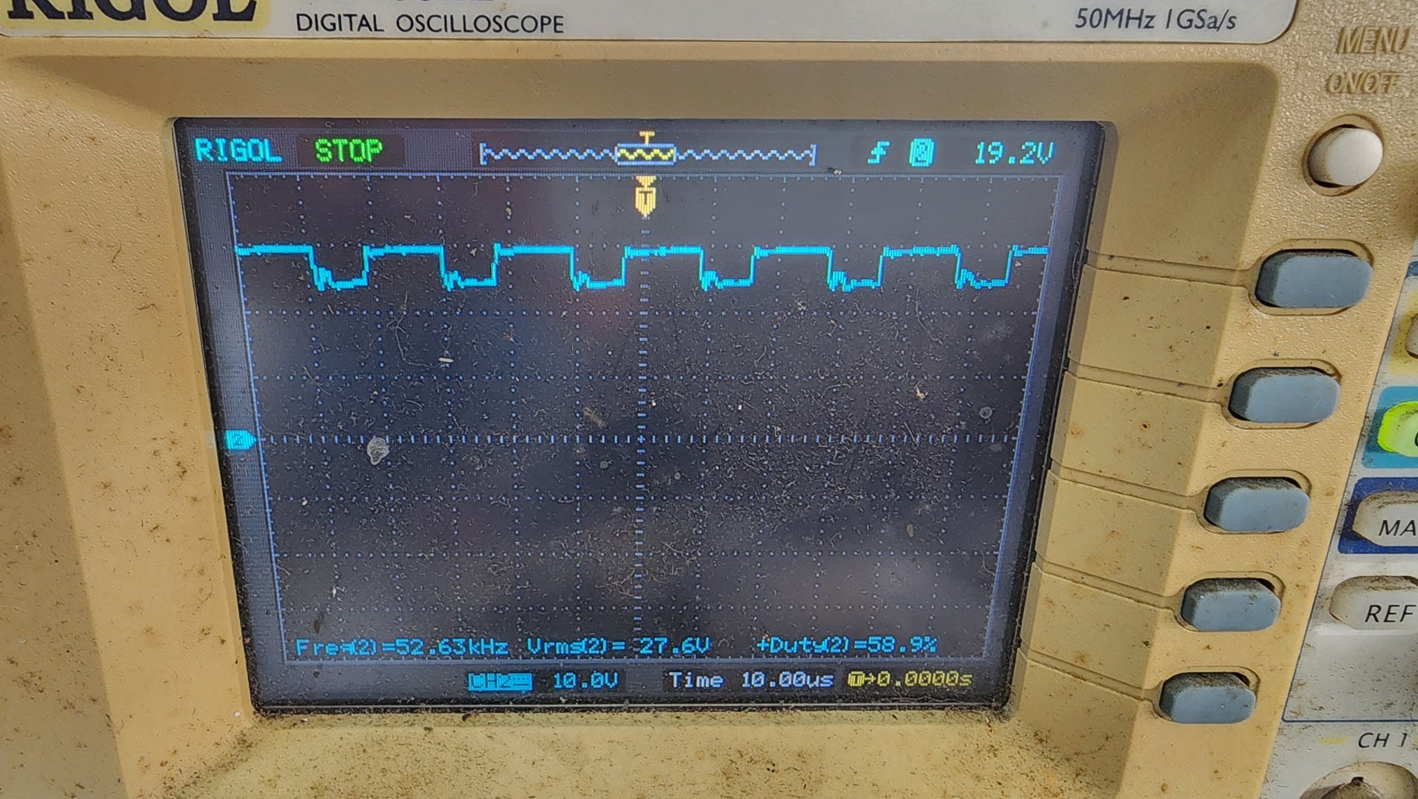

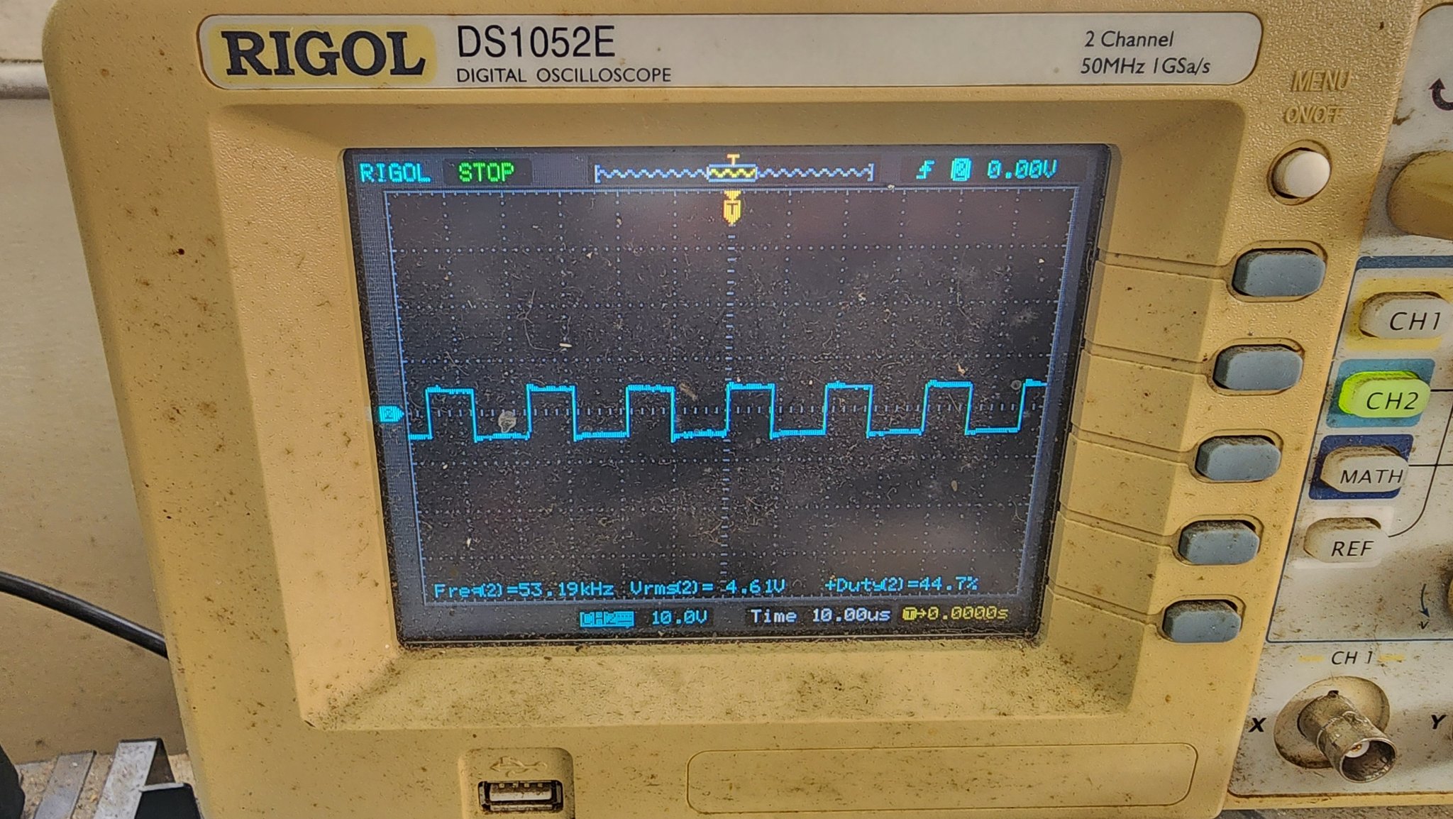

Changed power mosfets and output mosfets.
Outputs are 6 IRF640N and 6 IRF9640.

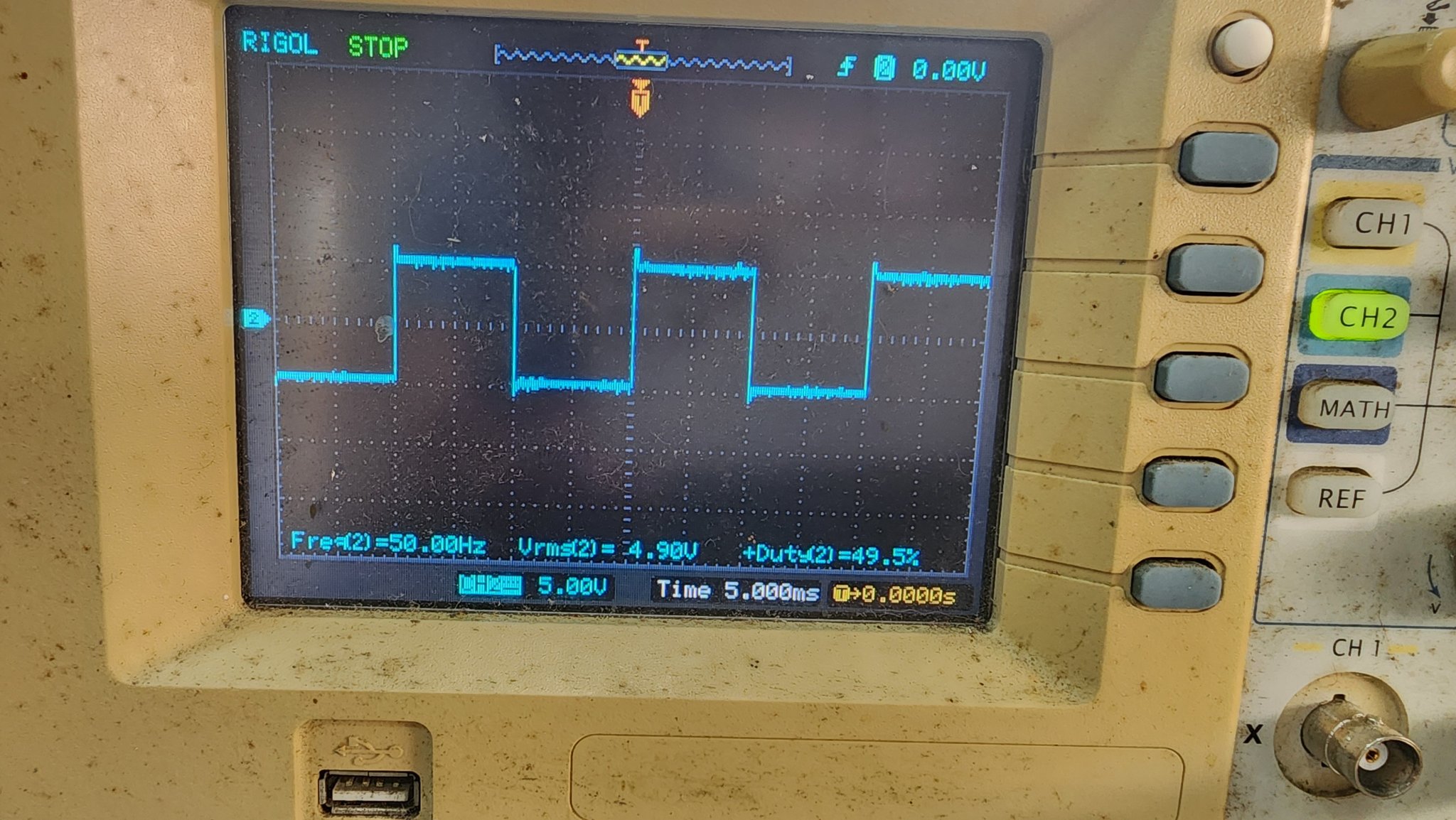

Amp pulls plenty current. IRF9640 gets very hot. With current limiting resistor amp pulls 3amp and giving very clean output.
