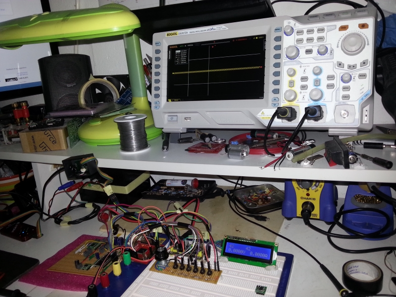

My current project is finished. and next will be battery tester, with 800a discharger included.

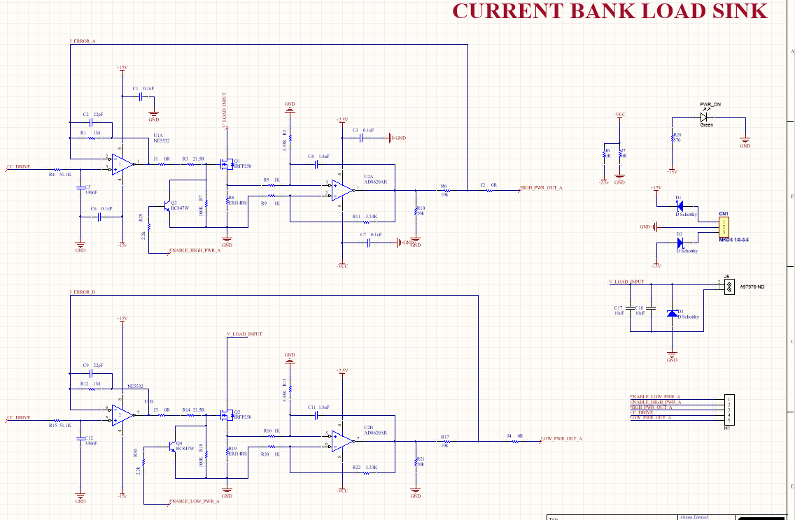

Attached are my simulations for my x2 0.12ohms (0.6 ohm) current shunts, each can deal with 10A @5Watts. I found a box of 25pc unused dale 3W LVR3 resistors :D

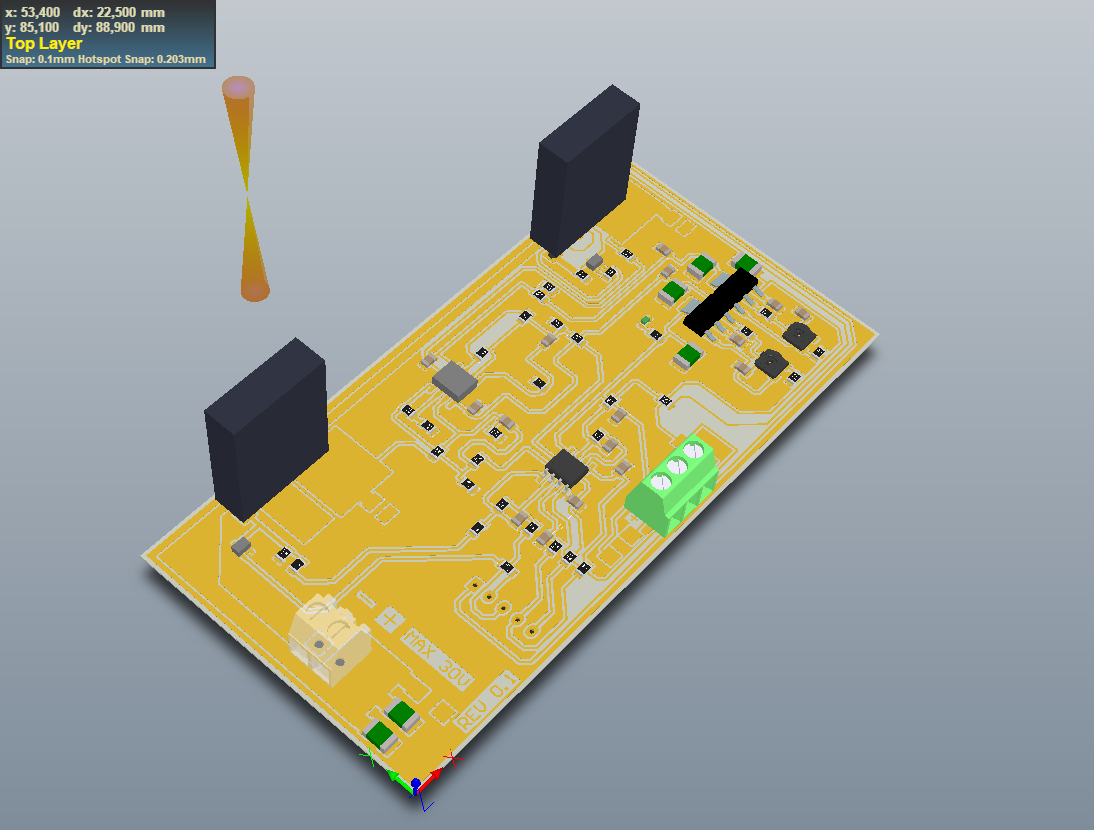

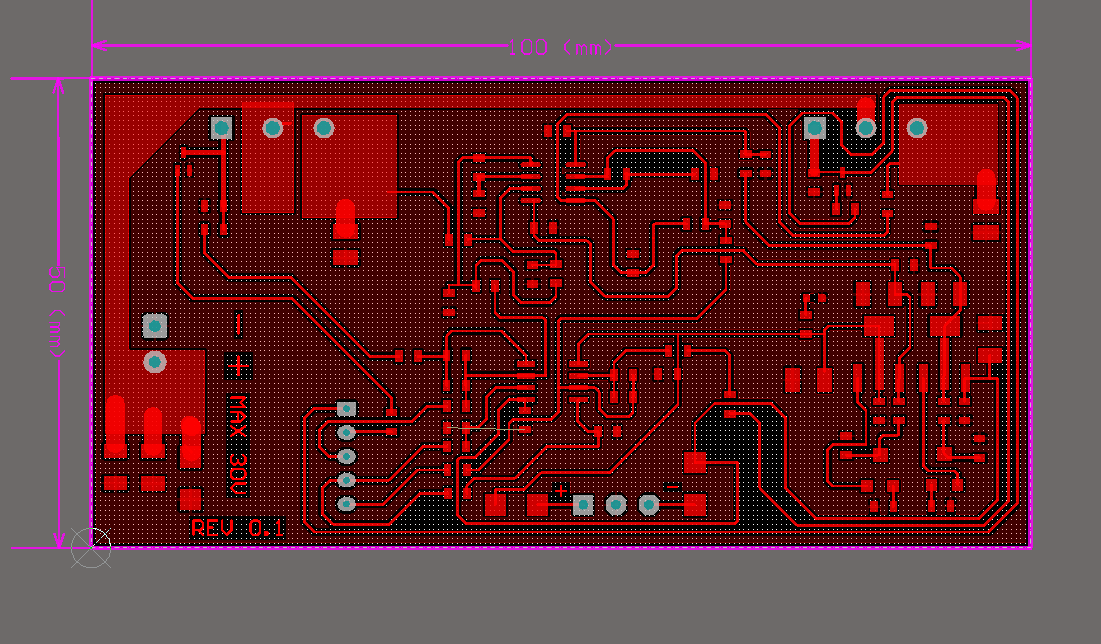

Also, see some assembly progress, thus far I found only one stupid PCB error I accidentally reserved the inputs to the regulators 317 and 337. luckily I used a psu with active current limiting set to 50mA. Both voltages are +/-1.5V with an effective 3V to interface with the MCU signal path.
I am finalizing my final multiplier / divide network, a screen grab
Do they work with +/-1.5v?
if not, you can make 3v signal from +/-15v opamp easily by resistors.

will upload if you need my layout. it is based on previous schematic of discharger.
