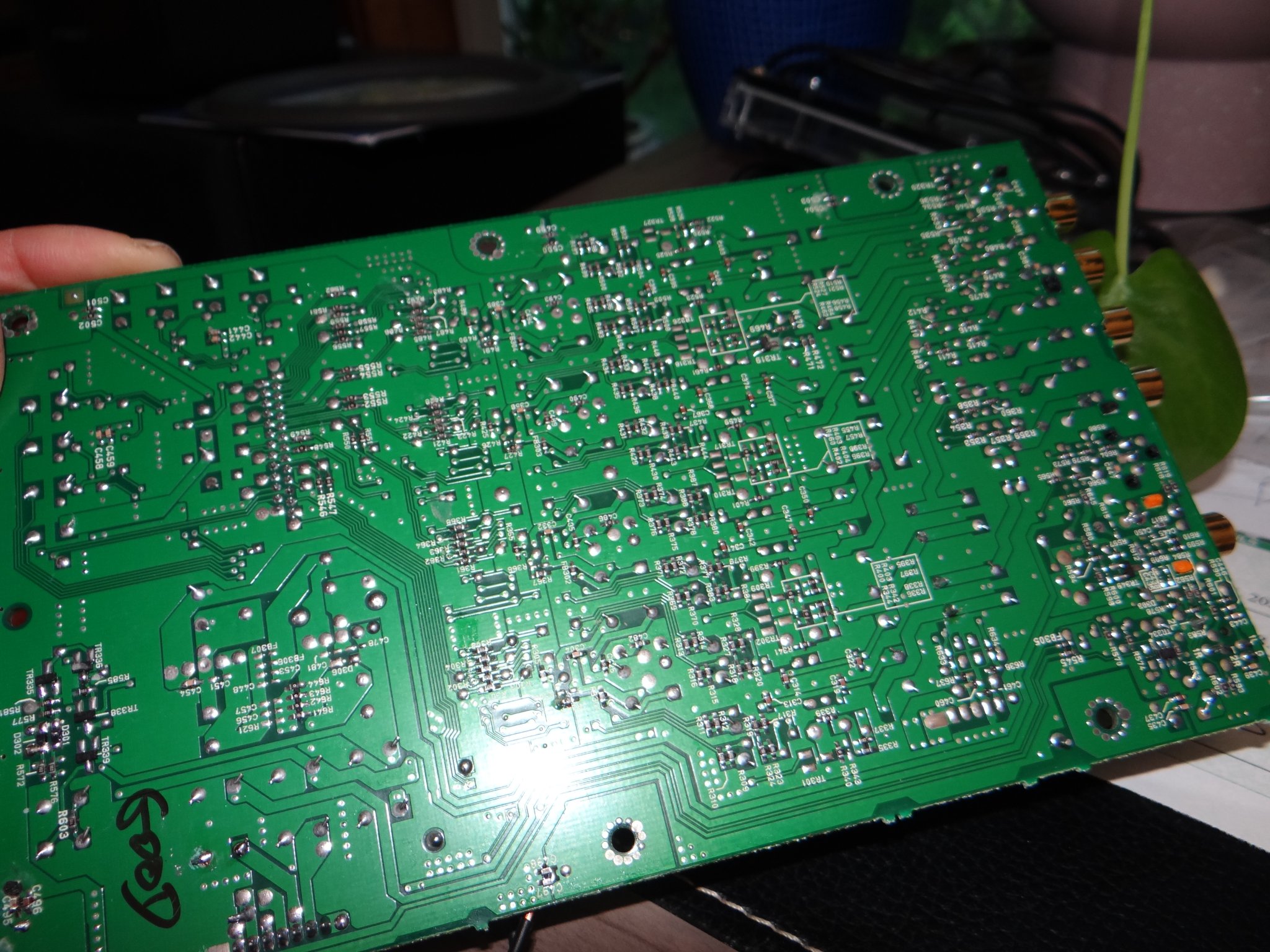

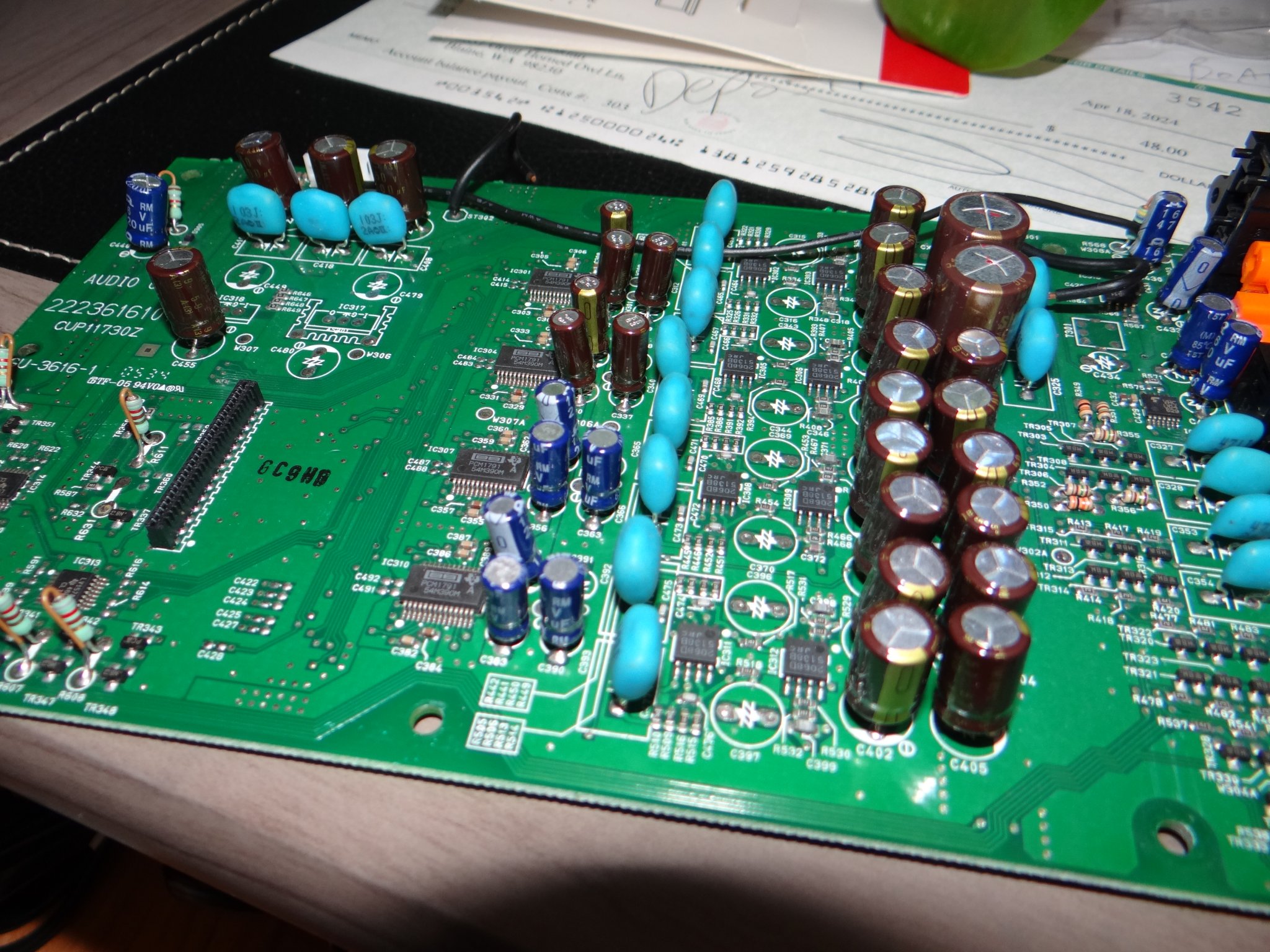

I have desoldered components off boards for about 4 years now however I am currently battling something I have never been able to do with my Hakko 808 or a soldering iron and that is desolder a component off a double sided board
I can get the solder off the opposite side of the component but the solder on the component solder is unaffected
I am trying to remove most of the through the hole caps
Is there a secret I dont know about and I hope it doesnt involve using a soldering iron and the hakko at the same time

Resolder and add more solder, so both sides are soldered, but not in excess.
Now try again. If the lead fills most of the hole, it is much more difficult.
If necessary, and if the lead on top is accessible, cut the component off and try again.
It should be easier with the lesser heat sinking due to the cut leads.

On a project that I just did, I found if I pressed the opening in the solder sucker against the leg of the component it transfered the heat through the hole and melted the solder on the other side of the board better. On mine, I didn't care about the components so I don't know if that would risk overheating your capacitors. I did the same couple second count that I do when soldering so it shouldn't be too bad heat wise.
An inexpensive hot air tool can be used as a 'helper' heat source. Adding the
heat near the component to be removed will get the heat all the way through
the board. This is especially useful with 4 layer boards. It's even more important
if the board has a ground plane with no thermal reliefs. Those are common on
computer motherboards. When I was doing this the board was not to be damaged
but the technique is good for preserving the parts.

I would probably straighten the ends of the leads with a solder iron and then set my hot air station to "flamethrower". Use a large nozzle to heat both leads/vias on the bottom of the board and then pull the out the cap. Might rip some plated through holes out, but who cares in this case.
Yeah, heat and wiggle while pulling the component away from the board, if only a little.
Repeat on the other lead. Then do both, again and again, until it's separated from the board.
At some point you'll probably pull out the via(s), but it doesn't matter.

I have bought many hundreds of caps the past few years but the audio caps on this board are not made anymore and I would love to get them off the boa4d

How about using a low temperature solder, as for instance BI57SN42AG107/025
It can be applied on both sides of the pcb, as the solder will stay fluid for quite a while.
With a board upside down, usually the component will fall off easily no matter the layers.

well I was able to get almost all of the caps I wanted. I did what you shouldn't really do and that is keep the desoldering gun on the pad for about 5-10 seconds (I have removed many hundreds of components before but usually go no more than 2 seconds with the desolder gun). ordinarily you risk damaging the pad and or the cap but I had to try it. that removed most, some needed a soldering iron on the component side ti get them off, some never came off and maybe I will cut the board up if I feel like the total destruction approach
one cap I damaged the lead and tossed it. the rest all tested OK on the cap tester
