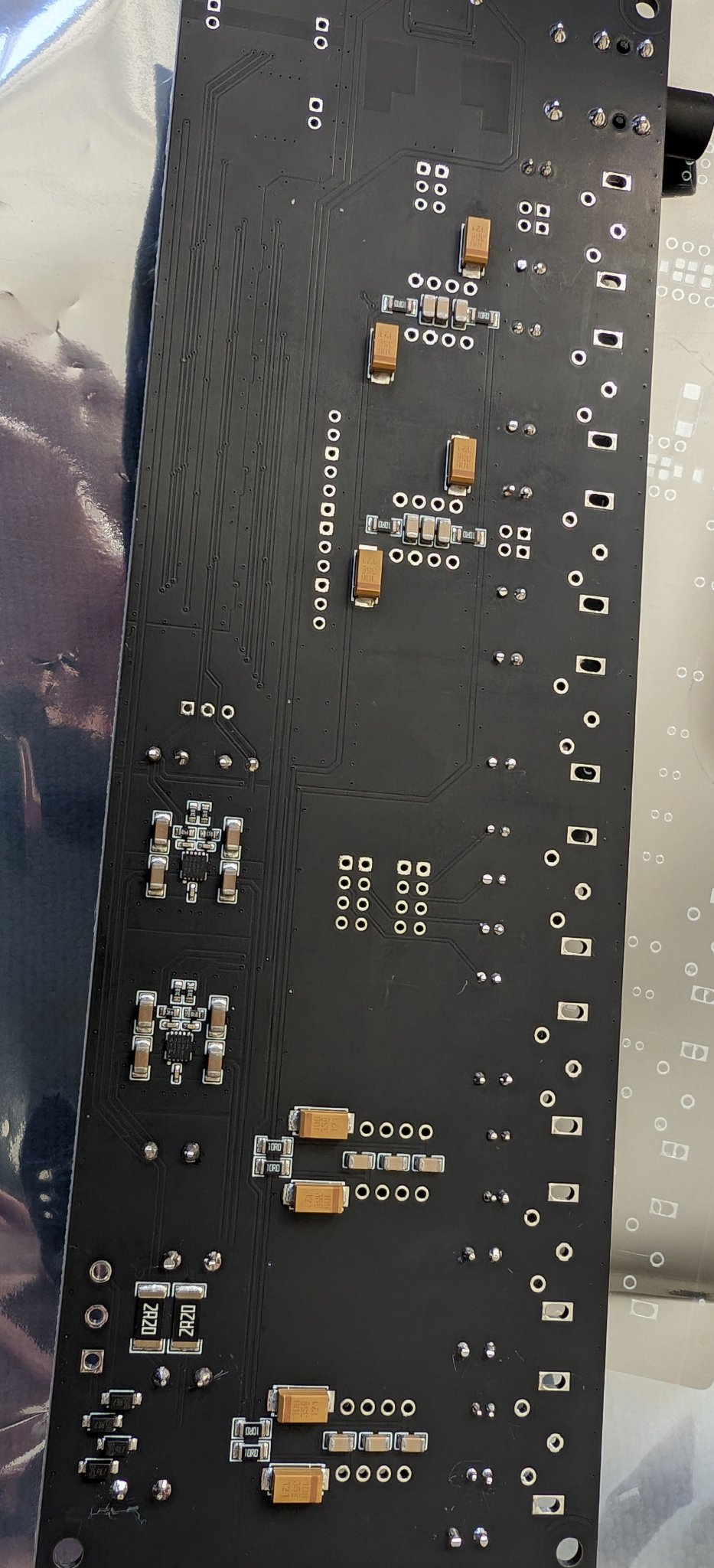

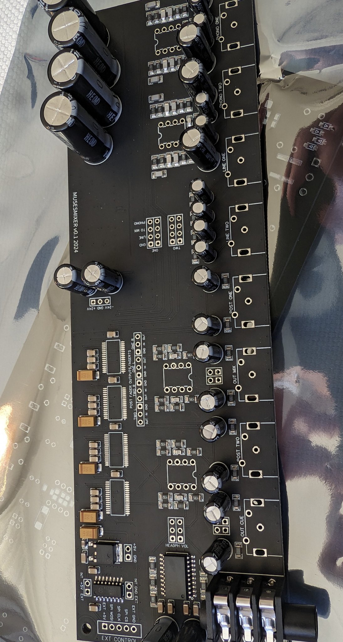

Beautiful boards! It looks very professional with the copper pours.
Thanks, looking good and being the best way is not always the same thing though 😱😅 But sometimes it is 🤷‍♂️ There are a few "keep out" areas for the ground pours on both sides.
Grounding strategies in theory and what is practically possible in some given scenario is also not the same. I wanted to limit the board to two layers which meant neither side would be a proper ground plane, but rather very very far from it. But I did spend thought on how the ground runs through the large pour areas on the top and bottom sides and work together. And it is actually a star ground"ish" layout 😁
Would love positive and negative feedback on my choices but I doubt anyone wants to dig through gerbers or CAD files 🤪
Ps:
If anyone wants a bare board (which I doubt though 😅) for free, PM me👍
Reactions: 1 user

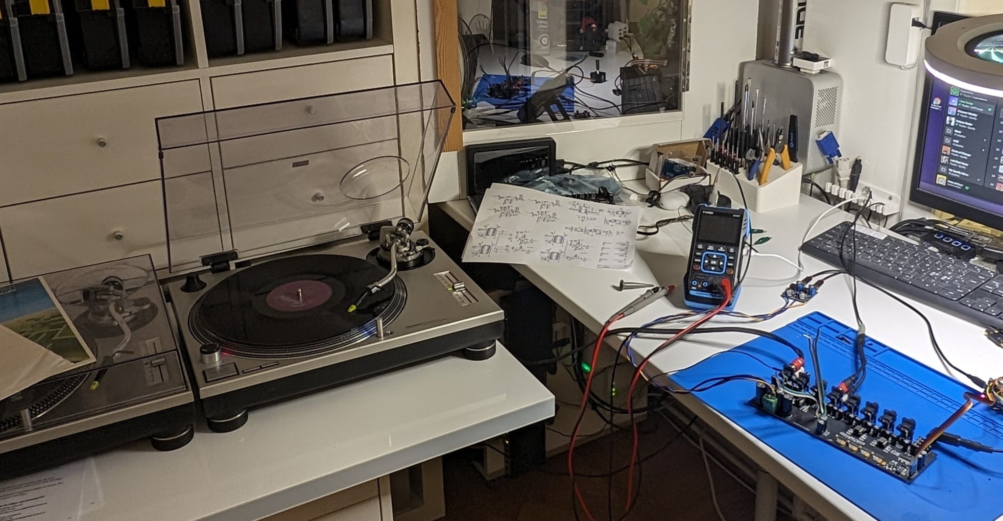

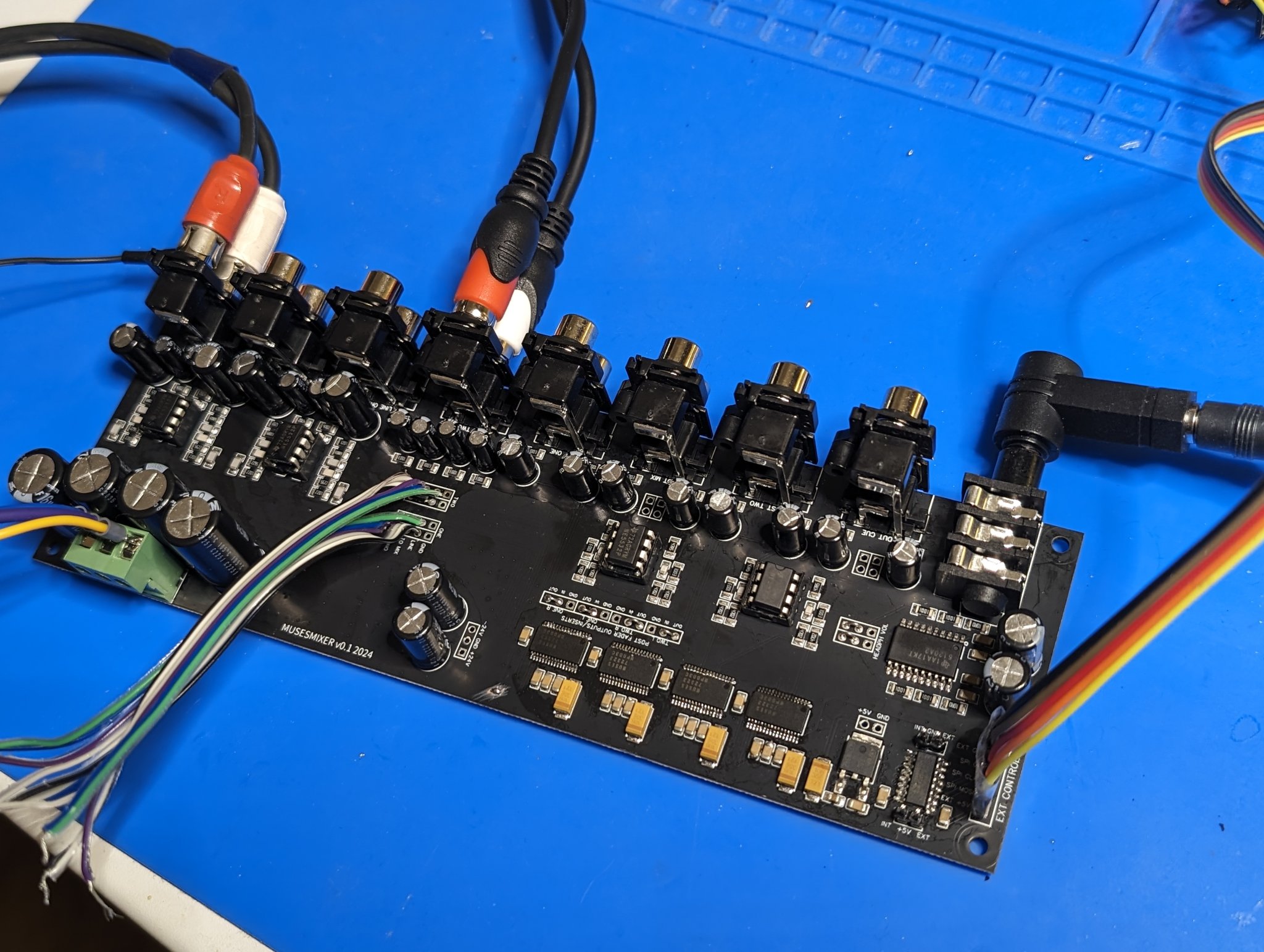

Damn... this is nice. Running the boards headphone amp into my Denon AH-D5000. Sounds very very good so far! Currently plugged in four NE5532 for RIAA and mixing circuits. 4-5mV offset error from the RIAA running through the MUSES72323 seems to be no problem.
Reactions: 1 users
