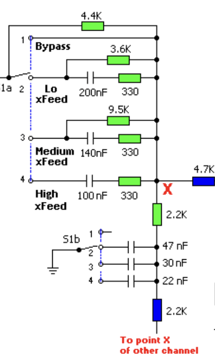

I started a little adventure: I‘ll try to make a little crossfeed „network“ according to Jan Meiers proposition… as this is a rather simple thing, I thought this could be ideal to try myself in smd.
But I‘m very unsure about what capacitors to use there? I mean, it’s caps in the very signal-path, which smd-caps are good/best to use <duck>soundwise</duck>

I got two of them, here's is the simple one and the other one (which is part of a whole HA..., here
I wonder if you conclude something other than pinholer's tip after reviewing the scm. :cool:
Try Panasonic ECHU( ECPU ) or Cornell Dubilier FCA series.
COGs normally go up to 220nF at a normal price, there are also higher values but that is unnecessary for this application .

Woops, I stand corrected...in my mind even pursuing values larger than 1nF was a no-no...but based mostly on price and suitability.
Myleftear, this application is pretty straight forward to build, and doesn't really need precision components, 5% - 10% tolerance in a decent quality cap will give good results.

For that value range G0G/NP0 will be problematic, the largest values available generally no larger than 1nF.
I have no trouble finding 1206 or 1210-sized ones rated for 50V or above up to 220 nF in stock at Mouser. They're not even super expensive. About $0.50/each at QTY 10.
C0G/NP0 tends to outperform film capacitors. Just make sure that you use physically large capacitors (1206 or larger preferred) rated for higher voltages (50+ V).

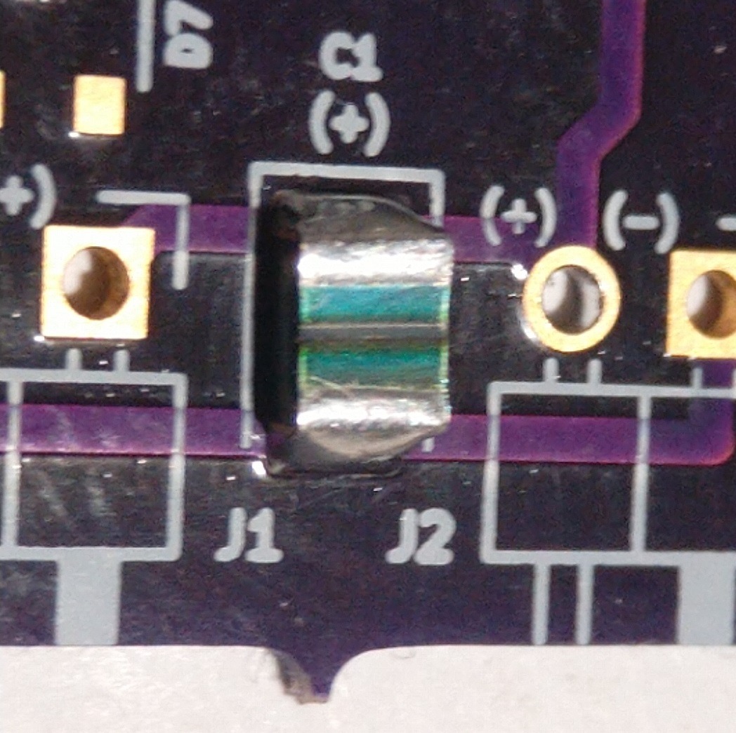

You've checked capacitance? They are EXTREMELY sensitive to direct heat. Best used with proper factory datasheet soldering procedure. For home made use and soldering, rubycon mu are hard to wreck. Easy 400C direct heat with no issues.
Edit: those on the picture look like acrylic (probably ecpu ones, same dielectric on rubycon mu, simmilar manufacturing), not pps. They handle a bit more heat than pps, but are still marked as reflow only in datasheet.
I seriously doubth you've left them unscathed in one manner or the other. Many people have had issues with much more experience (aya dacs with dem damaged caps what comes to mind). Even for some miracle they are virtually unharmed, recommending pps film cap to a novice in smd soldering is a recipe for disaster.
