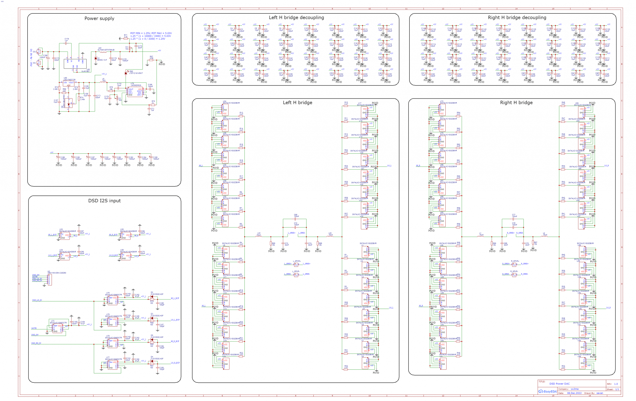

Hello,
as I promissed just to share with you concept from YU3MA forum, this is pulse densinity modulated H bridge power dac driven by dsd64, in short it's an full bridge class D direct digital power amplifier pulse densinity modulated, contain no opamps... etc just directly flow DSD bits to the full bridge, more comparable to an water flow boiler with diference boiler flow hot water but this one flow dsd bits. : ) Tested up to dsd256, it might work on dsd512 too? Concept contain variable power supply as a volume control, 1.25V to 5V range. You need Amanero usb combo and you need DSD tracks in order to play sound trought this dac. You will be surprised by the huge dynamics and holographic unchanged and detailed sound! The power of this dev concept is in the range of 3 to 5 watts and I do not recommend more, you simply need to first adjust the current with CC pot by shorting +5V at the one of the 8 capacitors for example C165 to gnd with an ameter until your ameter display value close to 1A, than you are ready for sound testing. Here is soome pictures and videos and more details about further concept . Its fully diferential! Optimised for 8 ohm speakers! Not measured but I have bought Cosmos ADC and when I finish some concepts and when I get ready for measurement I will do it, hope somebody do it allready. Gerber, bom and schematic is in atachment. Please pay atention to R72 resistor, change it for 2mA, ohm law yuor input dc voltage and calculate resistor value for 2mA! Enjoy!

Yes sure! Important is that dsd need to be on input, I recommend dsd64 up to dsd256, I'm on dsd64 and I believing thats optimal because of switching frequency inside H bridge is allready huge with dsd64. Its important to have booth mute and DSD_ON otherwise you will get pops and clicks and also you might kill something on pcb without it, so I recommend Amanero combo since it allready have all that functions! This is just development version, further concepts is more complicated, ganFet based. But even dev version produce huge sound, I was shocked on first note with huge sound and power delivered from just 3-5 watts :)
It can be comparable to a flow water heater boiler, water flows through the flow water heater boiler, and dsd bitstream flows here :D
We are trying to design post LC filter digital feedback, thats not an easy task right now but my hope somebody from this great forum give here some great idea! Migh be DDPD used for something other, for example an SDR transmiter? :)

Hi yes, here is. One great thing which maybe I didn't menrioned here is: DSD is not getting atenuation when we have volume control at power supply level! That giving us full resolution without resolution lost while on low level volume! Thats a special feature here and realy great feature! This full bridge power dac is amazing, sadly still nobody built it, you must hear it!!! The only thing for check is dead time adjustement which I am curently unable to fine tune because I don't have right equipment for that, need to be speacial care done to RC delay near D2, D3, D4, D5 and eventualy fine tuned post bridge LC filter, we have simulated and added optimal filter but it deserve fine tuning too! Even without any modification to this circuit sound is amazing!

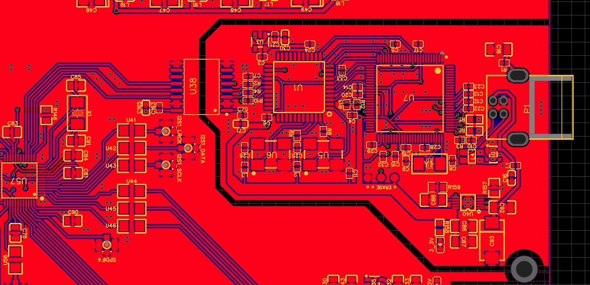

I have made my own Amanero, isolated, LT3042 reg, the best input source for my equipment is trought usb definitelly, isolator should be between mcu and cpld next time, and now investigating CT7601 inside DDPD frontend now isolated with isousb211 480Mbps, made mistaqe with isousb111 which is max dsd256 and now need new pcb : ( Thats why measurements on ddpd will be late
