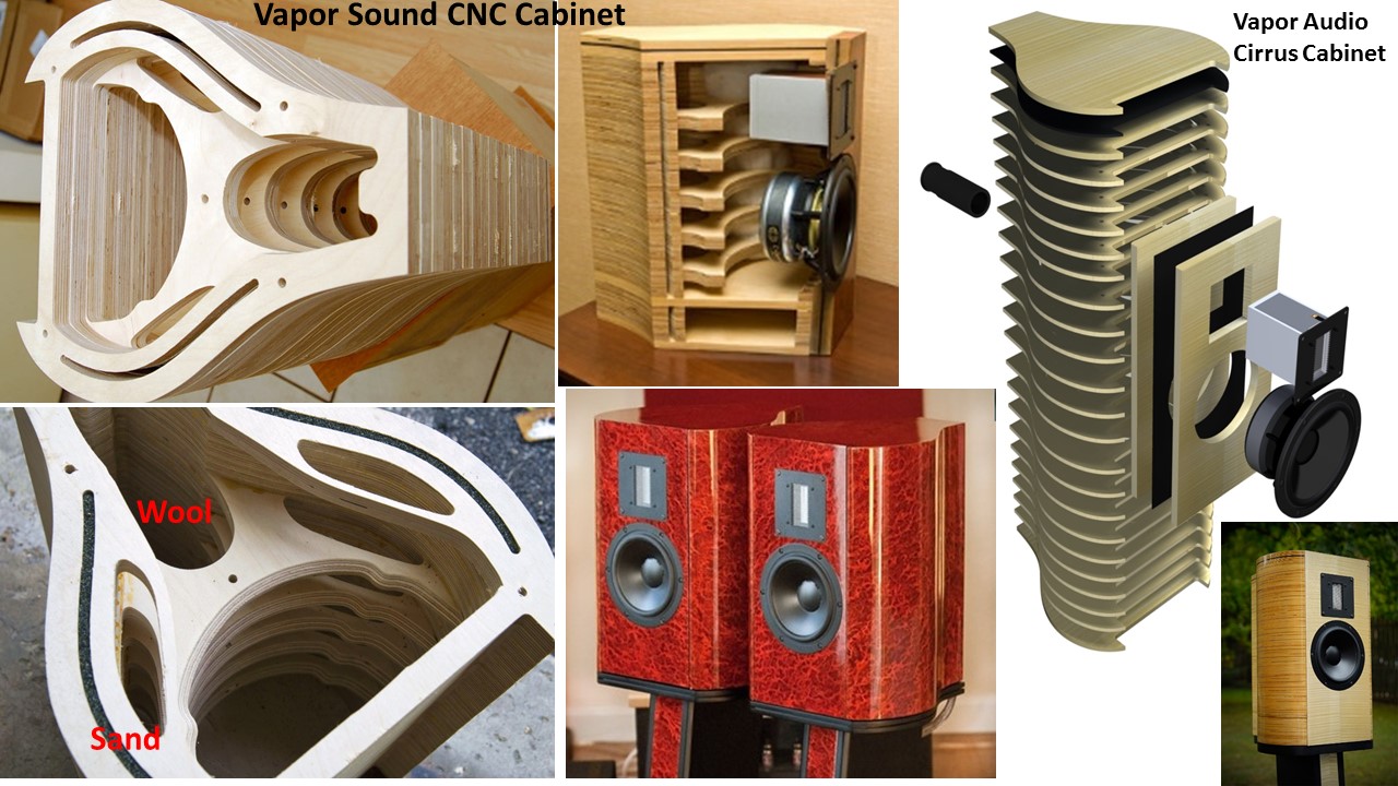

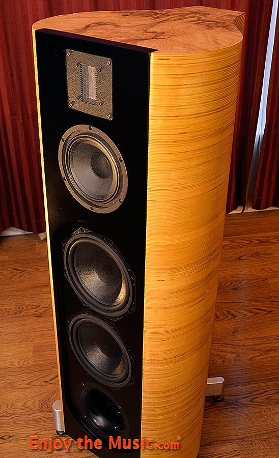

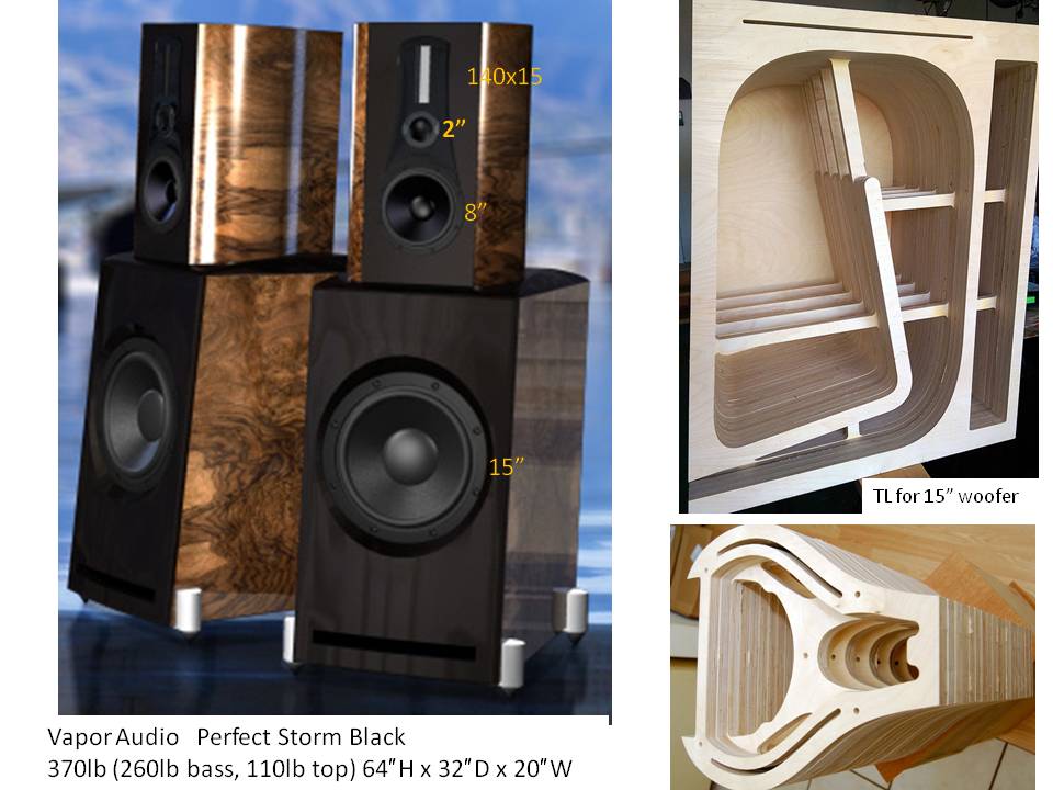

Vapor Audio design engineers strive to get the maximum advantages from the translam construction technology. Vapor audio uses advanced translam profile layers which reduce edge diffraction; support 3D cross-bracing; create tapered rear volumes to reduce resonances and hold wool for rear wave absorption; and hold sand for vibration reduction. Give some consideration to cloning one of their designs.
thats exactly what i was thinking about, the D3 has a tapered shape as well so its fitting. translam returns much better google results than "slice by slice method" :D
But yeah, I need create an interior dimension for my cad file and learn how to slice it into equally large parts
