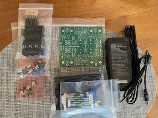

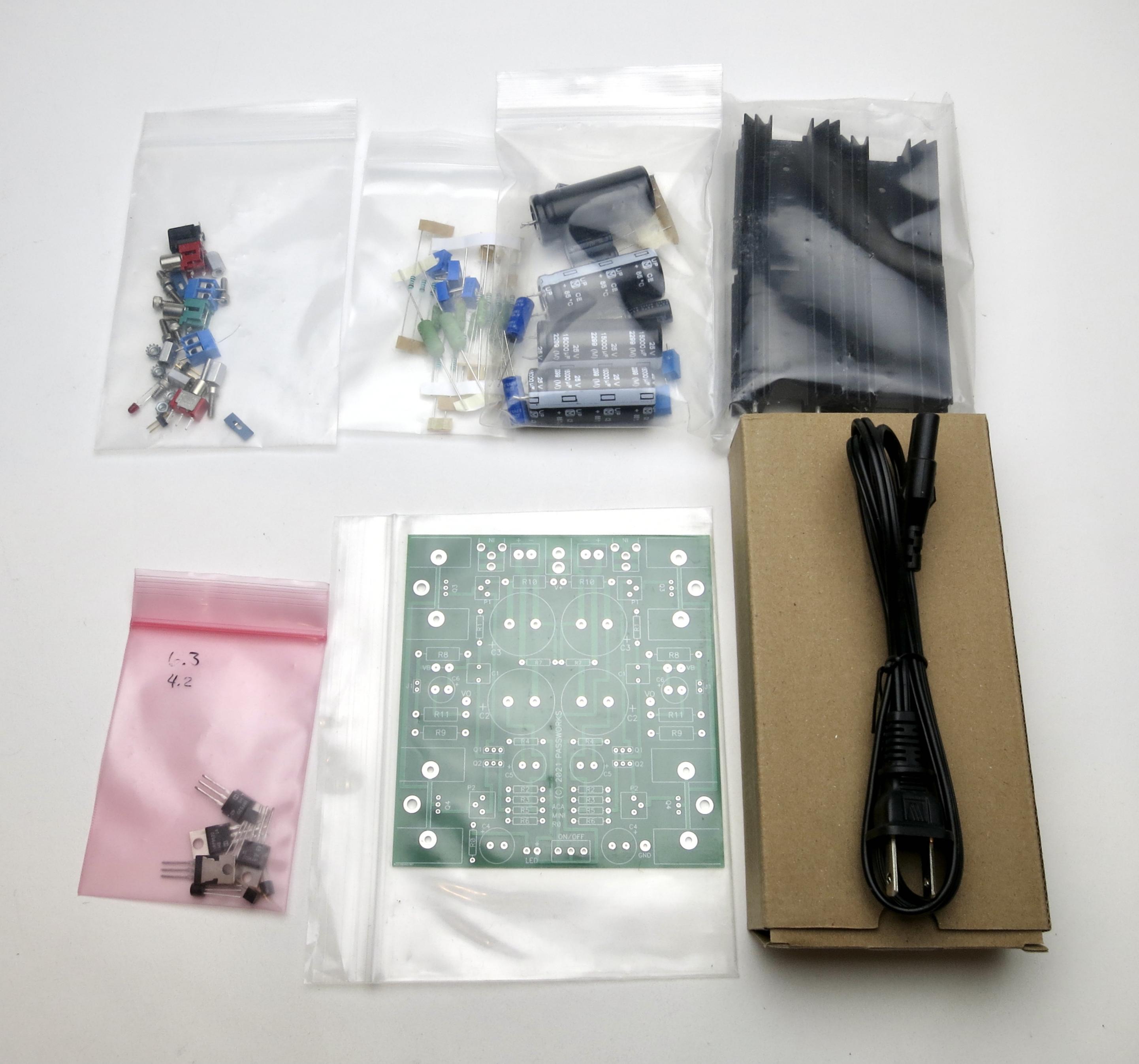

Some assembly required!

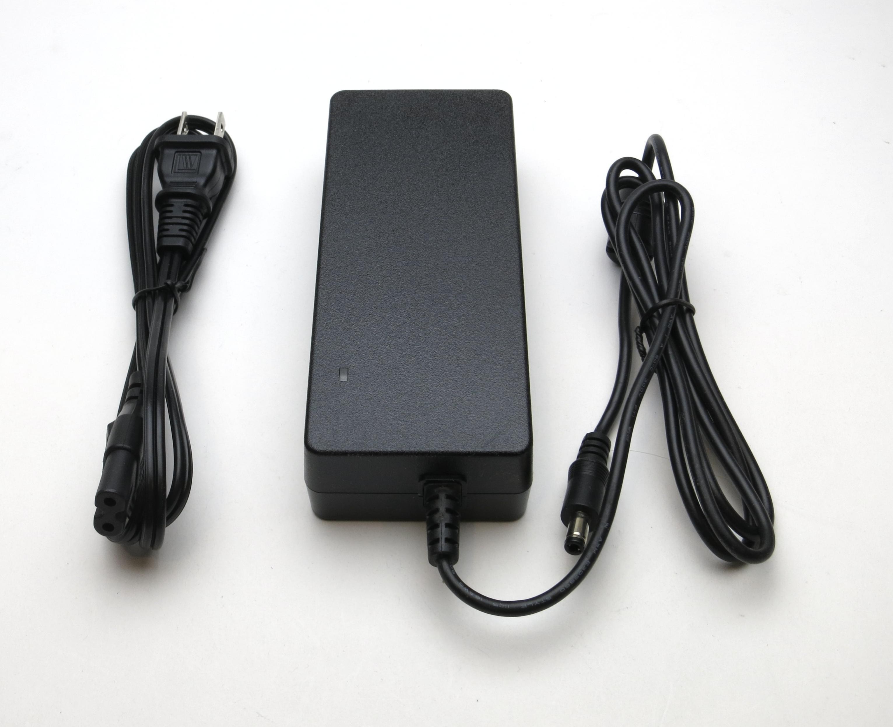

Woah, they even threw in the switching supply. That's a pretty great prize!!

Received mine today, will work on it with pep, vim, and verve as I have a very full schedule for about 2 weeks starting this Sunday...
Thanks 6L6!

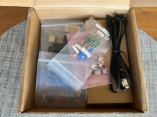

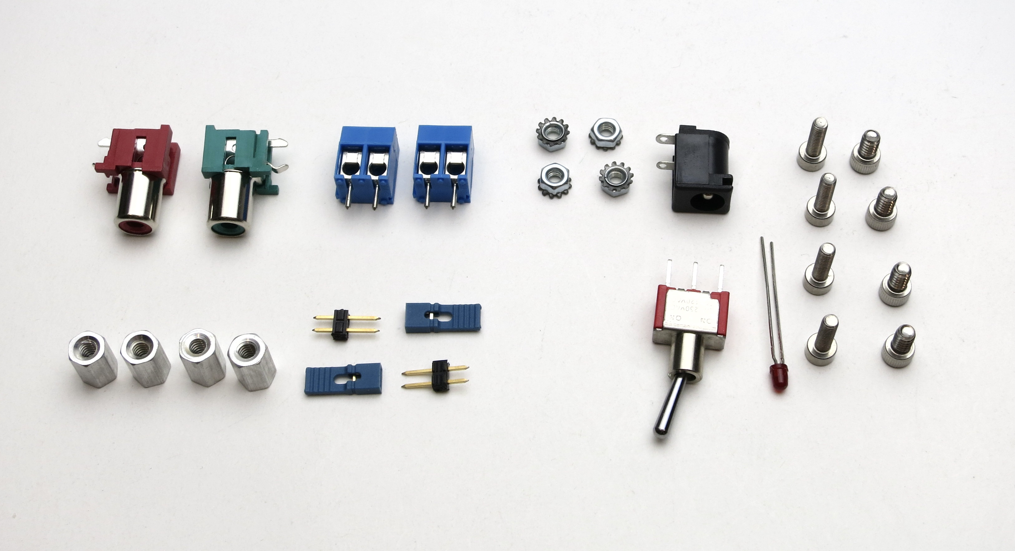

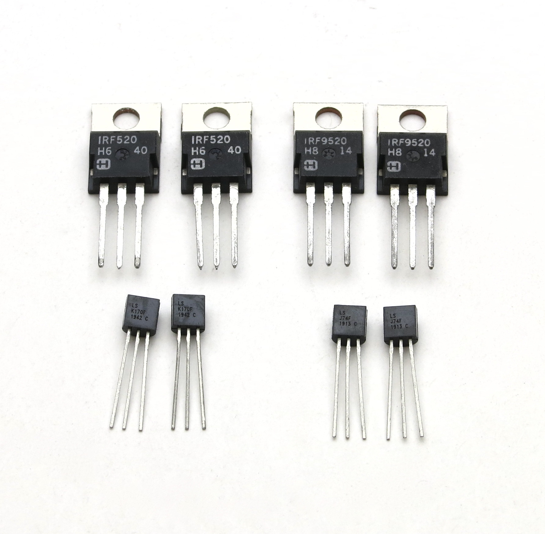

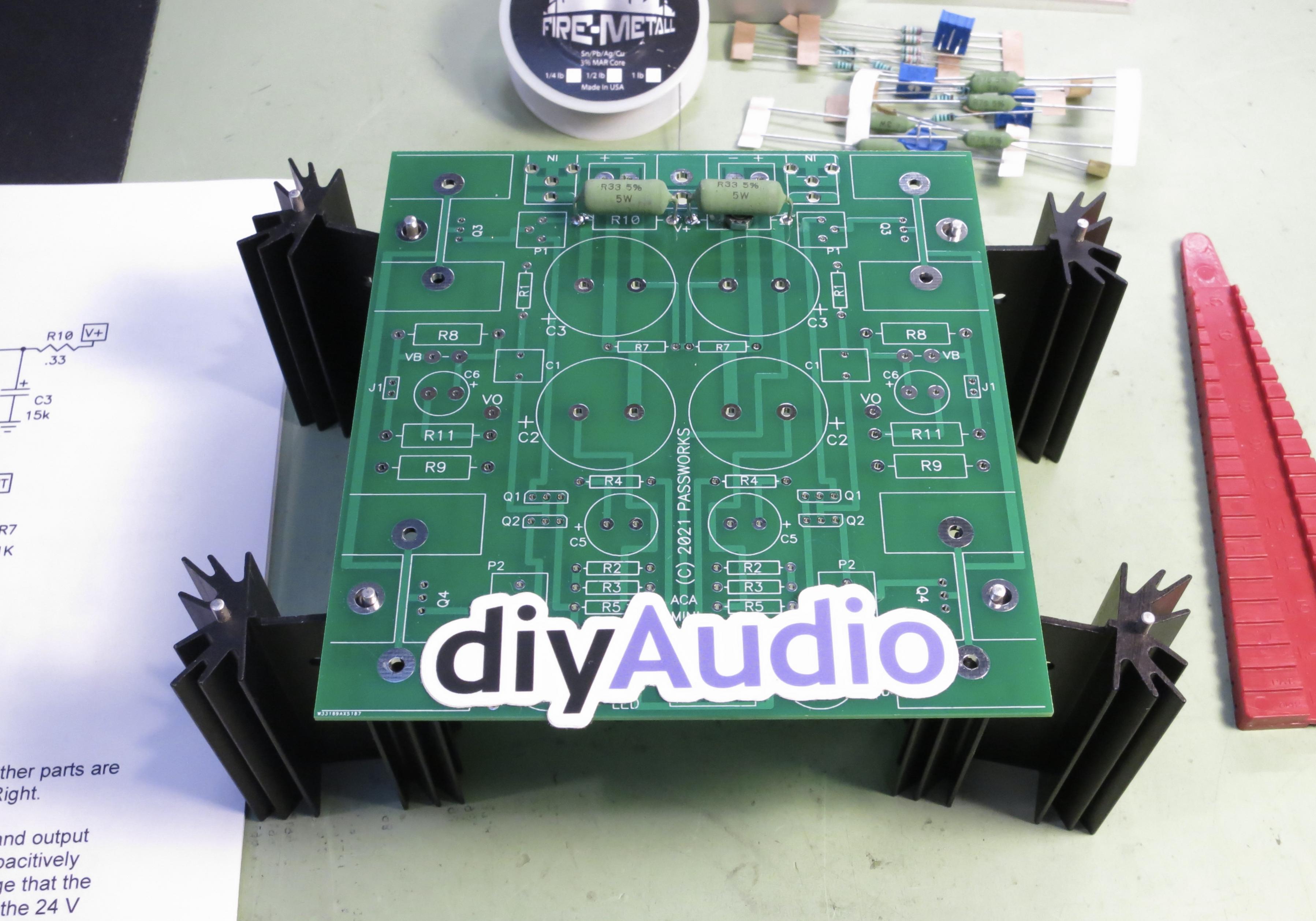

Photos 1

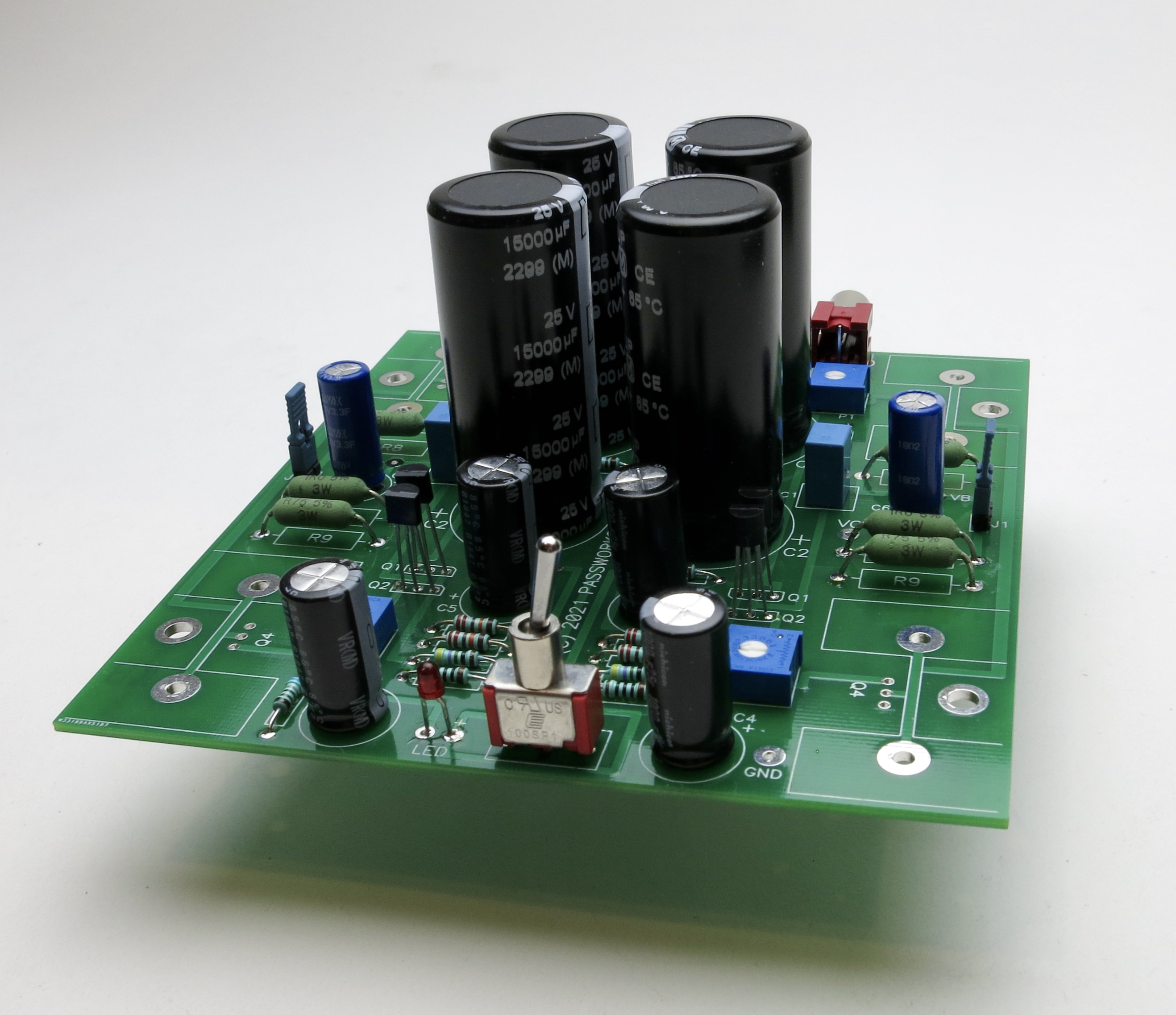

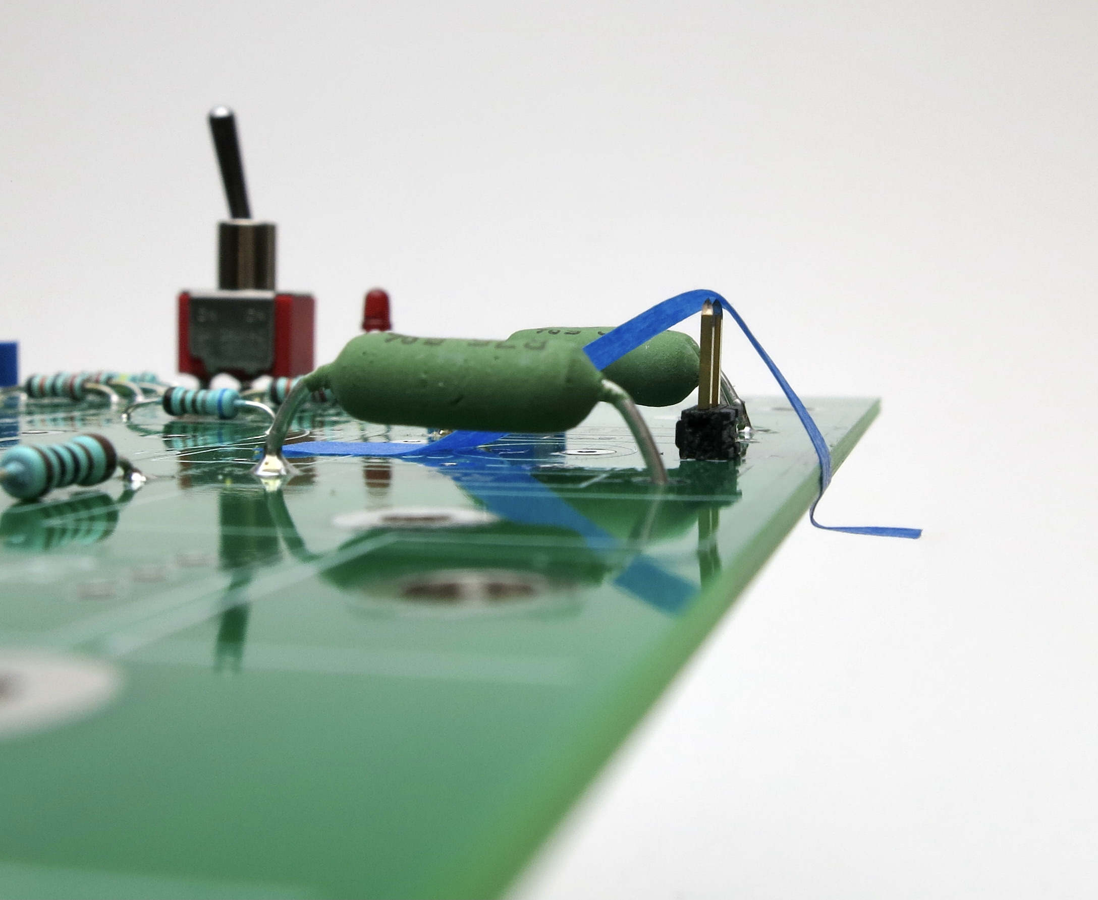

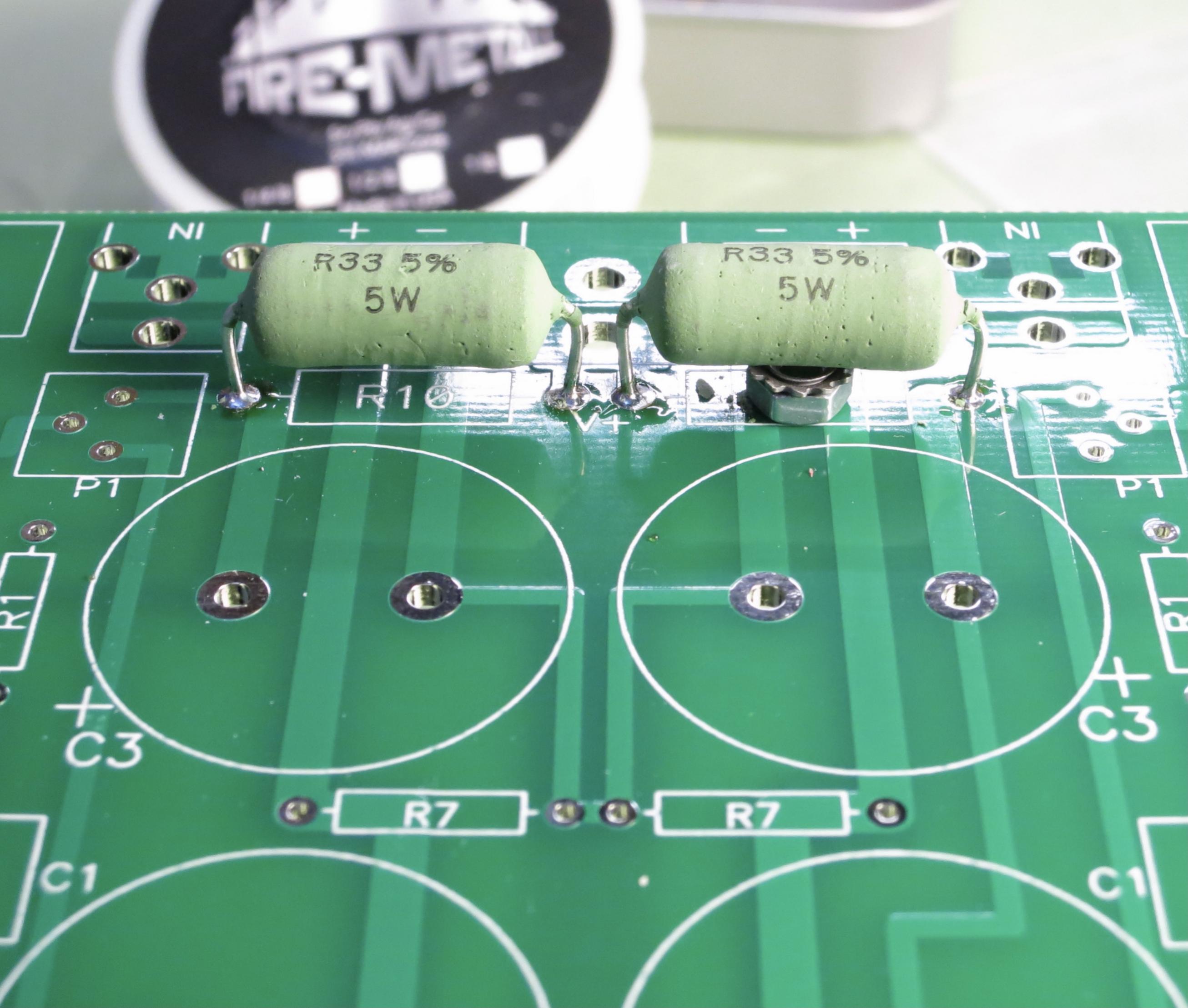

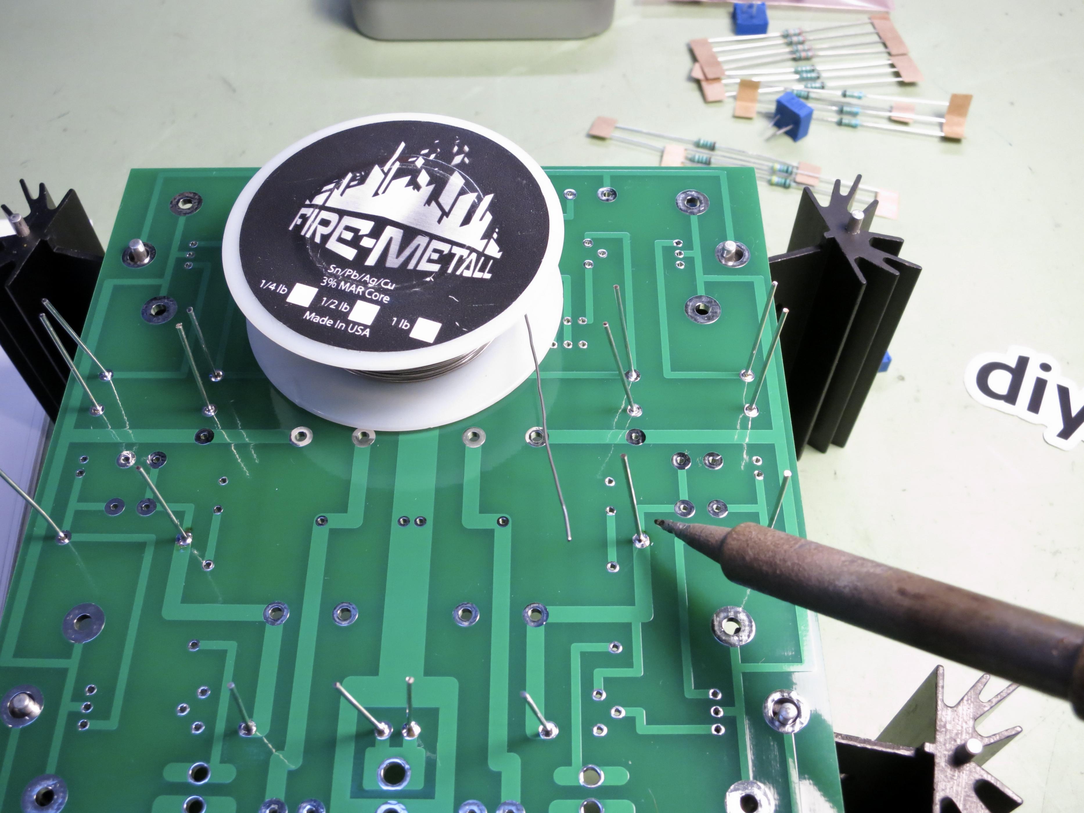

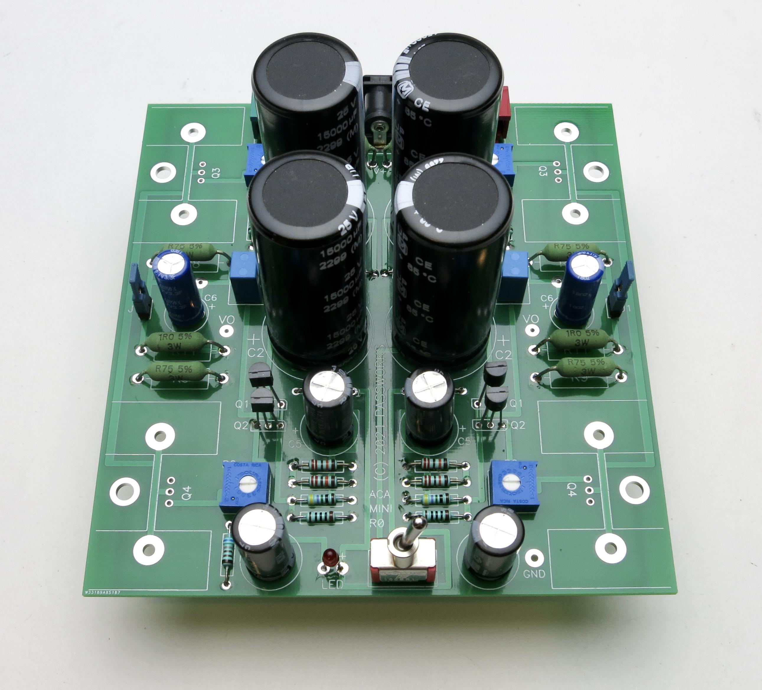

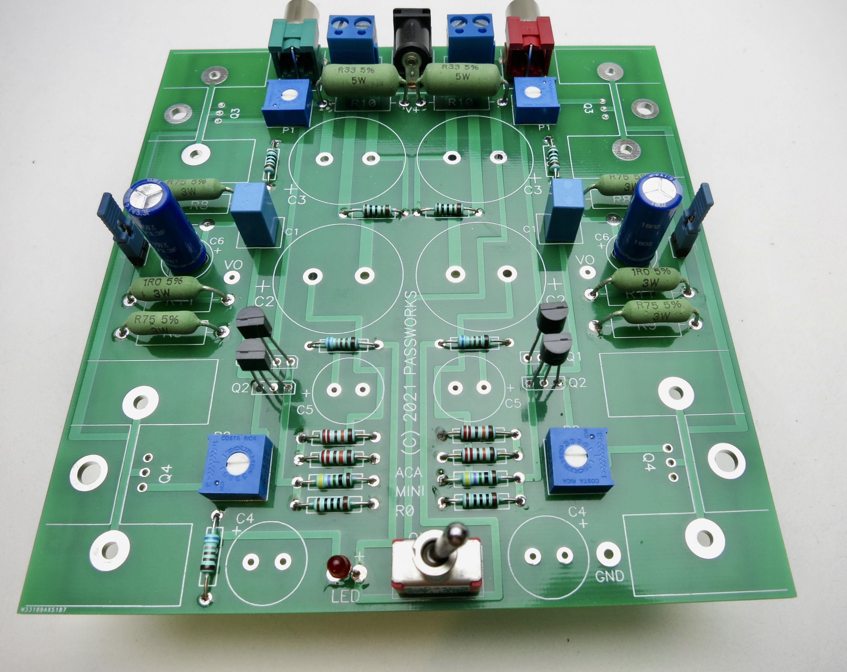

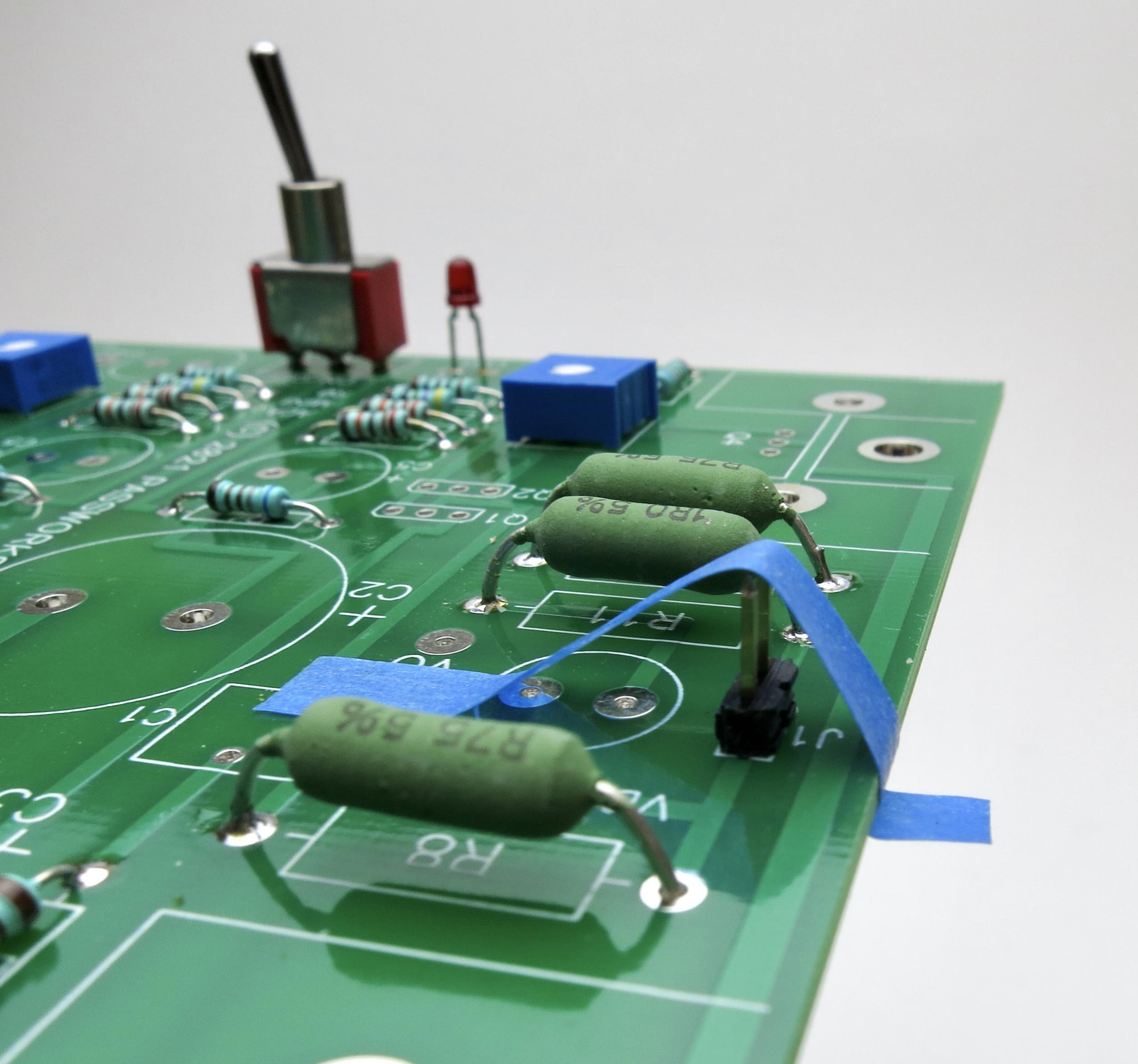

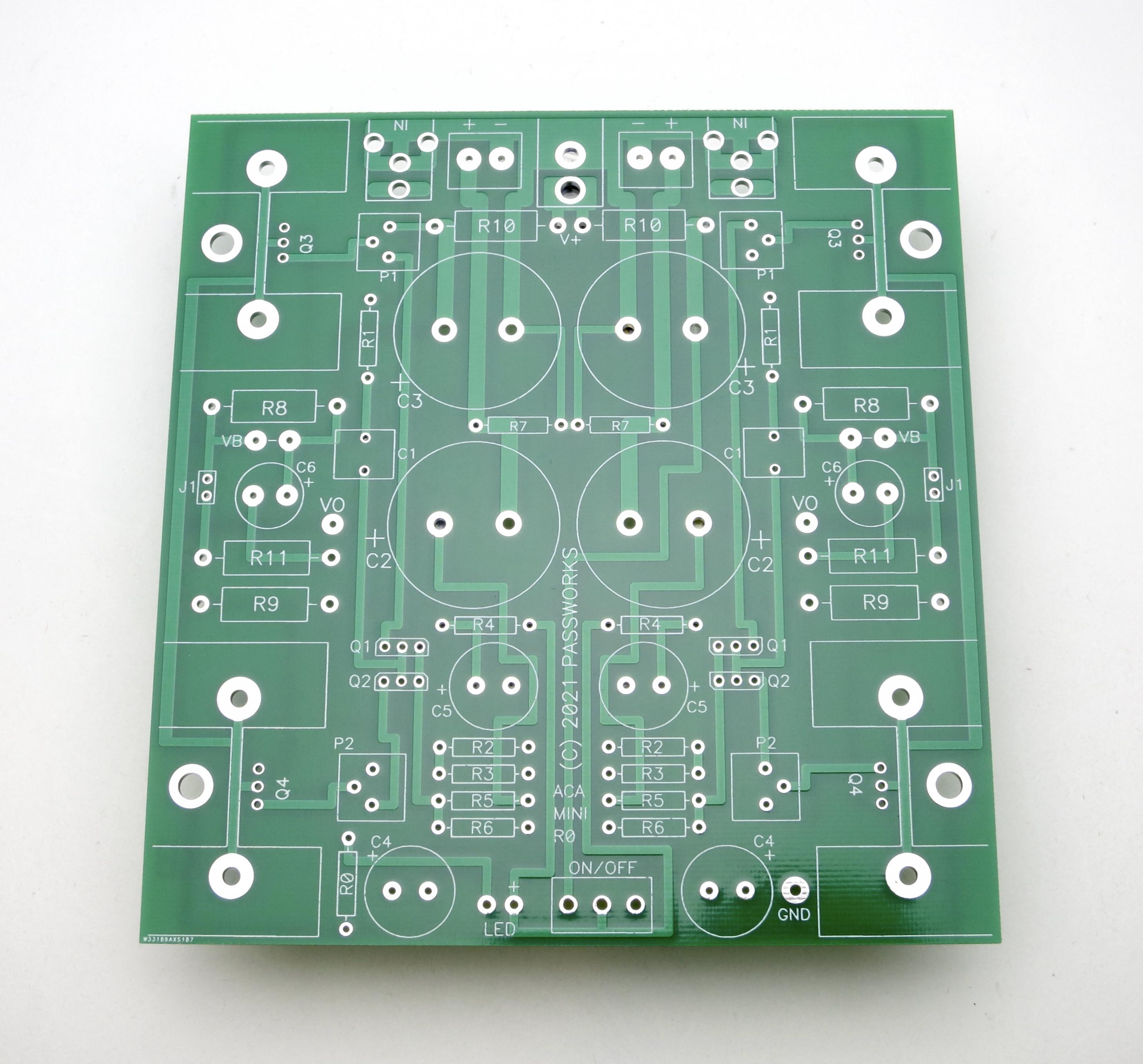

It really is easy, this is a remarkably simple project, lots of people are going to LOVE it, as initial testing has it working very well and sounding fantastic.
The biggest advice I can give at this point is -

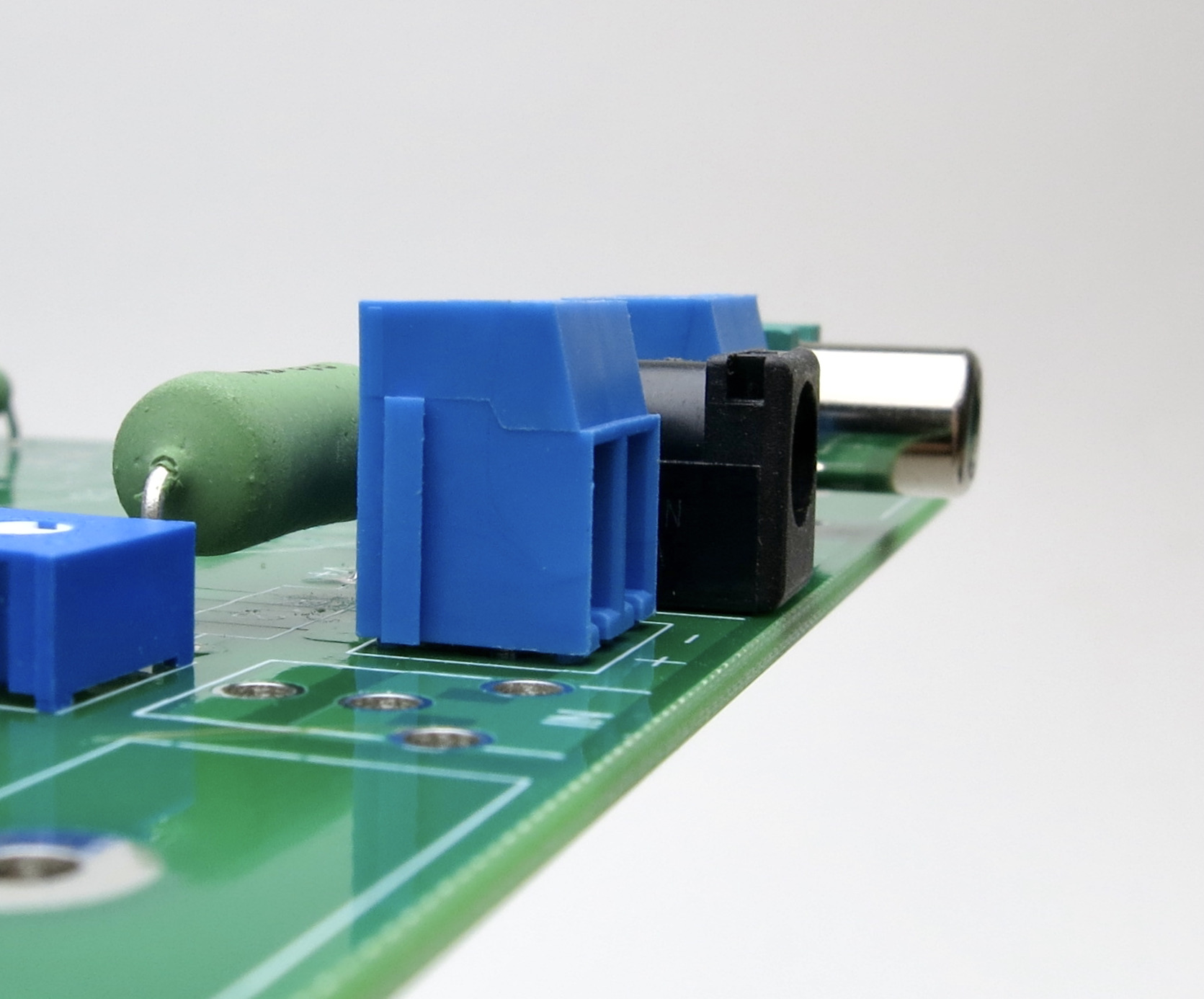

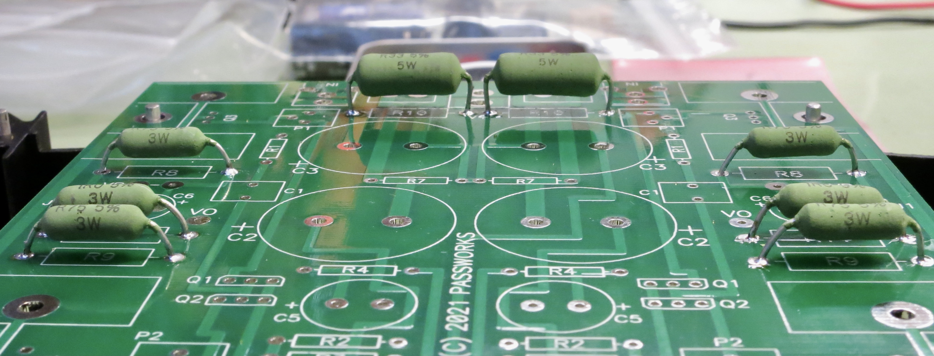

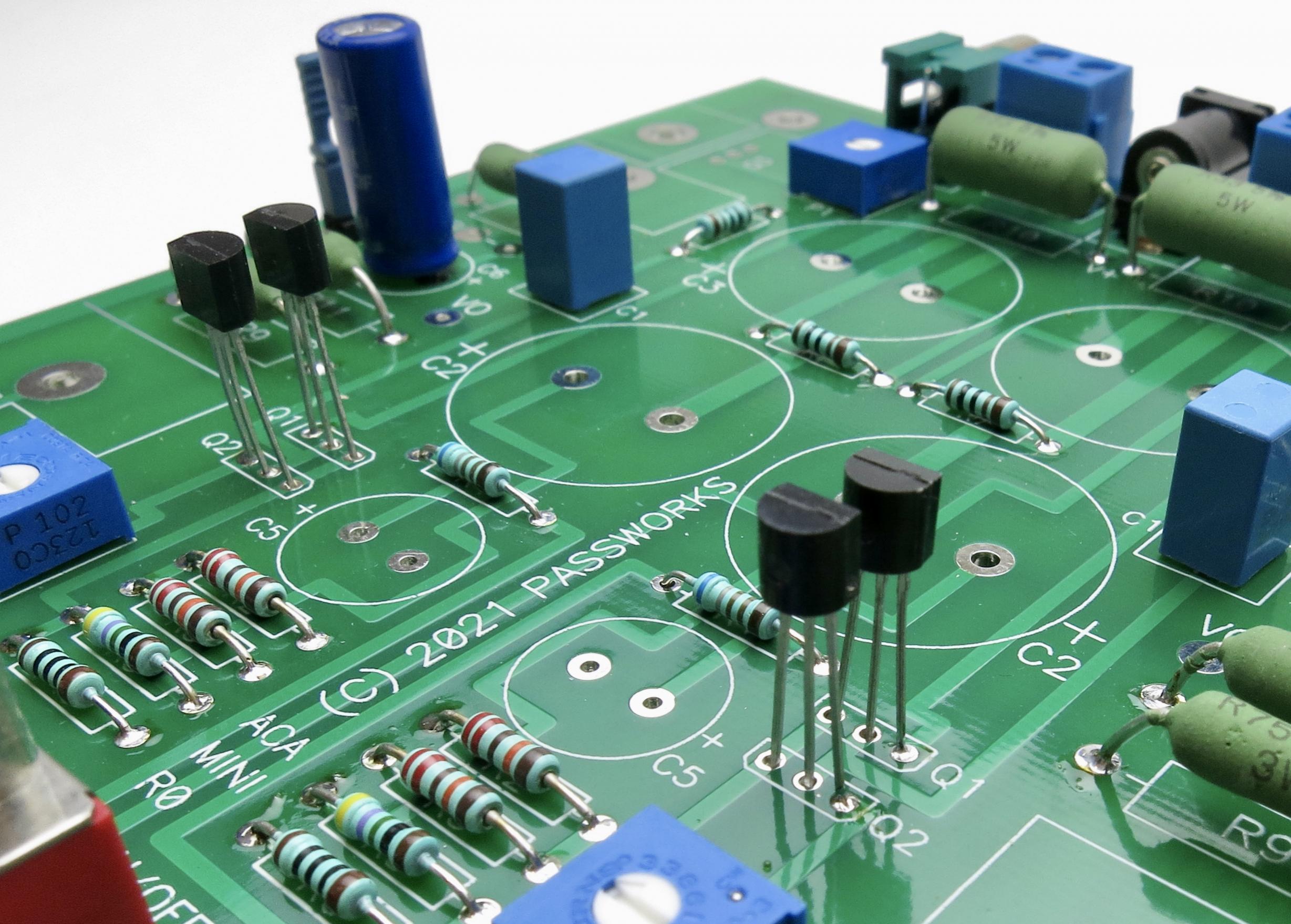

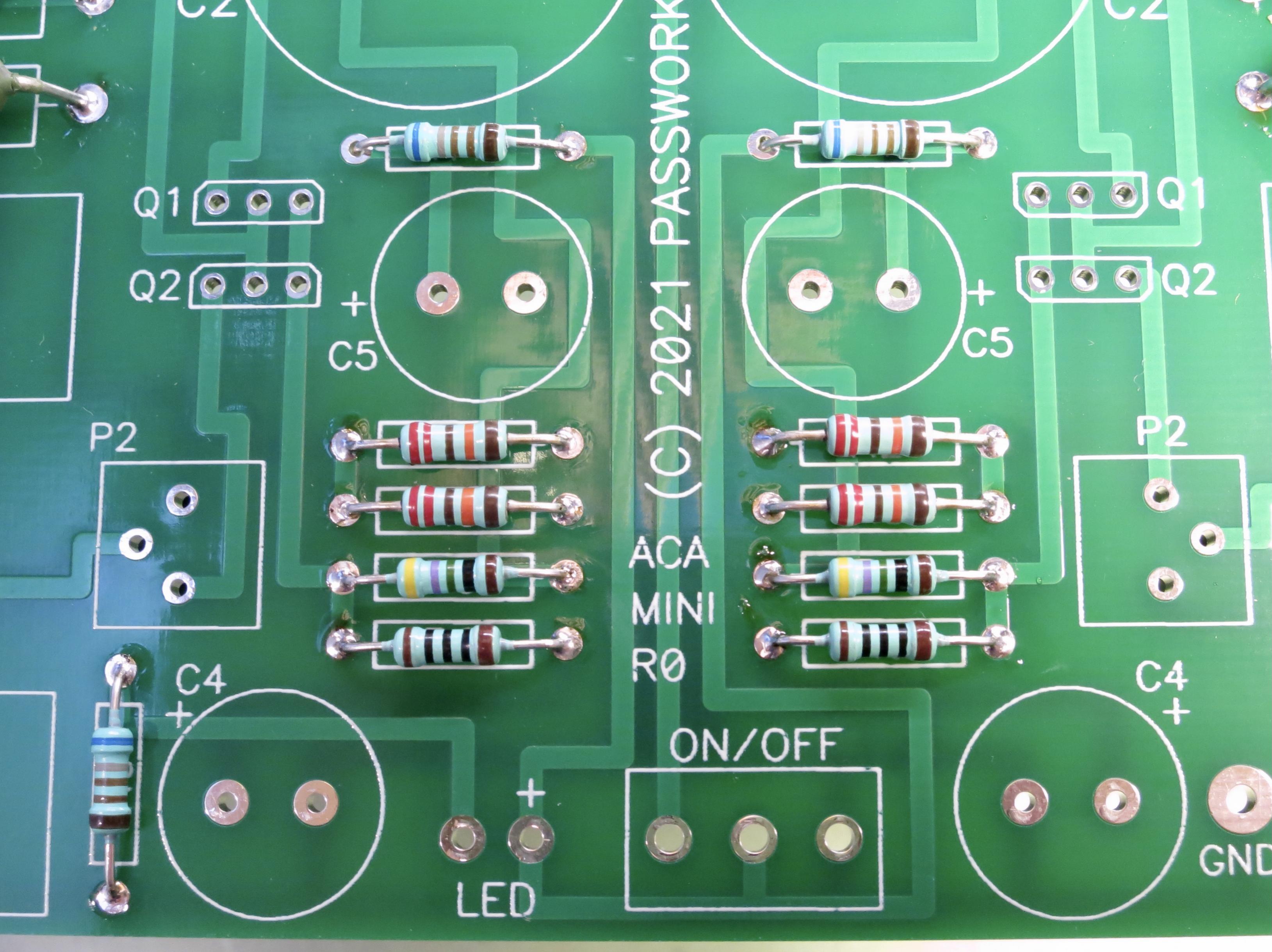

1) Because of the large disparity in sizes of all the various components, combined with the largest things being at the outside and the center, the old adage of "stuff components from smallest to largest" is THE most important thing to remember and abide by.

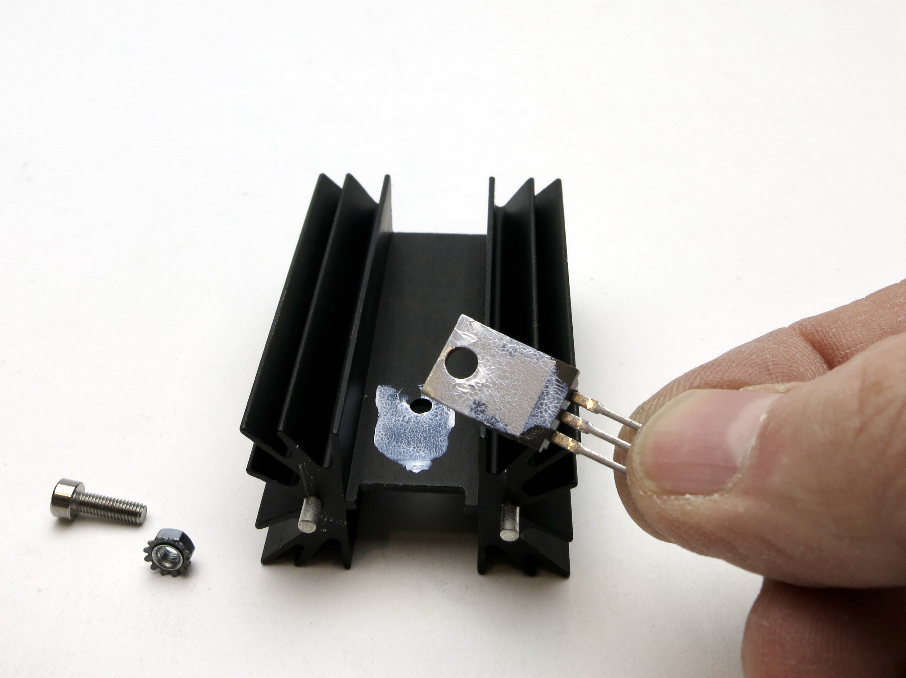

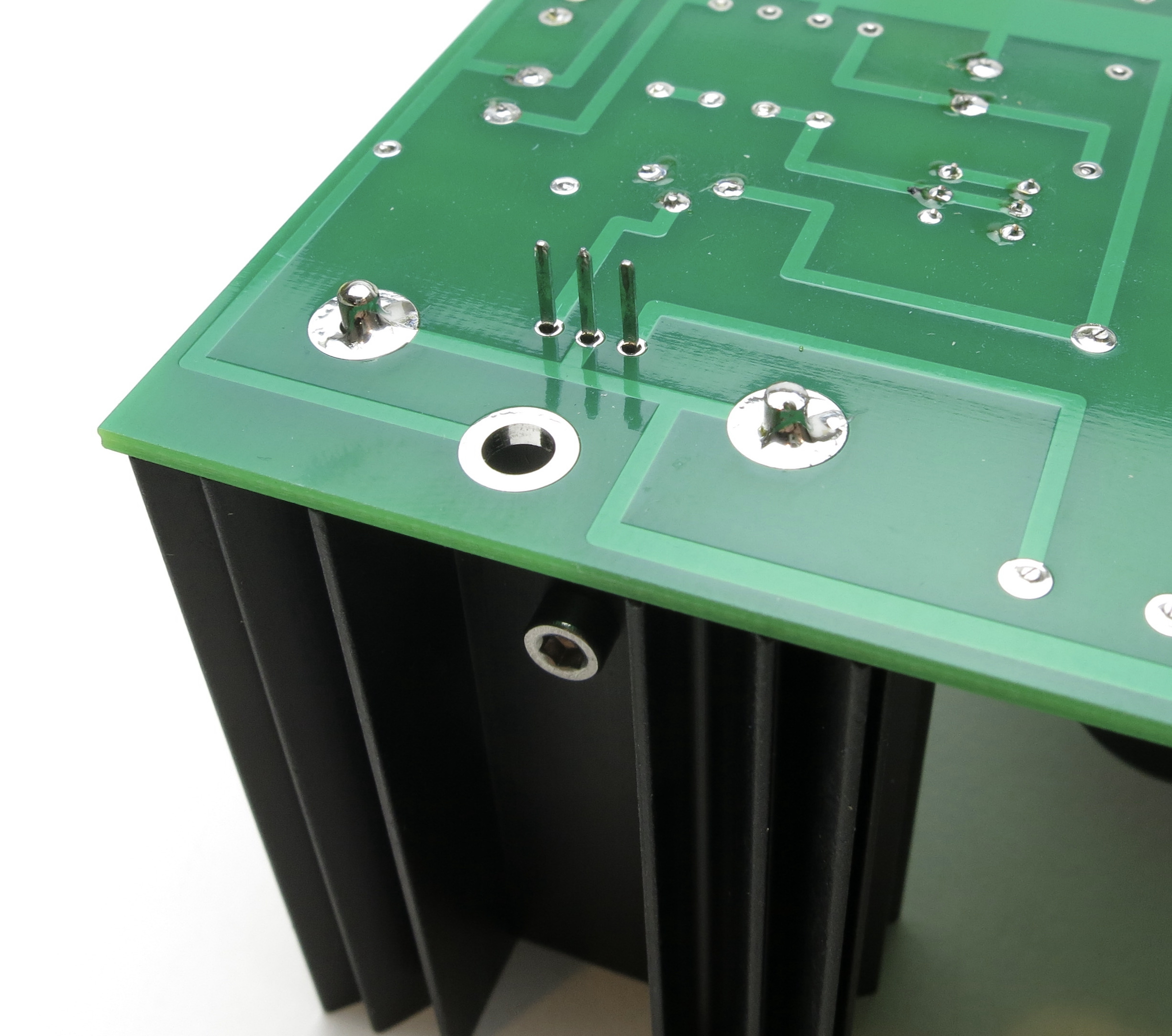

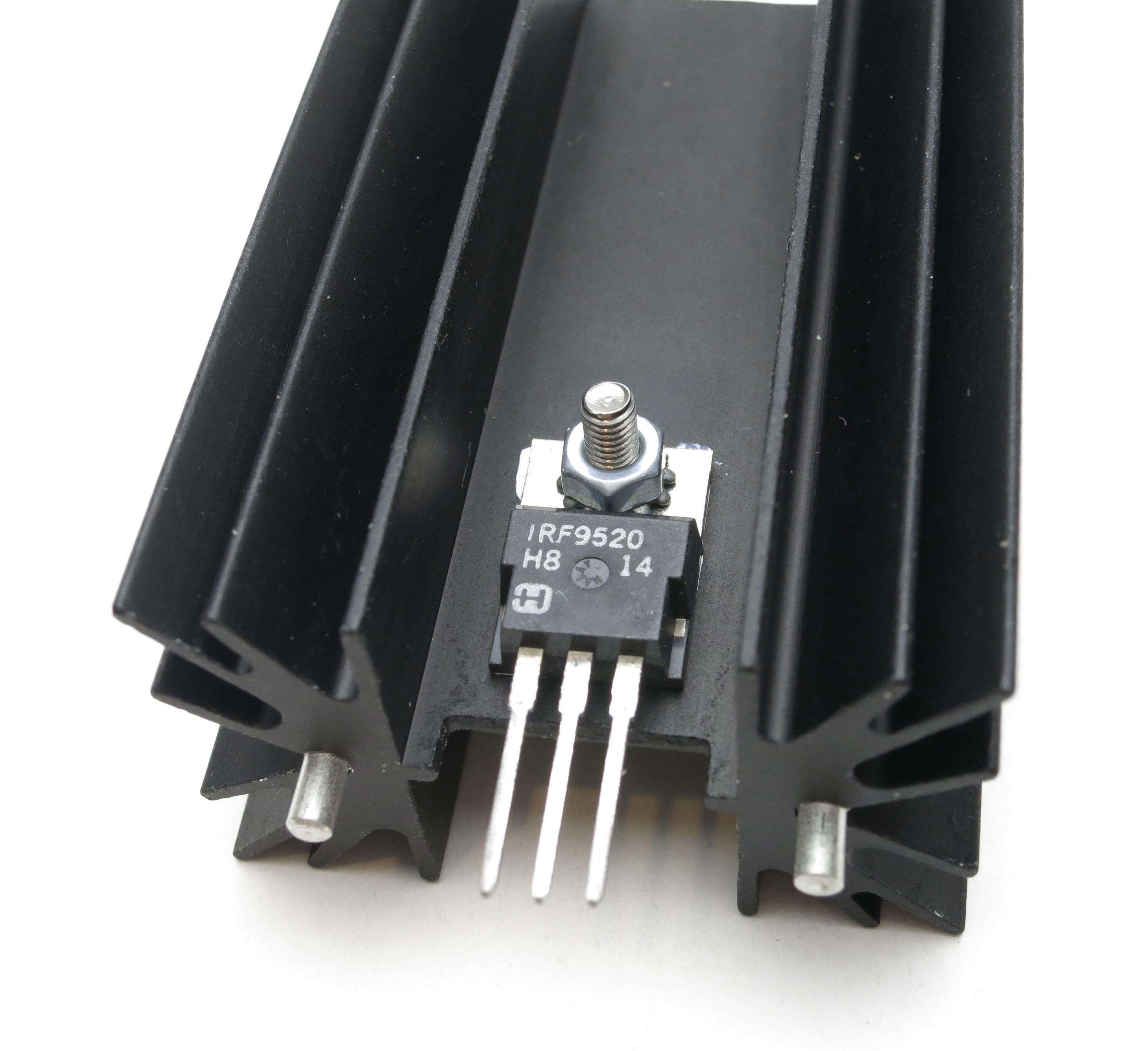

2) Heatsinks/Mosfet installation has an order of operations... A) attach mosfet to heatsink but leave it a little loose. B) insert assembly into PCB and solder only the heatsink. C) Final adjust and tighten the screw holding the mosfet. D) Solder mosfet.
That's about it. As far as I can tell, this project consists of stuffing the PCB, setting the bias and enjoying the music.
