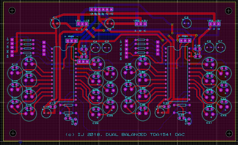

Hi Guys,
I've started to design a new PCB for the TDA1541A to make space for the 14 decoupling caps that are needed for a 50Hz DEM.
We can use this thread to start an interest list to get an idea on numbers, and a general discussion.
Eg: "ryanj x 1"...etc
I suggest allowing for two 1541s, either in parallel or balanced. Maybe you could add some hardware to produce bit perfect inverted data for the second one.
Below is my version using IanCandad's I2Sto PCM board.
I plan on giving ECdesigns "signed magnitude" idea a go in the near future, so I want to make sure it is upgradable by just adding another D3 PCB. Also want to keep it as simple as possible this time around, and not everyone is going to be interested in running dual mono/parallel/balanced.
If you could make the new pcb stackable using 2.54 pitch connector strips this would be a good way of covering all bases. (or a master / slave approach)
