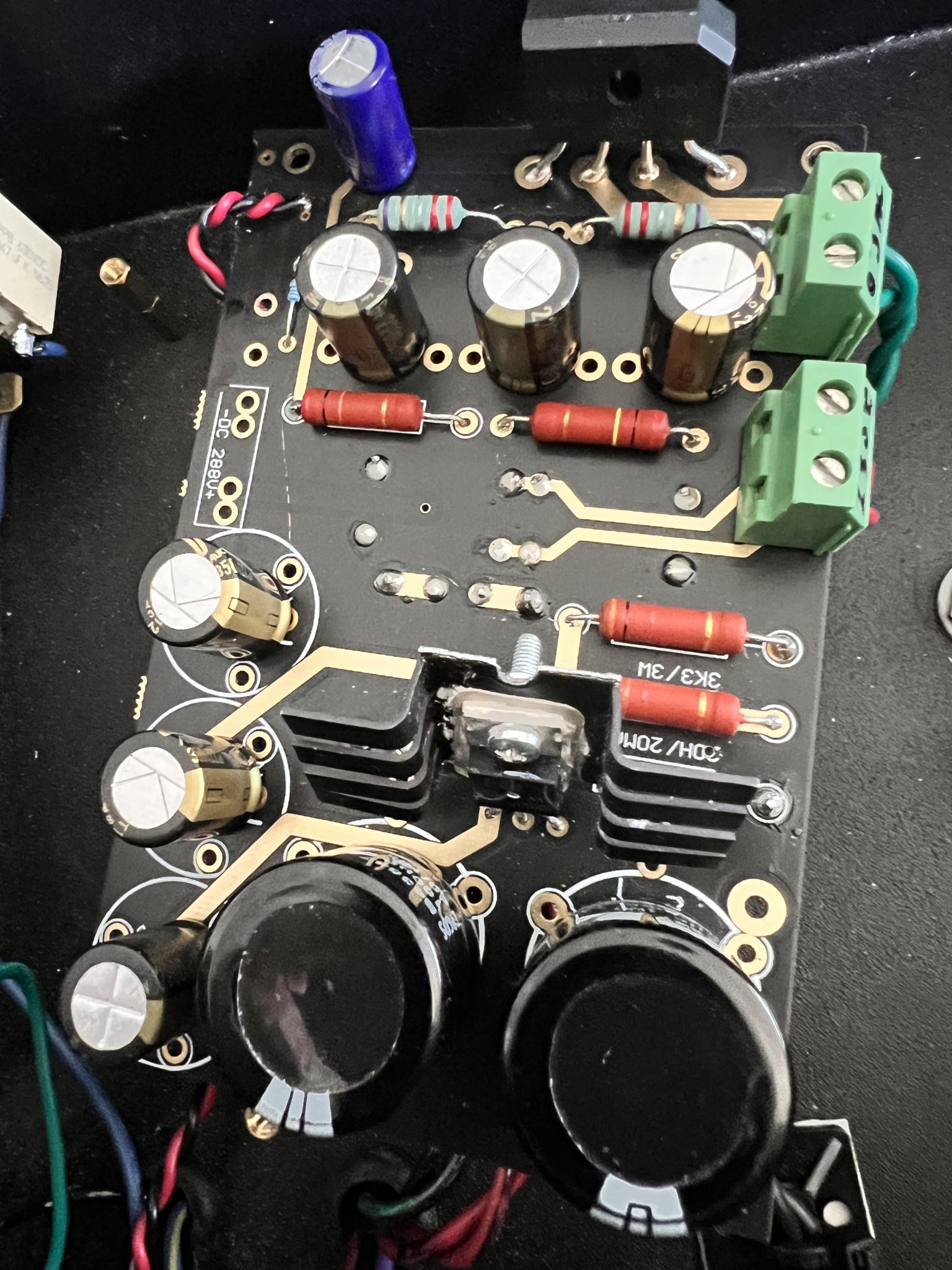

Hi Jan appreciate the help, this is only the second amp ive built ans im still learning alot. My fault findind skills are not great. Sorry to ask this i know how the continuity works on the meter, what im not certain about is from which point to which point i need to place the probes. As this is the first time i had an issue with a power supply

But you did measure 53Vac so where did that come from then?
How did you measure the continuity? What exactly did you do?
Edit: you may have been measuring stray voltage between one of the phases and the mains safety ground wire.

1. The 50 volts vac came from the 1st green socket on the board in the pic it came from measuring across that.
2. The continuity came from attaching the probe at one end of the red wires taken out of the socket in the board, the other end to the wire from the transformer to the input power socket. Also same wire at the on off switch.
