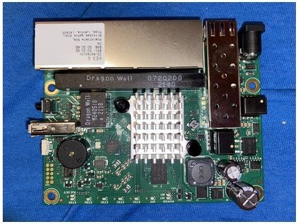

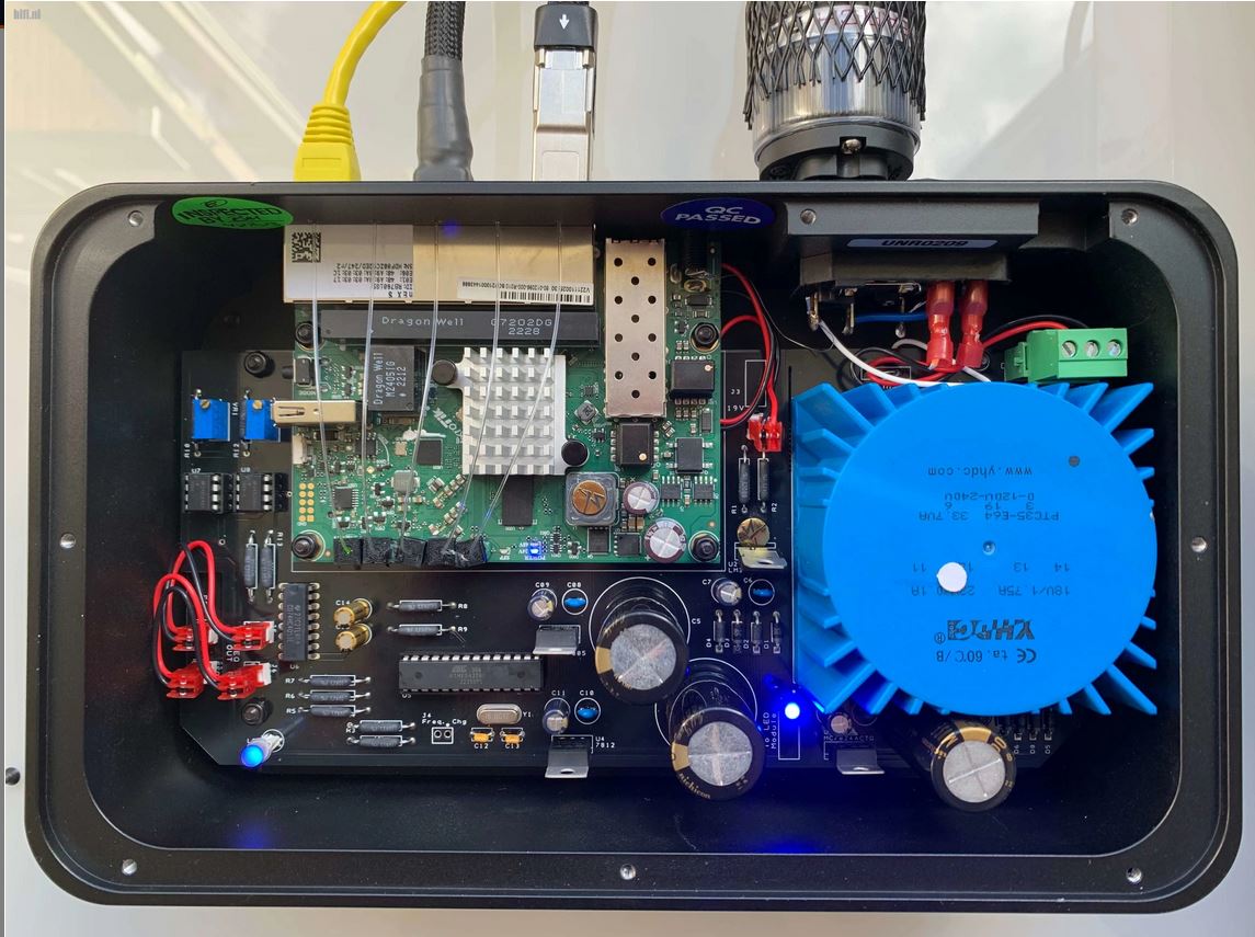

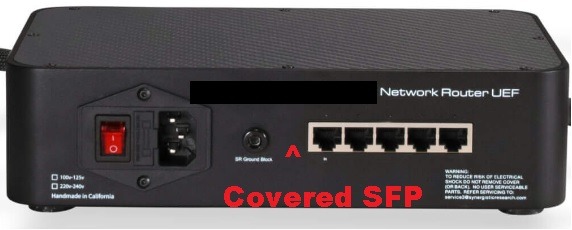

There is a ethernet router from MikroTik. A guy identified how its internals have been added to a "specialized audiophile" router.
As far as I can determine, the really expensive audiophile product only connects to the cheap MikroTik board to provide a power supply with two wires.
Price info on the "special" router
MSRP
$2995 110V
$3295 230V
with included 5ft Foundation 12awg AC cable ($599 Value)
and SR Pink Fuse ($249.95 Value)
