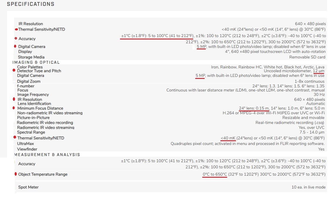

The problem is sensitivity - a very small area emits very little IR radiation.Is there any high resulution infrared camera/microscope that can measure the stylus tip temperature?

With red dot the essential specs to look for.Is there any high resulution infrared camera/microscope that can measure the stylus tip temperature?
Red underlined (more than) adequate values.
This is from a $30k unit.
George
