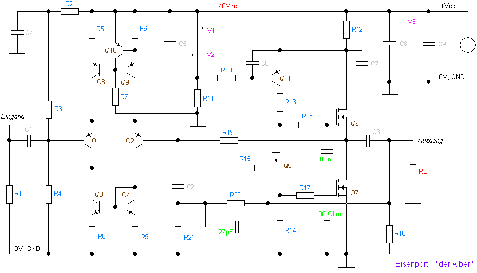

Eisenport: The first idea
Nothing speaks against a MOSFET version and somehow I also like the idea of Nelson Pass, his PLH version. So I thought I'd give it a try over the last few days. And since the HEXFETs are really quite unique - especially regarding their tendency to undesirable behavior, we sadly can see it for example in Elektor's HEXFET MPA from 1993 ... but work great in the pass amplifiers, I want to take up the challenge. A quiescent current stabilization or regulation is obviously essential, International Rectifier confirms this anyway, so the JLH96 modification is the obvious choice. That is the background to this idea. Two-stage amplification like the Aleph series, but also with a differential amplifier as the first stage - so that the negative feedback can really get to work, let's see what it can iron out.

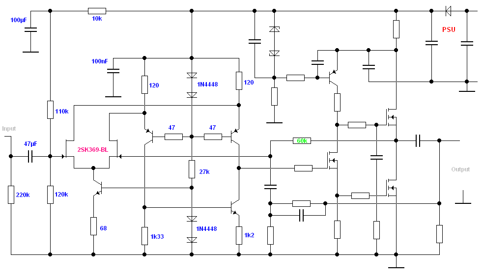

Less than 24 hours later, I was tormented by the question of whether a good design and concept would not require a field-effect transistor on the input and output side. In any case, Eisenport "der Alber" can be modified immediately in this direction (if it works at all in reality) and a cascode does no harm, quite the opposite in fact. We can use almost any type of jFet, not only Toshibas famos dual one. But I still have two pairs hidden somewhere.
Somehow the second idea was very obvious

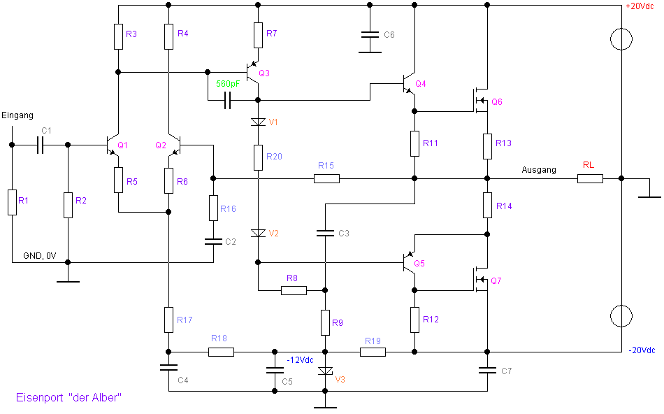

Eisenport: The third idea
My gut feeling is that there could be problems with the behavior of the connected speaker, the complex impedance and the emf. With a purely ohmic resistance, the simulations are promising.
If the rear fidgets, pulls and pushes, who knows how the power amplifier will behave?
A quasi-complementary de-amplifier, a push-pull operation, could perhaps combat the evil - and I like my father-in-law's ancient DUAL amplifier (CV120/121), it sounds amazingly good and works perfectly after almost fifty years (is in daily use). The quiescent current stabilization works here via an NTC resistor. So just swap the BJTs for N-MOS-FET.
The driving question is whether it (NTC) works with the HEXFET, as active quiescent regulation can still take place (see for example D. Self's Novel controller).
There are an abundant amout of issues addressed in this single topic. A large dish which needs a lot of chewing through.
Nevertheless is this 'Eisenport-concept' ("Iron-gate" ? - vergib mir meine seit 150 Jahren vergessene Muttersprache) quite different from the boring repititions of those well known and copied concepts mounting and suffocating the digital 'smart' portals.
You refer to Hiraga's design, but there's not that much left in this Eisenport concepts.
Jean Hiraga deliberately choose for an absolute symmetrical topology to have any uneven harmonics suppressed as much as possible - a pita for all unsym designs relying on sufficient amounts of overall negative feedback to 'keep the race car into track', an approach I sincerely disapprove.
There are more issues to address here, yet, appreciated!
Running one of the output transistors at constant current is doomed to very low efficiency.
The third idea can approach 50% efficiency.
IMO, the way to design class A is to start with a modern class AB topology. The supply voltages and biasing can be adapted to class A operation. This will produce a superior amplifier compared to old class A designs.

Many thanks to all of you :).
The dish served hides something that is true and is exactly as intended, namely the essential points of a concept that are exciting and profitable in a discussion.
Dear @Citizen124032,
I would be delighted if you could give free rein to your thoughts on this. By the way, Eisenport (iron-gate) etymologically correctly expresses what you probably suspect: an inner and outer attitude, a so-called "Hut" (i.e. in historical fencing language something like a guard, a starting point also). It is noble and seemingly harmless. Just like the conceptual ideas of the three designs.
Jean Hiraga only fits into the introduction in so far as it (the concept) has been in my head for decades, the SYMM amplifier mentioned is very similar in design and I still have two monos of it. I believe Accuphase also pursued this concept commercially. Hiraga doesn't necessarily fit into this thread, but you can put these two different concepts on a scale and weigh the pros and cons against each other - so keep them in mind.
At the moment I am very interested in your opinions on the above menu, idea 1 (and consequently idea 2) in comparison to idea 3 - and also completely independently.
Completely open on every point.

I will probably use the jFet-BJT cascode as the first stage after all, as it somehow feels a little better suited to the concept of the Eisenport project.
The simulations of the distortion behavior are basically very promising, but I can see an anomaly on the rising edge of the signal at higher frequencies.
Like a dead time in the positive zero crossing, and strangely enough this also seems to be level-dependent, at required power levels of less than 5Wrms everything seems to be fine.
Clearly visible with THD10k, but it is still < 0.1%, k3 dominates. Strange. Is it due to the different switching times (on and off) of the high-side switch (behavior!), i.e. the Q6?
Or is it caused by the gate stopper resistance of Q5?
I actually wanted to avoid a test setup for a short while, but apparently that's not possible - I don't really trust the simulation.
