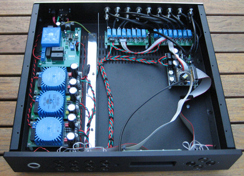

I'm just completing this project and Elektor mention at the end of the article adding small RC networks on the inputs to suppress induced RF noise on the cables. Has anyone added these and what values did you use?

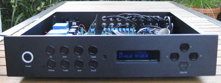

I used an Optrex 20x2 blue character transmissive display. Looks pretty cool...just check the pinout for the one you use and match with the PCB pinout...shouldn't have any problem getting virtually any to work

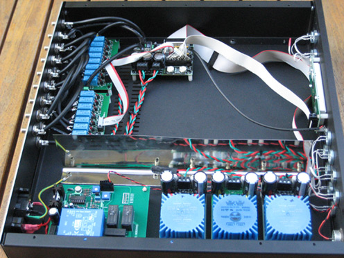

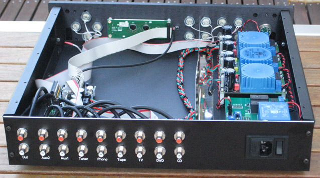

The only differences are I've used 3 power supply boards instead of 2 - 1 powers the relay boards (through a 5v regulator attached to the output of the board), 2 relay boards in parallel so I can switch the signal and ground lines of 8 inputs, a power on board (my design) which enables me to use a momentary switch on the front panel as the power switch, and the display is an Optrex 20x2 blue character (haven't changed the code). I also put 100 ohm resistors on the output and small RC on the input to the main board as per Elektor's final comments. I fitted a metal screen between the power supply boards and the pre-amp boards for extra shielding (again as Elektor suggested).
So the preamp is the same design as the original, just with a couple of minor tweaks of supporting boards.
Sound wise I found it very impressive, although I only listened for a couple of hours as I built it for my mother-in-law. She has been listening non-stop for the past couple of days and loves it. I've posted some pics in the Solid State pics post of this and an Aussie Amplifier nxV200 amp I built as its matching mate.
