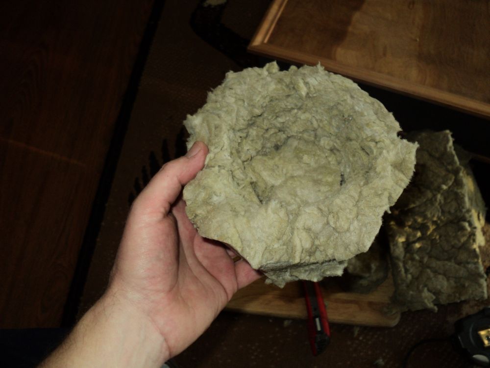

For stuffing, when I was voicing the speakers, I found the best way was to stuff the driver chamber with a 'cup' of insulation and if that was not enough, add a little in the throats of the horn until the boominess went away. I did not have luck with adding damping to the horn mouths but if that's what you wish then try doing just a couple of them.

Thanks for all the advice, it seems that I might have overstuffed so next step will be to remove say 50% and see what that sounds like, I will try to avoid filters/boost for the time being although I am partial to a good bass line...

You may be right Dave, but for me the whole point of building the cornu was to get bass out of a tiny driver. A 3" driver in my case. I thought the lower mids weren't to my liking so I used a bsc filter made from old stuff in my parts bin and stuffing to effectively EQ the sound to make me happy.

All that meant a few hours spare to play with the Cornu’s. Disconnect and bring down from their ceiling homes (in the shed/workshop – a 4m x 3m Scandi type log hut), opened up and a load of stuffing removed from the horns and cavity. The horn stuffing is now approximately 5 inches of teased out sheep’s wool enclosed in tights, the cavity has a 20mm layer of felted sheep’s wool in the bottom and around the sides, teased out a bit around the horn throats. There is also a layer of light acoustic mat behind the speakers to keep the wool away from the cone.
First impressions were a good increase in Bass and a more balanced sound. So they were then left playing to burn in while I got on with more SWMBO tasks.

So I think I have hit a good place to stop and just listen to the Cornu's. You have to remember that these are just little 3 inch drivers even though they are in 600x600mm boxes (they do look a little lost in all that front panel space). They soak up the power, have a good range and sound pretty amazing – Ok not comparable to my Meridians – but the Cornu's cost less than £50- the pair unlike the Meridians.
End result the Workshop has a proper sound system. Thanks XRK and Carl for the inspiration.
