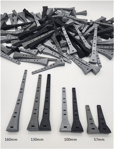

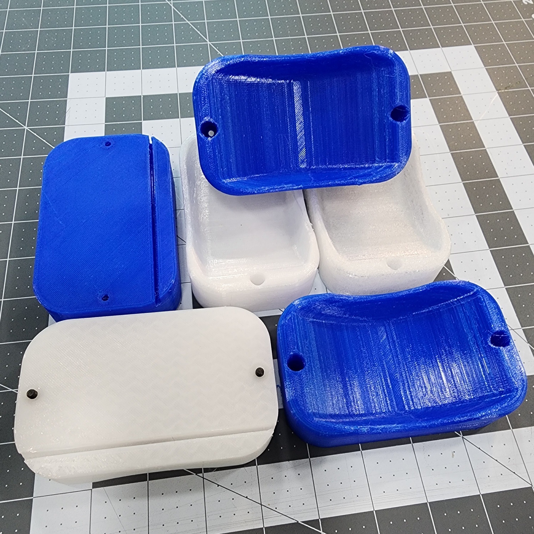

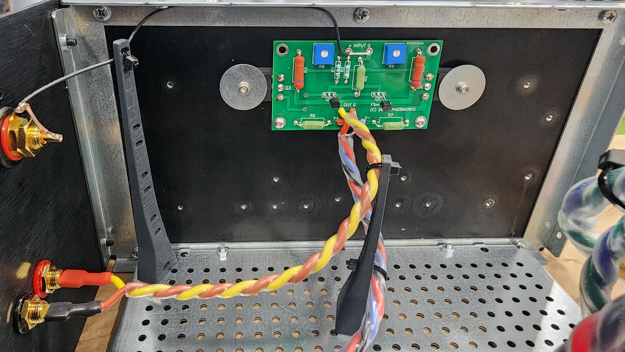

If anyone is interested in a transformer vertical mount/seat and/or wire posts for wire management with their F5m (or other amps for that matter), I am happily providing full kits for the very reasonable price of free plus a prepaid shipping label. Limited quantities are available for interested parties with the goal to pay it forward to the diyaudio community to continue to grow and foster the amazing generosity on this site.
https://www.diyaudio.com/community/threads/f5m-kit.408290/post-7627904
https://www.diyaudio.com/community/threads/transformer-chassis-seat-antek-300-400.410463/
https://www.diyaudio.com/community/threads/wire-post-for-wire-mangement-3d-print.410484/
