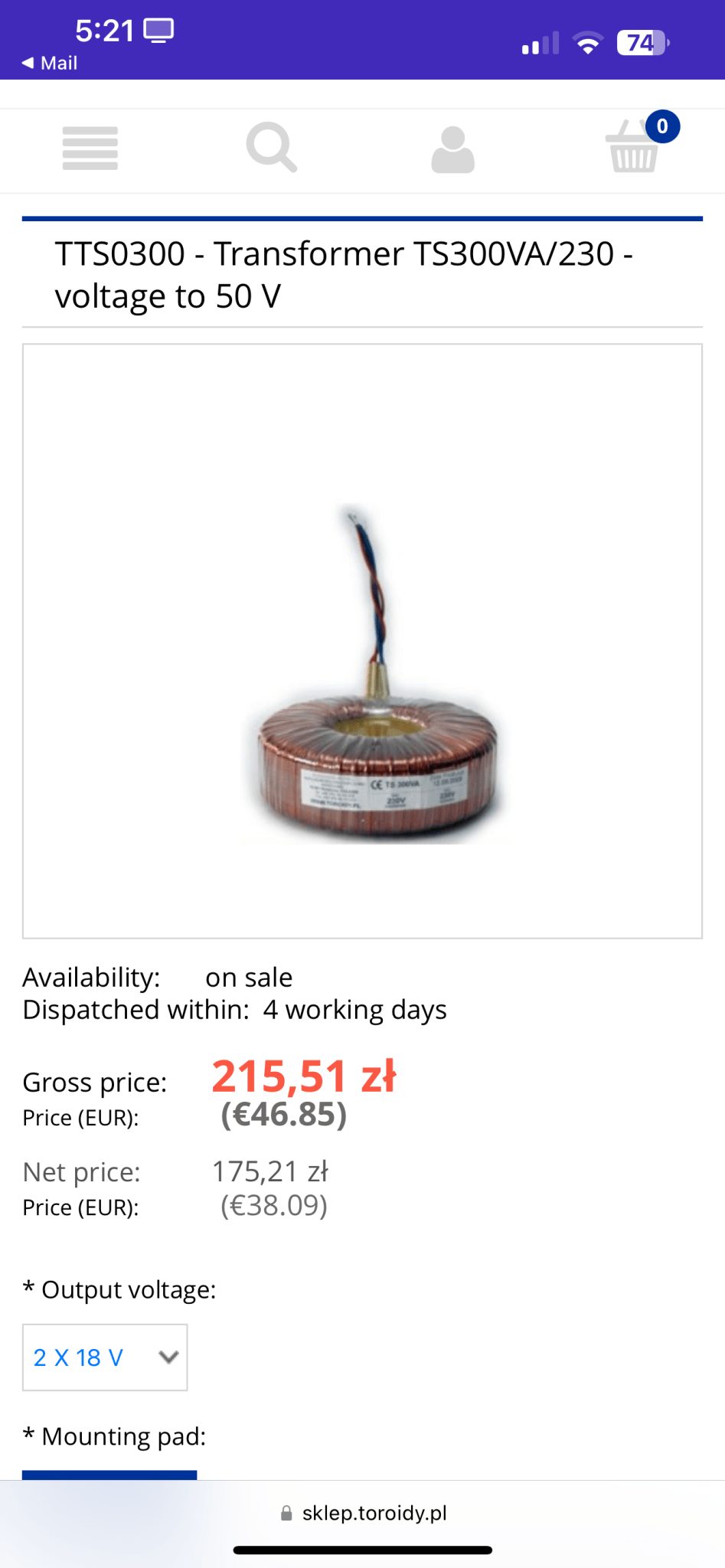

It is not intended to be a massively powerful amp. A 300VA transformer is sufficient, as is a basic 4U chassis. Even a 3U chassis is Ok. No need to spend too much on this one, it is also supposed to be less expensive.

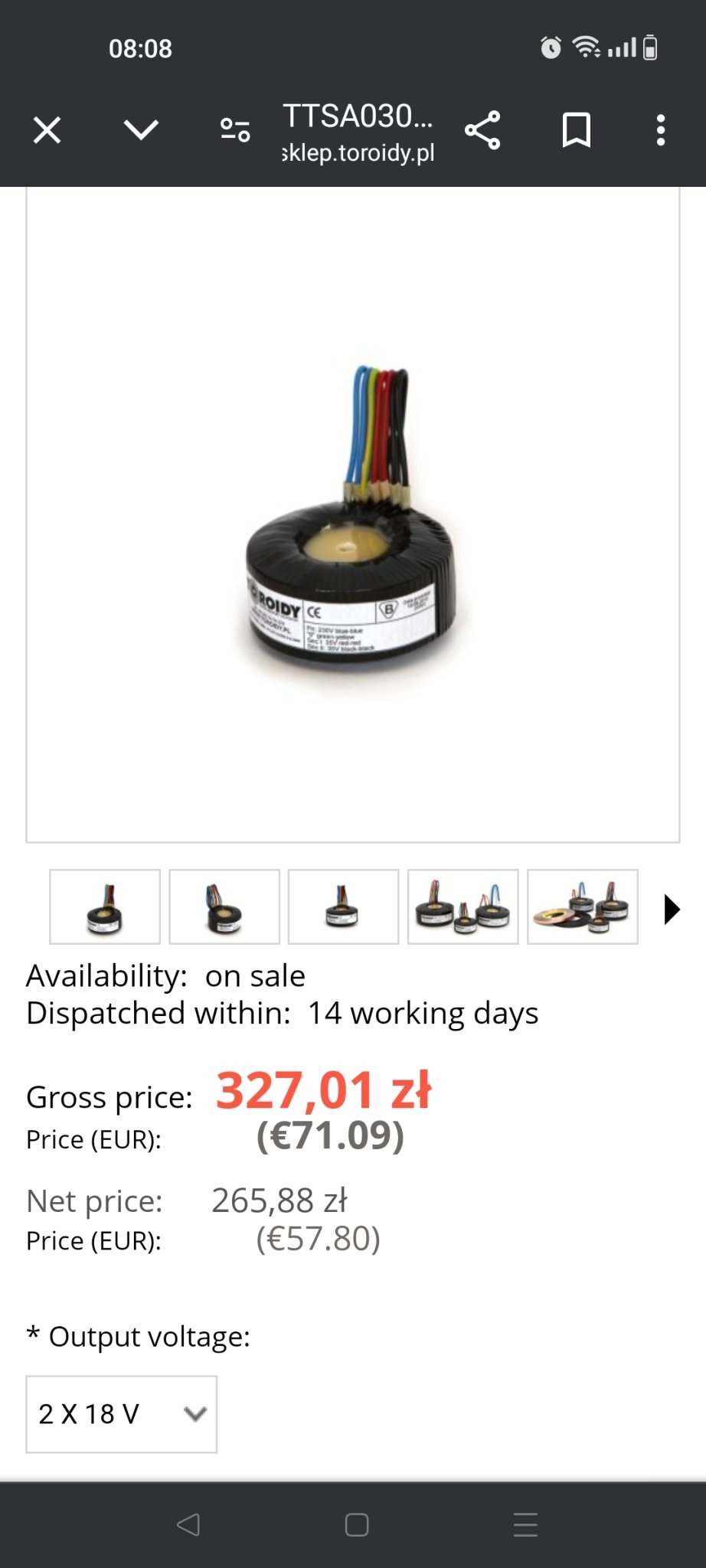

what it brings to have 400 va?

300va vs 400va? I use the 400va because the cost differential is minor and I like the flexibility of having more current available for other projects. Mr. Pass ships his FW products with a 300va xfmr and I would go that route for a permanent build.
