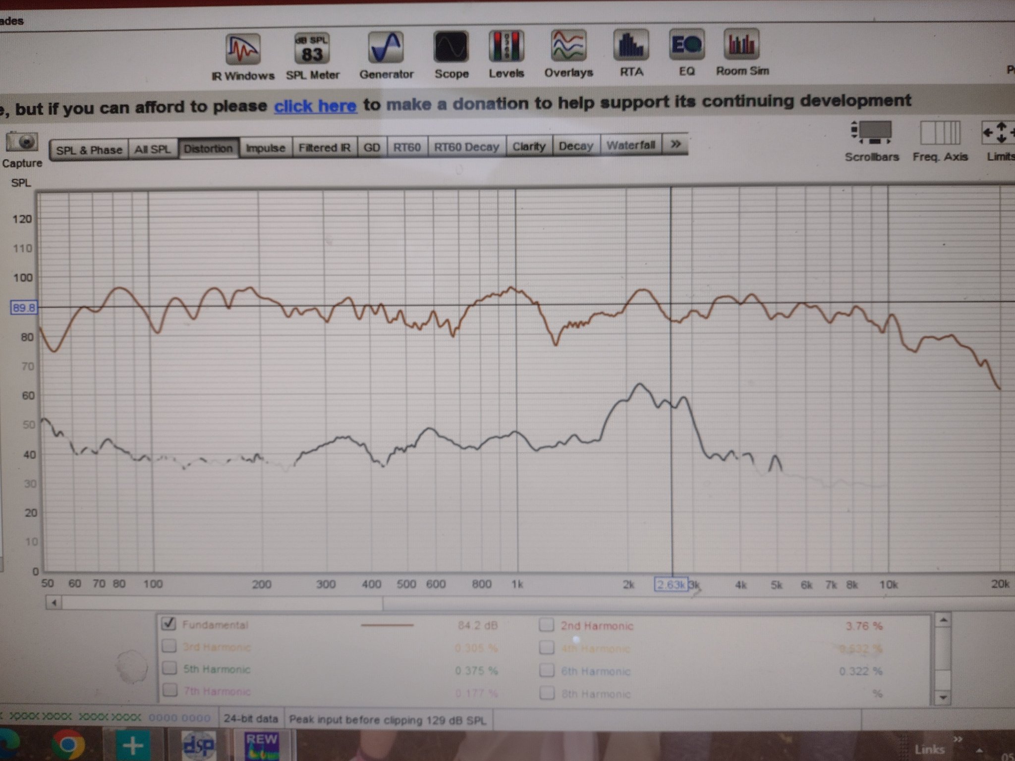

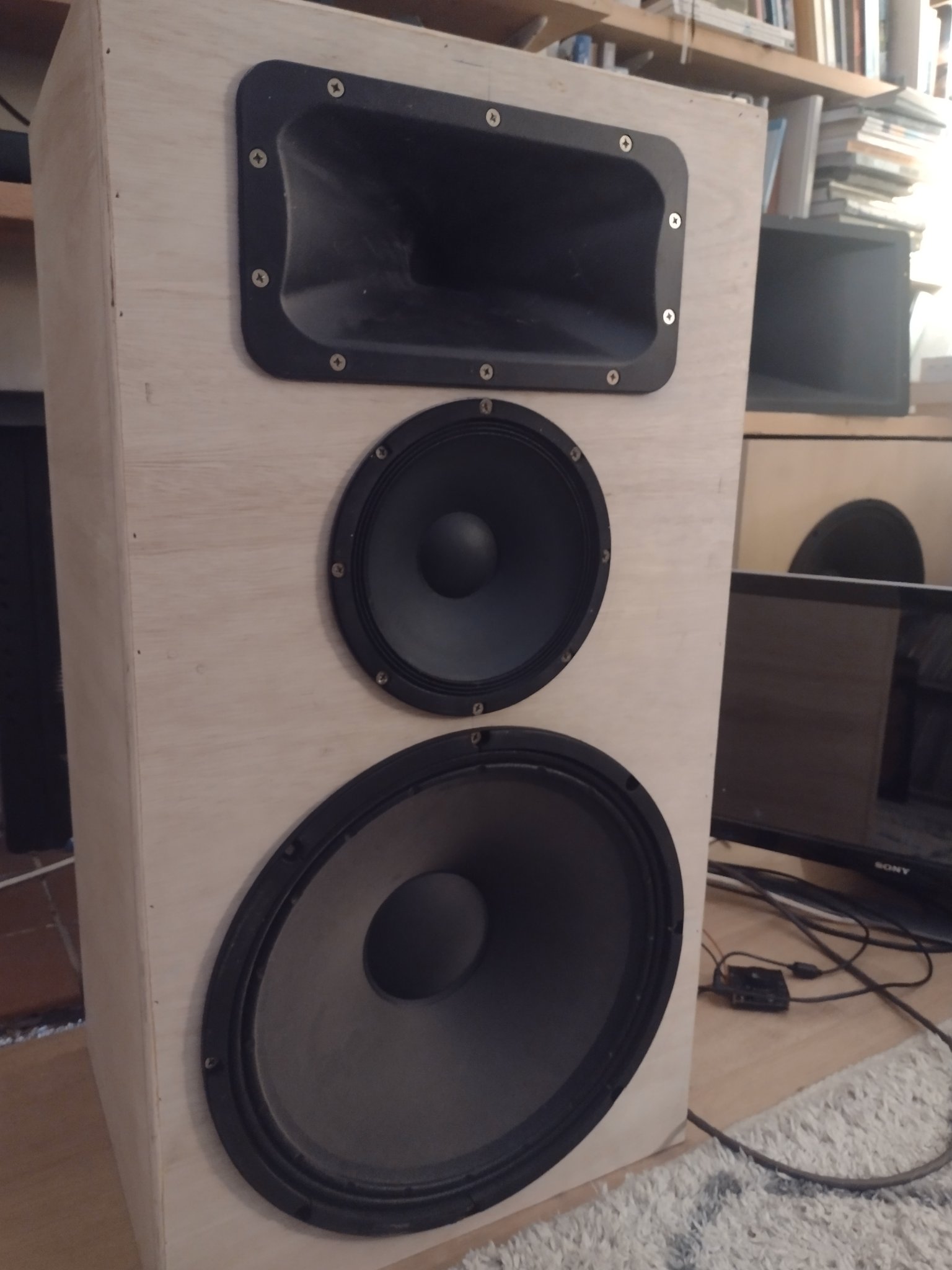

8fe400 arrived a while ago. Will knock up a box with celestion cdx1-1746/Pyle ph612 to sit on sealed 15" bass and do some measurements.

Ignore the distortion measurements, I tried a different pc that had lousy output volume so this is flat out with the umik very close to the driver to get to 90db ish. Will try again with sufficient drive.

Sounds like a nice project! On paper looks like LR2 around 1.5k for a near perfect directivity match to the Pyle horn If you can physically align their acoustic centers. The low Xo point will smooth out that resonance wiggle at 2k jussssst enough.

I'm not sure the celestion cdx1-1746 I have will go to 1500 I've not tried them yet. Worth a go. These wouldn't be my main speakers, so I'd like them to be able to get loud enough to make best use of the pro audio USP

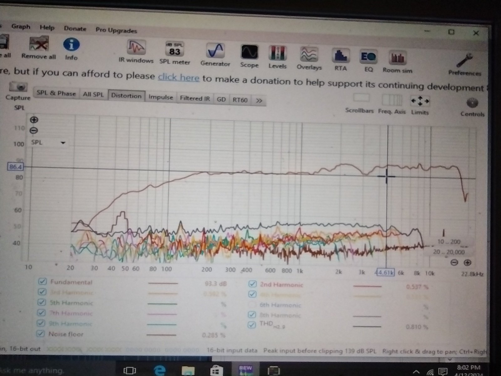

Had an afternoon messing about with a test enclosure and minidsp.
Quite a fun sounding speaker. 12l sealed enclosure for the 8fe400, I've had that bump of distortion on a meh with my celestion cdx 1746 1700-3000hz before. Don't know if that's typical of them, I'll try another one.
Bit of eq got it
down flat to 35hz and sorted the bump at 920hz. And the CD eq.
