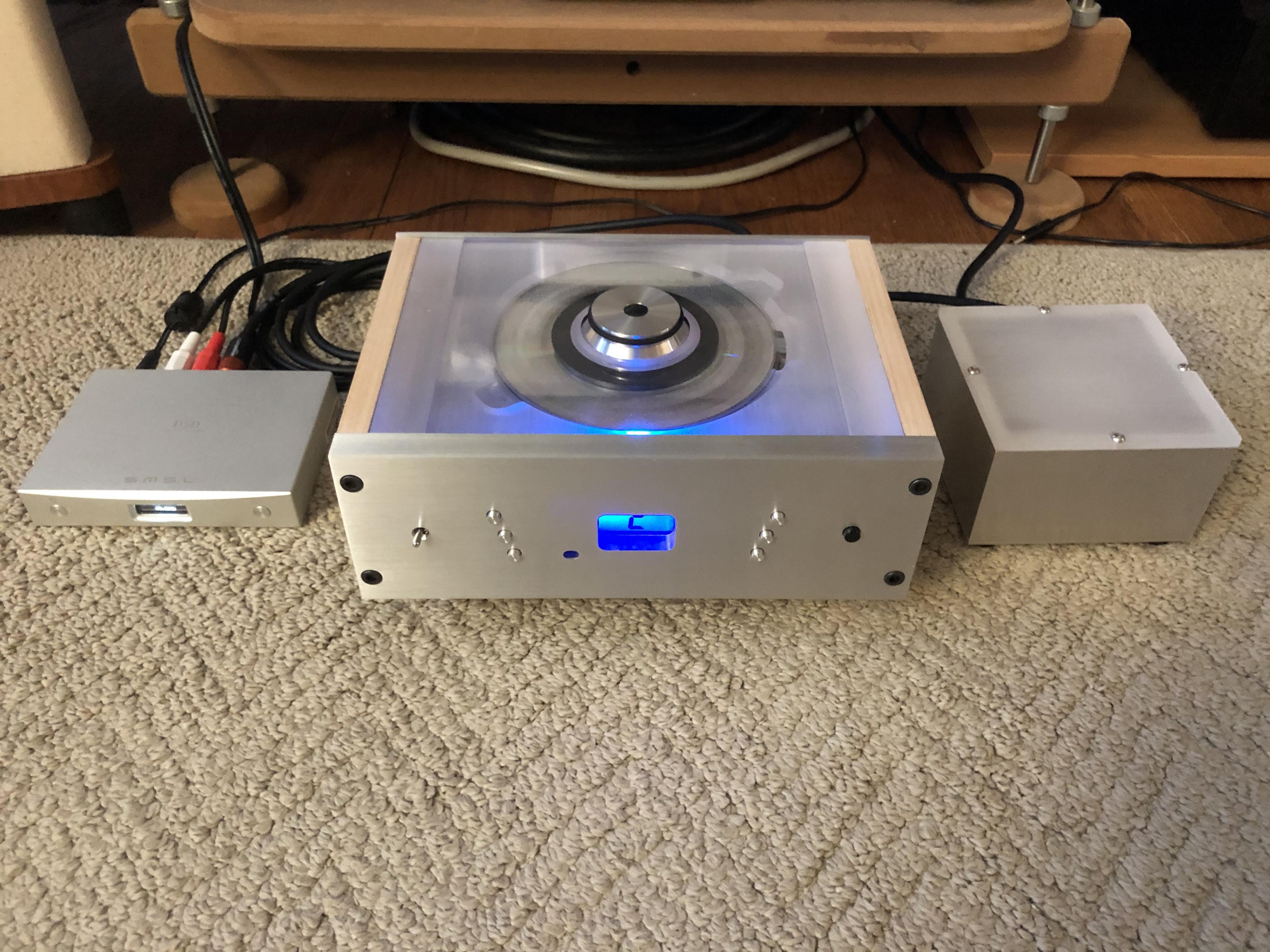

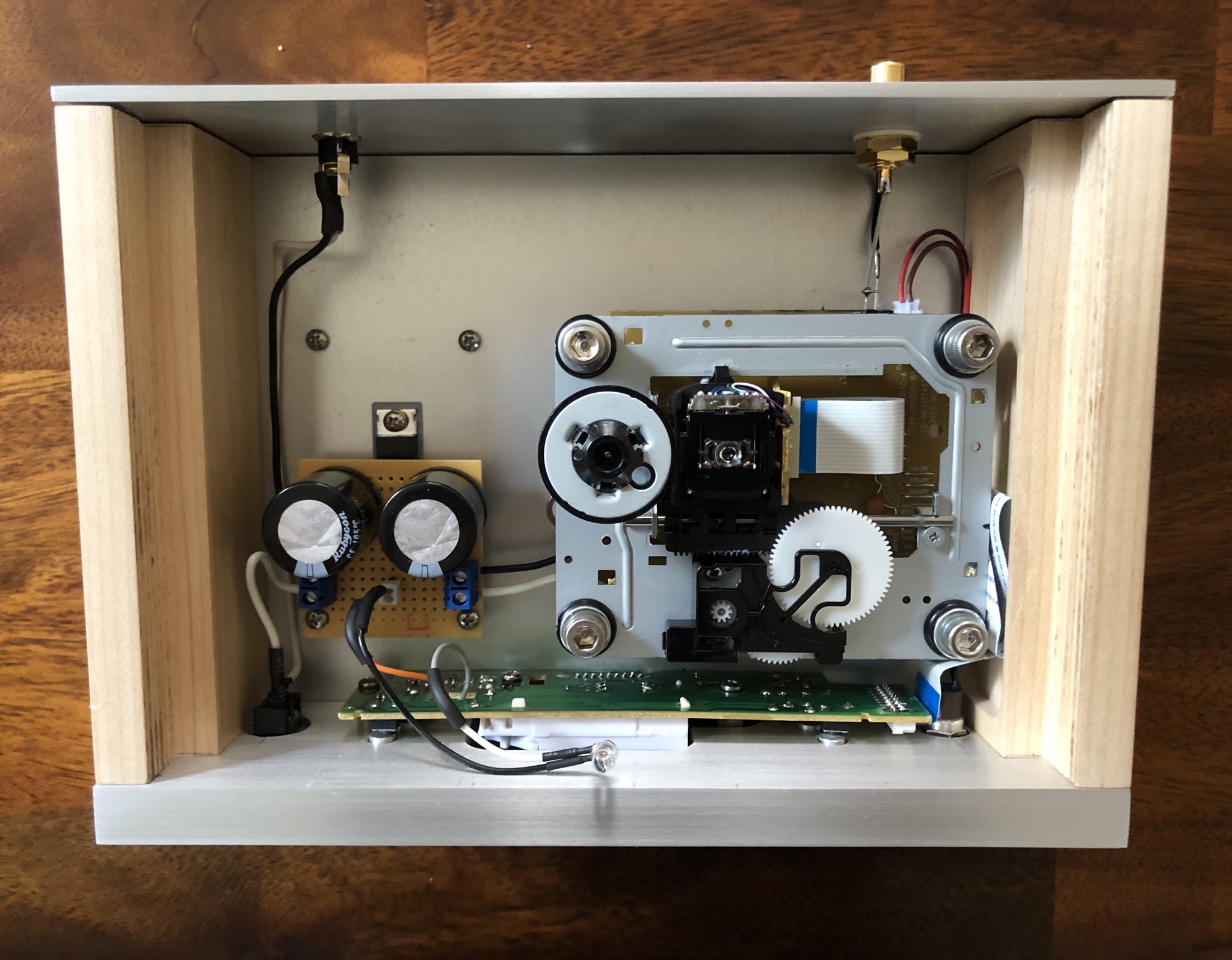

I managed to work my way through building a Salas SSLV v1.1 to try as a power supply. It took me a while to get the current setting so it could handle the demands of the Shiga while reading the TOC.
By the time I got the SSLV set up properly I realized it was going to need a much bigger heatsink than was realistic. I wanted a compact supply design. It won’t go to waste as I can set it up to use with my D3 DAC project.
Afterwards, I managed to put together a supply similar to Peter’s original design that seems to work fine.
I found an LM7808 regulator equivalent made by NTE in a local shop which I put on some perf board with some Rubycon caps I had. I bipassed the first with a Silmic II and built the transformer and my own rectifier board from MUR860 into a small case I made.
I think it sounds better than the wallwort I was using previously. I might try the SSLV just to see if it makes any difference.
Other than that I did a little more trouble shooting and found that I had a clearance issue with my tray and the laser mech that was preventing it from playing the last tracks on long CDs. Took it back off and did a little machining on the underside. Now all is good. It plays very nicely.
I’ve only done Peter’s basic mods for now and am using my SMSL M8 while I gear up for my DAC project.

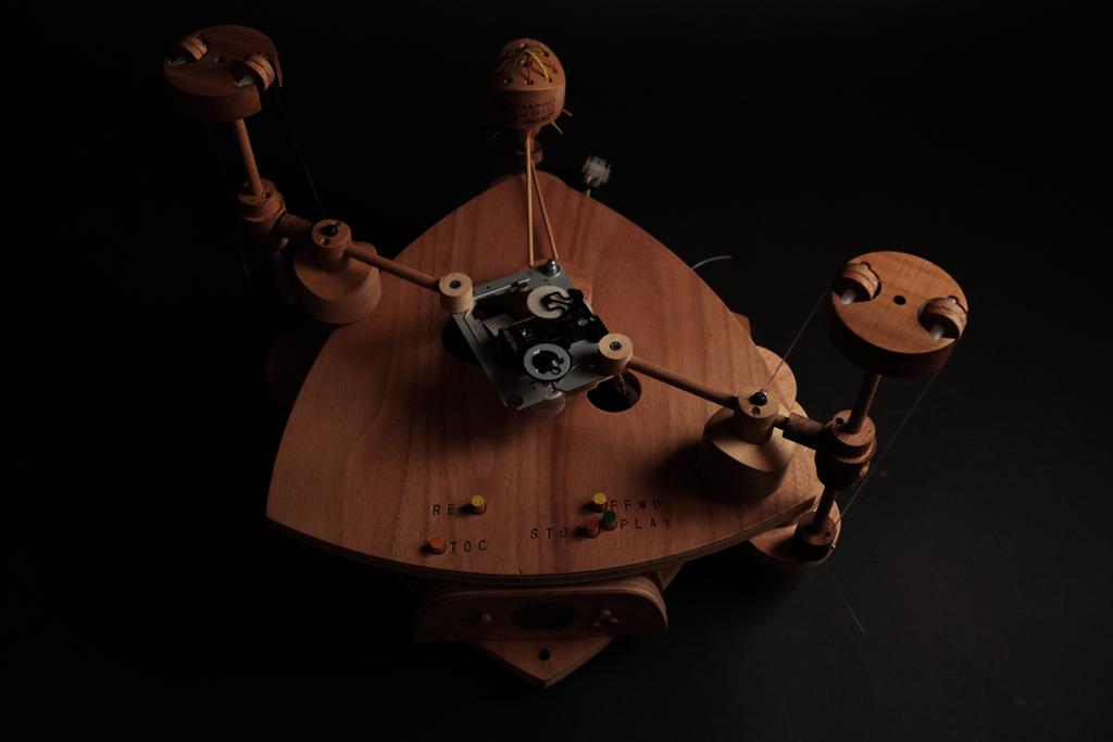

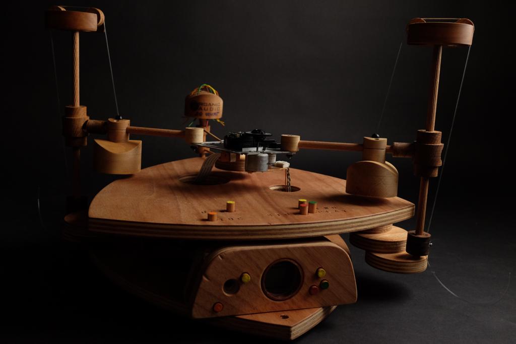

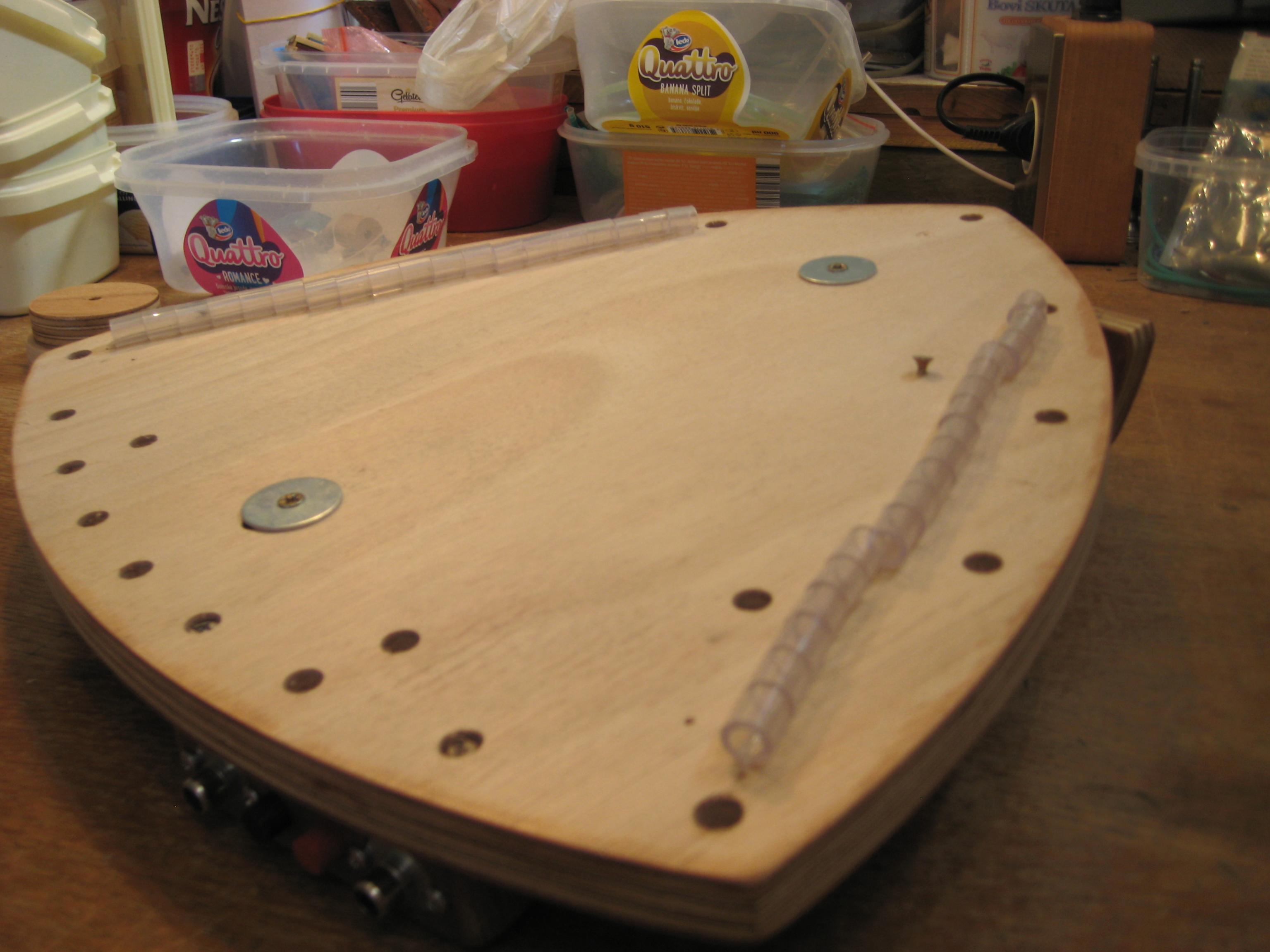

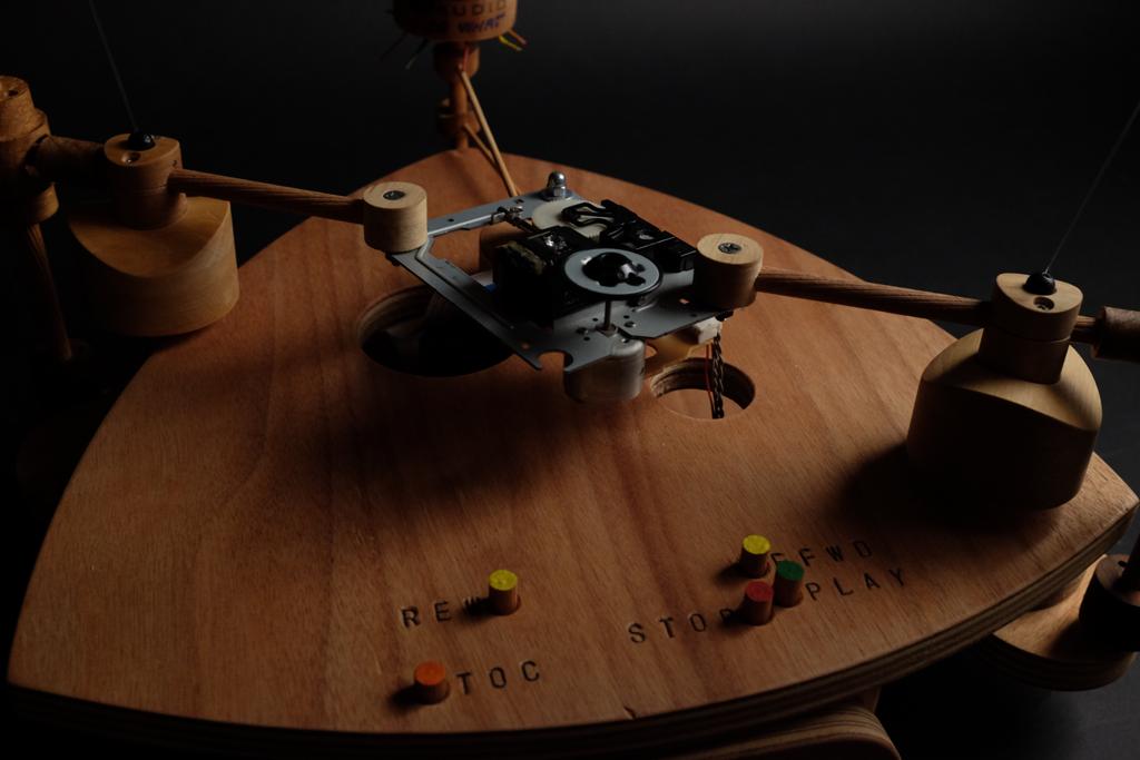

lohk ,I hope the prototyping period video is demonstrating at least the idea of the three planes of shock absorbing system.
Right now I am in the process of finishing the second sample of the same transport and I can take some pictures of the concrete solutions for triple planes for the two points absorption , as my work on it allows me...
Electronic board which is coupled to the vibration of both first and a second platform , stands on the two discs which are part of the two wooden sticks , coupling the base platform and the upper one .
Everything is ''loose'' but firm at the same time ,no tight screwing ,no glue...
Everything is just laid down and the layers of the whole transport construction are hold together by two nylon threads which are also used to tune the vibration of the construction in the similar way that is done on an musical instrument.
