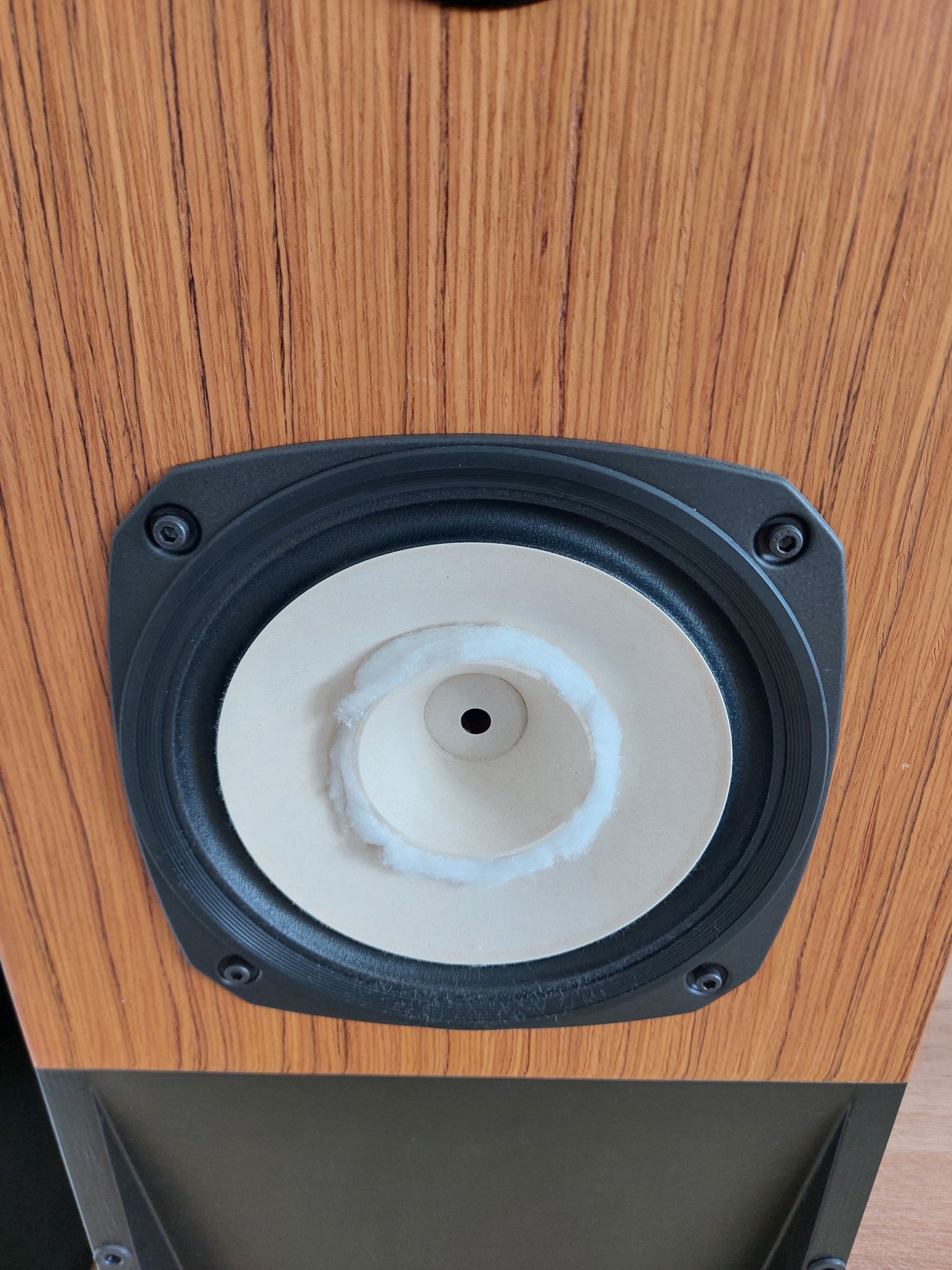

The biggest upgrade you can make is to remove the whizzer. The driver will still have a rising response and your super tweeter cab be used to fill in the top of the frequency range. Done this mod twice now. Once on fostex 206e and on Goodmans twin axiom 8. The sound was clearer and smoother. A substantial improvement compared to phase plugs.

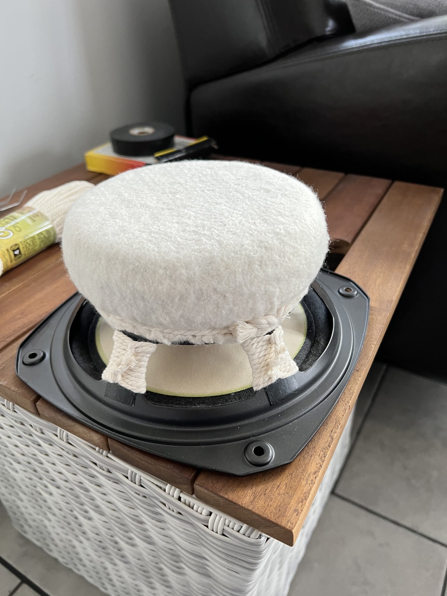

If you have concern about major surgery, try the 98 cent tweak - it's non-permanent.
Get some acoustic damping fluff, and tuck it in behind the whizzer. If you don't like it, take it back out.
The DIYAudio posts I found wouldn't load (too old? or just a temporary hiccup?), but here's a pic from a different forum...
https://forum.polkaudio.com/discussion/188819/fur-collar-for-my-whizzers
Reactions: 1 users
I put pure coton this morning,listening for few hours,i hear big difrence in high spectrum,no itching sound any more,sometimes i miss sharpnes,but all together,for now,much better and more flat response. At least to my ears,i didnt messure,maybe i find time later to mesure response.
Good 98 cent hack!
Reactions: 1 user
When I tried the 98 cent method I neatly tucked it behind the whizzer. The result was not much improvement to my ears. Looking at your cotton being proud of the whizzer on your speaker I've realised that the way you have done it is probably suppressing the half wave resonance due to the diameter of the whizzer, therefore much better. This seems to relate to the 2600 ish hz peak in the frequency response. Can someone please verify if I'm on the right track.

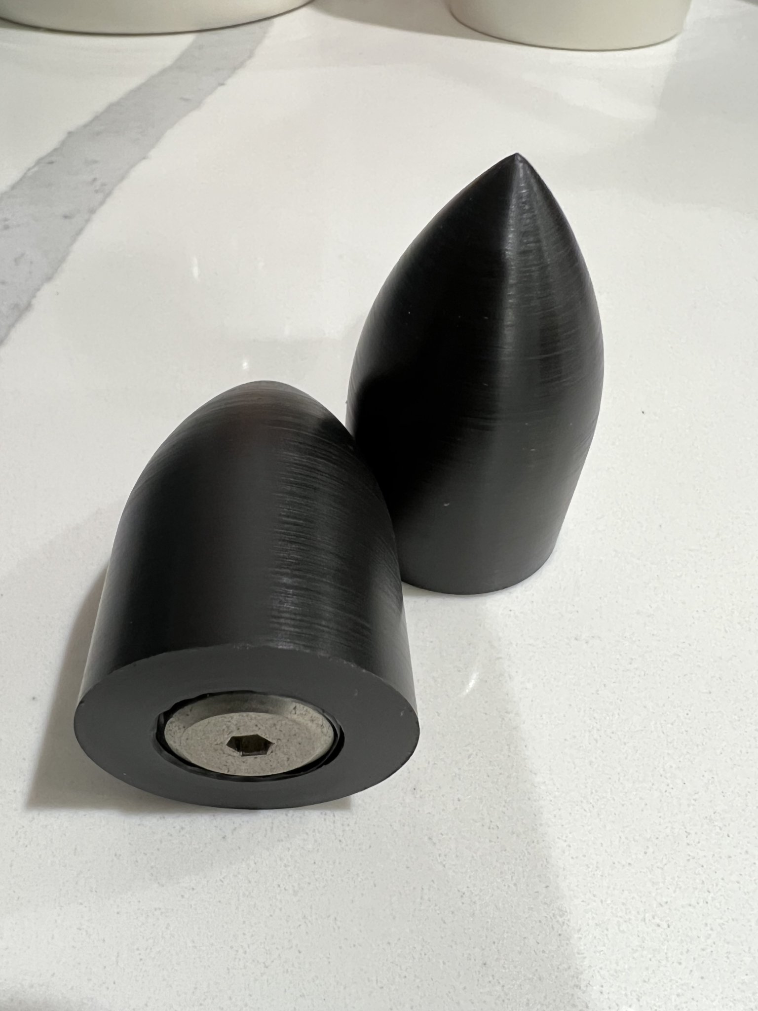

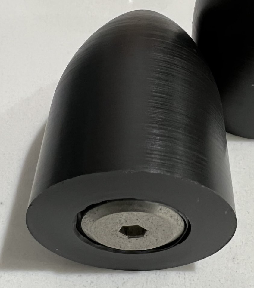

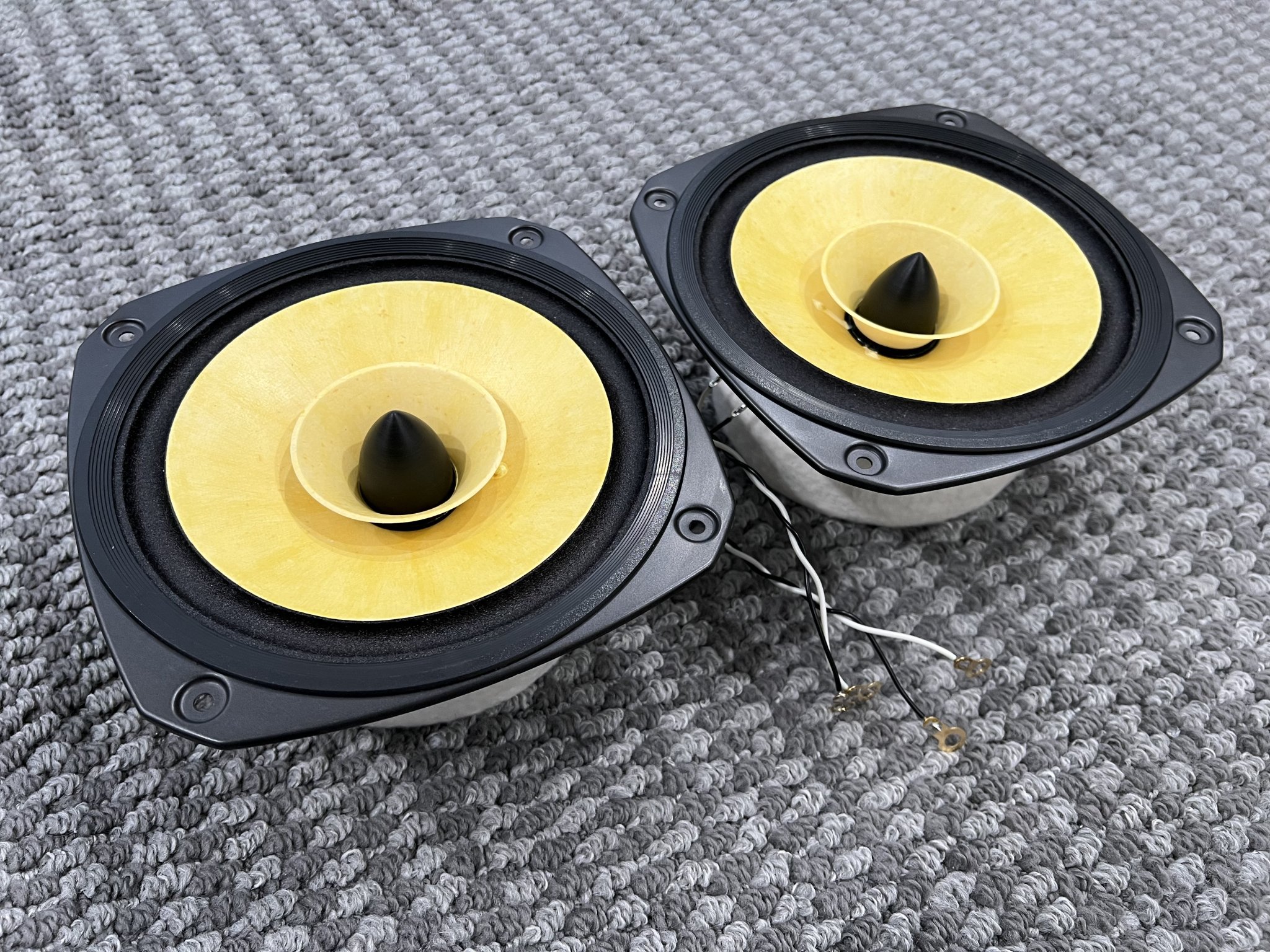

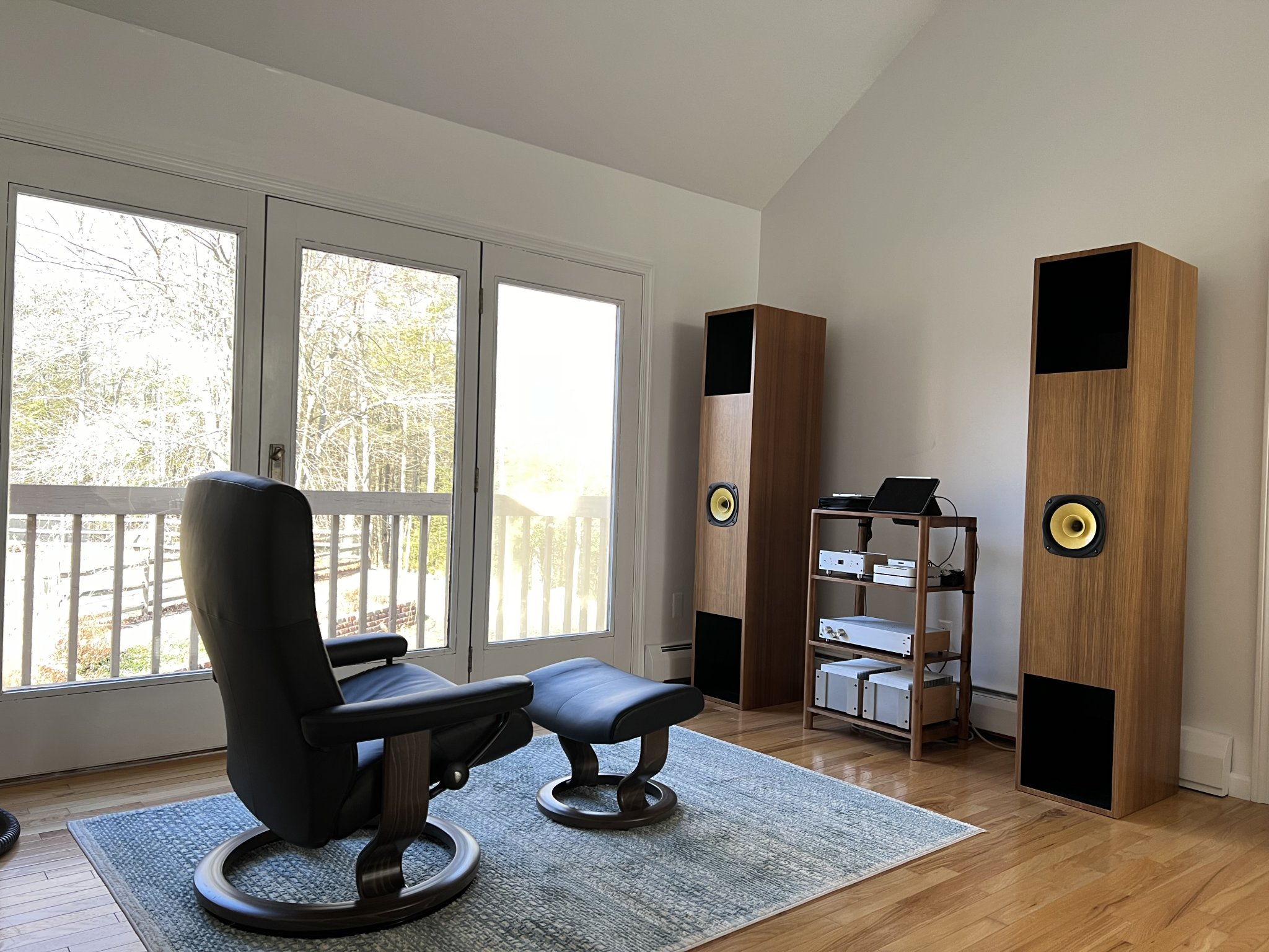

Fostex 206e in Sachickos with one coat of tinted puzzle coat on the cone and whizzer.
Dust-cap-ectomy and phase plugs I machined from Delrin I had lying around.
With the phase plugs I mirror matched the profile of the whizzer as best I could and made them just long enough to be proud of the whizzer.
I spent some time damping the frame with cotton felt and cord and wrapped the magnet as well.
I personally never found the 206e to be horribly shouty…especially when compared to the likes of a Lowther DX3.
Tang Band W8-1808 sounded muted and dull compared to either the Lowther or Fostex.
In general I felt the Fostex was the best “all-rounder” and did a better job with a larger variety of material.
This is a speaker I play pretty much daily driven by my DCB1 (modified with Jensen transformers on the output a la Iron Pre style) and F2J monoblocks.
It is remarkable at some things. I really enjoy the imaging of point source drivers.
How much better is it modified? That may be different for each individual. I would say it wasn’t a waste of time.

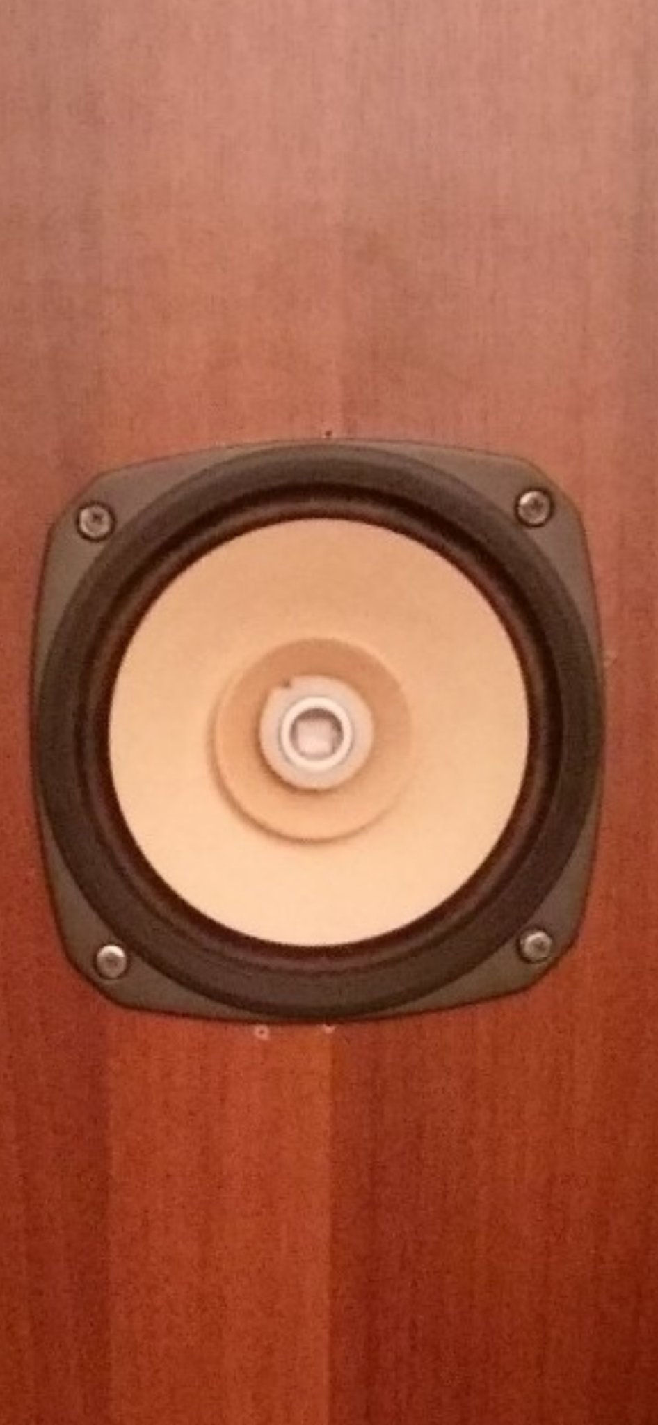

This is what I did on my Fostex FE 206 E.
It improved the sound a bit, but I won't do that again, since the wrench adapter was so strongly held by the magnet, that I did not even try to remove it, out of fear of damaging the driver…

Don’t you find the single centred bit of steel causes the phase plug to want to tip over? We found that with early experiments.
dave

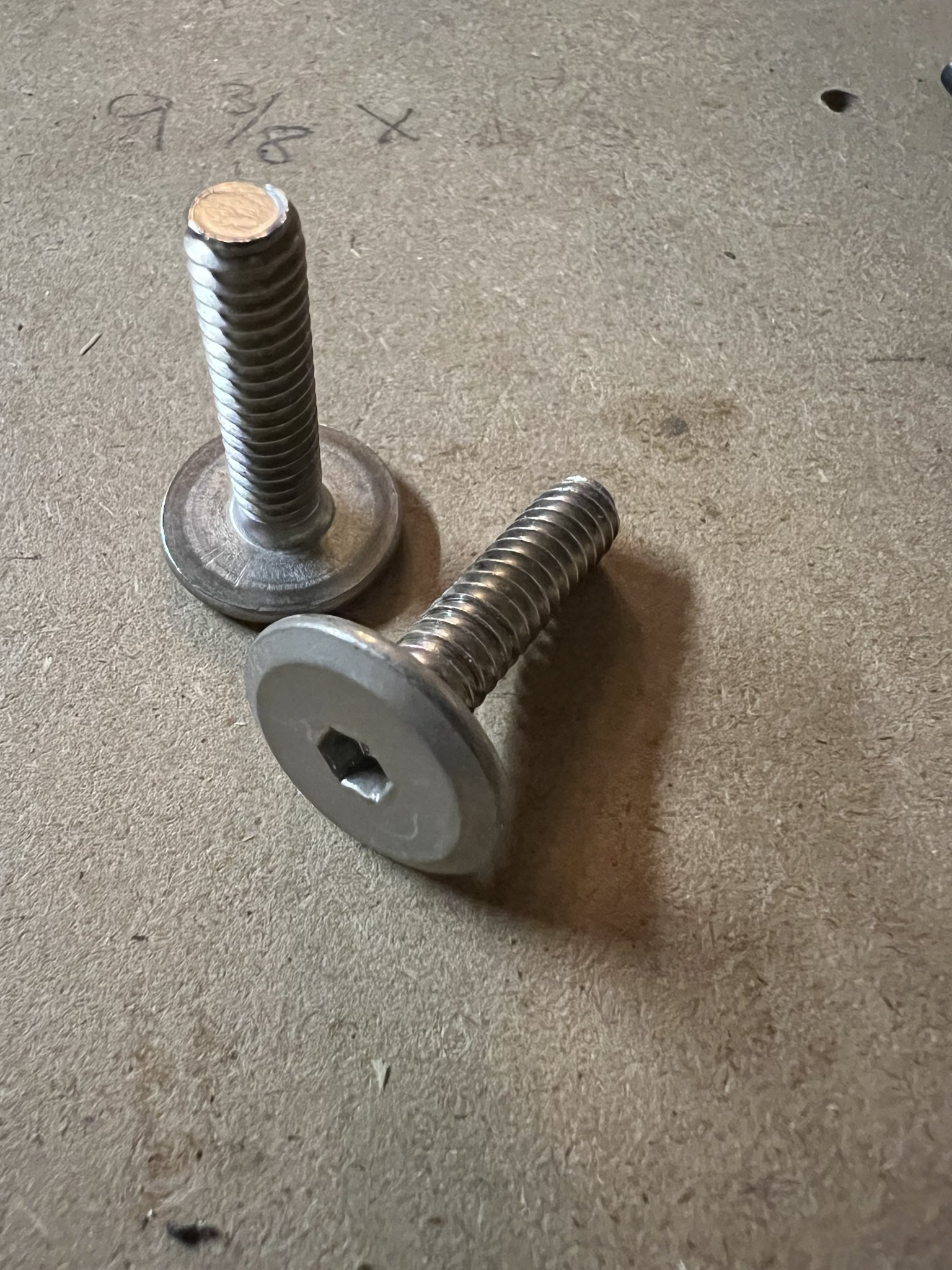

Hi Dave
The hardware has an enlarged flat head. (See pic)
I think I had it left over from some IKEA furniture I tore down and saved the hardware from.
You can also find this hardware in a local True Value Hardware store here in the US for a few bucks. I’ve used them to anchor transformers in amp cases as well.
No tendency to tip over.
However, since the pole piece of the driver was uneven (which causes rocking) the screw heads are threaded in just below the contact surface on the base of the phase plug.
The magnetic force is still strong enough to hold the plugs in place firmly.
The foot in the final iteration is actually only 3-4 mm wide at the circumference of the plug base.
This arrangement allows the large diameter foot of the plug at its circumference to be the contact point with the pole piece and there is no rocking or tendency for it to tip.
The only real issue with this design was that the Delrin has a naturally “slick” nature. It will tend to migrate off center while playing bass heavy material enthusiastically.
My solution to that issue is to paint the foot of the phase plug with a thin coat of rubberized paint to give it better grip on the magnet and help keep it in place.
Reactions: 1 users
Looks like a fairly standard M8 bolt, i wish i could find some of those in M6, or M4.
We started out with a washer. It often tipped our lipstick plugs over, so we went with 2 (or 3 or 4 on bigger ones) to solve that issue.
