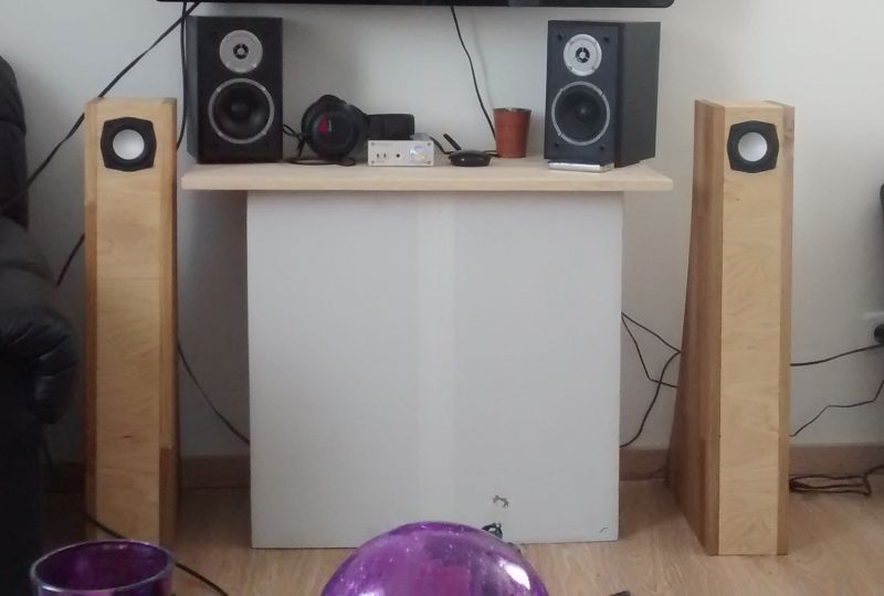

Chris & i just spent the afternoon playing with REW and the miniDSP.
If you are lucky Chrios will post some graphs.
Basically the FF85wKeN in FH-Lite was close to ruler flat from 500-9Khz, with some room humps and dips below that. Top rolled gently down some dB by 20KHz.
woofer is the brown Trianguaklr columns/wedges in the back.
Bass in room at teh listening position, produced bass down quite low, into the 40s. Adding the woofer did not ad dmuch extention but boy did it bring authority.
dave
dave
Frustratingly, the entire batch of this afternoon’s multiple REW measurements seemed to have gang aft a-gley, and I’m not sure when another traveling road show can be arranged.
All that I can say is that the little FF85WK still sounds quite engaging, and an SDX7 per side certainly adds some heft and authority to the bottom couple of octaves.
