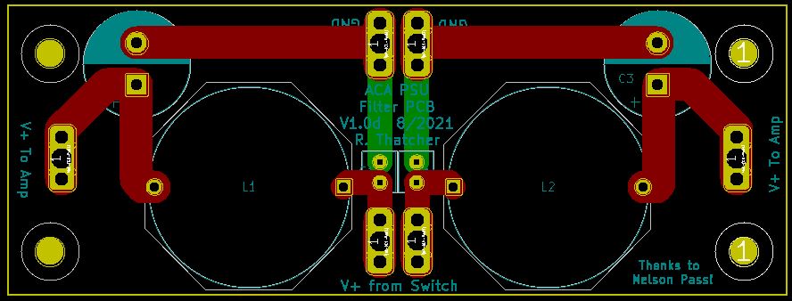

This is a group buy for Amp Camp Amp (ACA) CLC Power Filter PCBs + Parts Kits.
The idea is inspired by the recent Sony VFET P-Channel amp power supply filter. The concept is a low pass filter designed to filter out any hi frequency hash/trash from the SMPS power supply.
This board is designed to be an easy retrofit/drop-in to the chassis. The mounting holes align with existing slots in the bottom of the chassis. Wiring is also simple. Add a wire from the ground "bus" wire at the back of the amp to the filter board. The red wires from the amp boards get cut. Amp board wires connect the "V+ to Amp" connections. 2 short wires from the switch connect to the "V+ from Switch".

There was only 1 group buy. You can now get boards fabbed if you like. Gerber files are posted in posts #136 and #137.
Typo on the schematic. ACA uses a 24V PSU. No need for 50V caps. Go for 1,000uF 35V. I used the same series of caps that were called out in the store's P089ZB kit. Nichicon UHW or Kemet ESH series.

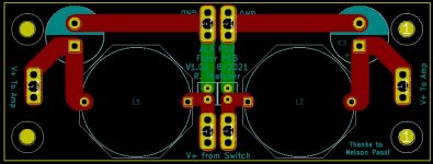

Craig - here's a version that can work for dual SMPS. I can fab these when I order more boards. All you need is one extra Wima 0.33uF cap. This could also be used with a jumper wire between V+ from amp connections and another jumper between GND connections for single SMPS applications.
Craig - put Option (A,B,C, or C) - DUAL SMPS for what you'd like.

I have you down for 1x Option B Dual SMPS (same as 2x Option A...)
To be 100% sure... Please confirm you have 2 ACA chassis and 4 SMPS supplies. If yes, then you're covered
Yes, have 2 ACA chassis and 4 SMPS. Am assuming that the revised board will handle one dual SMPS ACA and that 2 of them will be needed for both. So, is this 2X Option A (dual smps) or 1X Option B (dual smps)?

1 of these new boards per chassis in your case with Dual SMPS. Left side of the board for 1 SMPS/Amp Board, right side of the board for the other. It's 2 independent filters on one PCB this way. So I'll keep you down for 1x Option B dual smps.
