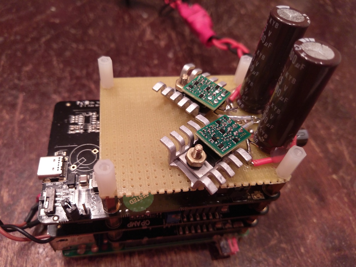

On cooling, the best thing you can do is to power your RPi/Katana stack with 2-3 5V supplies, one for the RPi (or USBBridge Signature if you have one), another for the Katana Isolator if you have it plus Katana DAC board, and a third one for the Katana Microprocessor Board, combining the latter two if you wish, but make sure it has sufficient current capacity. Then use a separate +-15V supply to power the Katana Output board so you can turn off the +-15V supplies on the Microprocessor board. The main heat-producing parts in a Katana are the DC-DC converters that produce +-15V from 5V to power the Katana Output board.
During my early testing of the Katana I was concerned about how hot it got. My eventual setup using a separate +-15V supply runs nice and cool, very little heat produced above ambient (confirmed that this evening). While the discrete opamp stages do run Class-A, at that signal level they don't produce much noticeable heat.
AND a bonus to my ears is the improved sound-quality.
Of course you'll want well-behaved +-15V supplies to make sure you don't kill the now-irreplaceable Katana Output board. I use a simple DIY'd +-15V raw DC supply into a +- pair of Sparkos discrete regulators. Regulators from Belleson or NewClassD should also work well, I've used them before in other similar applications to good effect. I don't have personal experience with other commercial or DIY options for this application.
An option I haven't tried yet, but plan to do so before I retire my Katana stack, is to use Ian Canada's LiFePO4 supply's 2 13.2V rails configured in +-13.2V to replace my DC-connected supply. Of course for this to work effectively, you need to do a bit of DIY work to bypass the pre-regulators on the Microprocessor board that feed the Output board as they won't regulate fed those voltages. OTOH, in my setup with the Sparkos regulators, bypassing those pre-regulators was a nice sonic upgrade to my ears, as was bypassing the inter-board connectors, all detailed in some previous posts as I remember.
AND yes, as good as it sounds, I am slowly moving to replace my Katana stack with the latest Ian Canada stack, which when coupled to a VG output stage sounds better to me than my Katana setup. I am currently using Ian's OP861 output stage, but I don't see that he has released it to general distribution. His IVStd stage with good opamps (I prefer Sparkos or NewClassD Ultimate discretes, with OPA1612's close behind) or a good transformer output stage work well.
Of course, that comes at a price... the Ian Canada stack costs a bit more than what one could get a Katana stack back when they were available.

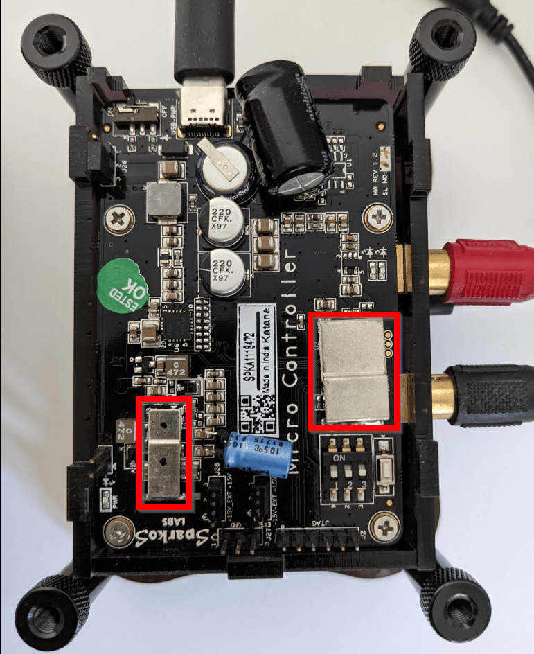

@chris14
I havn't checked the opamp board yet as it is difficult to reach. Just noticed the heat at the microcontroller board at the top.
@Greg Stewart
Thanks for the hints. Up to now I'm using only two power supplies, but I have a third one which I could add,
However I don't have a +/-15 V linear power supply (yet).
I noticed that the two red marked silver parts are getting very hot. The one in the lower left part of the photo is even hotter than the other one.
Will it lower the temperature when a +/-15 V power supply will be connected?

Chris808,
The larger metal plate you have circled is the heatsink for the microprocessor. Heat should not change at all with a +-15V supply. OTOH, mine (as well as I can reach it) just barely feels warm.
The smaller metal plate is the heatsink for the DC-DC converter that provides the +-15V power. Of course mine is off, so cold, but it is as I remember the main heat source when running. As @chris14 mentioned, you can see how much cooler it will run by adding the +-15V supplies by turning off the switch next to the Microprocessor board USB-C connector. I would do this with the power off to the Katana stack, power it up for awhile to check (with your amp off), then power it down to reset the switch on. Just being cautious around the now irreplaceable Output board.
When you do this, the Microprocessor should stay about the same temp, the DC-DC converter should go cold. The black square chip near the smaller metal plate may also get cooler. It is a regulator and I believe it is a preregulator for the DC-DC converter, but I do not have the Katana schematic.
My experience is that adding a good +-15V supply to the typical 2 5V supplies used by most Katana users will not only lower the heat, but also as long as you use a good supply make a substantial improvement to the SQ. Read my posts on this in the older Allo Reclocker thread and at the beginning of this thread. Before the separate +-15V supply, I felt the Katana was roughly comparible to the orginal Boss, but not quite as musical. With the +-15V supply added, it was significantly better (in my setup, to my ears).
A +-15V supply, at its most basic form, is a center-tapped transformer, 4 diodes as a diode bridge, 2 main filter capacitors, 2 regulators (along with any components that may be needed to set the regulator output voltages, though many are sold pre-set), and 2 regulator output and possibly 2 input capacitors. The one I built added an AC filter cap and a transformer ringing suppresion filter, but those are not required. It was fairly simple to DIY and I just did point-to-point, no PCB, though I used a piece of perf-board to mount the regulators, their input and output filter caps, and the connectors to make it easy to integrate into the Katana stack.
I can post pix and more info if you want.
Also there are links to various good-quality commercial options in the first post of this thread.
Let me know how I can assist.
