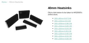

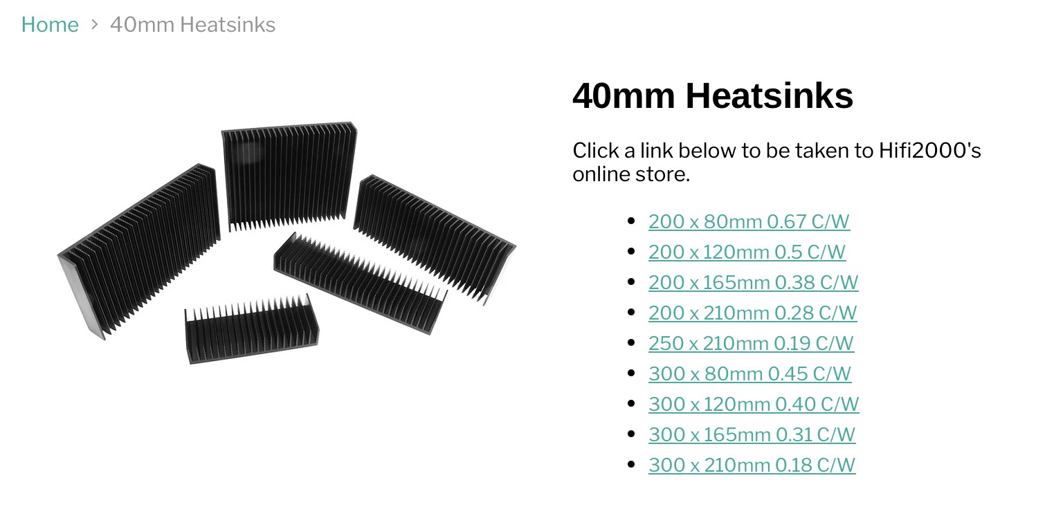

Hello...
I am bitten by a non-standard idea, but...
Does anyone ( @Gianluca ?) know wether the Modushop Heatsink 200 X 40 H 210 mm (5U , here ) really has a temperature coefficient of 0,28 C°/W ?
I'm not sure because it's part of the 5U 400 which has 2 Heatsinks per side... Not sure because the complete chassis does not declare it's TC ...
thankyougrazie!
Hi
The datas are given per heatsink and i would trust them
For 400mm you just have 2 heatsinks per side,so an rough equivalent of 0.14c/w if you spread your transistors to use both heatsink. See how many transistor you will put per heatsink, it makes it easier ( at leat for me)
Of course thermal dissipation in front panel or else is not taken into account
