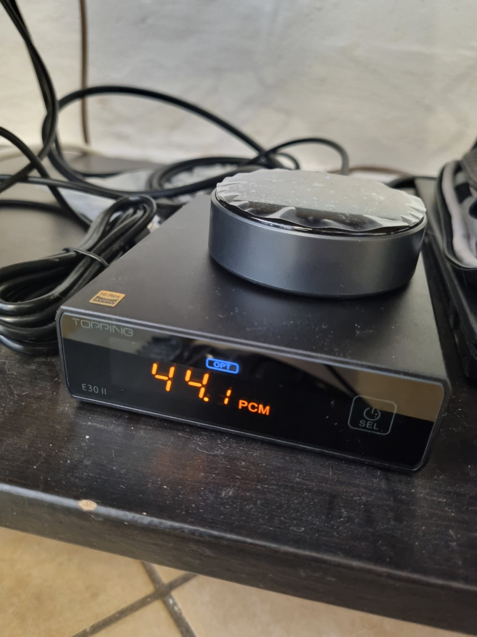

Hi guys, would appreciate any help.
I have a Wiim mini connected via optical to my Topping, which in turn is connected to my active speakers.
Even though I have selected Dac mode in the topping menu, and saved the changes, the screen appears to be indicating that it is still in preamp mode (PRC).
This is on the screen while playing music.
I'm very confused, maybe someone can help.
Many thanks!!!!!

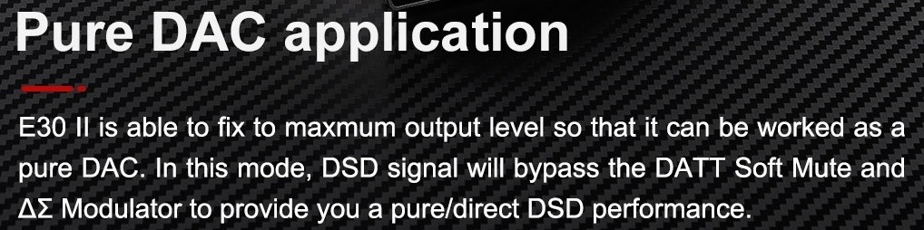

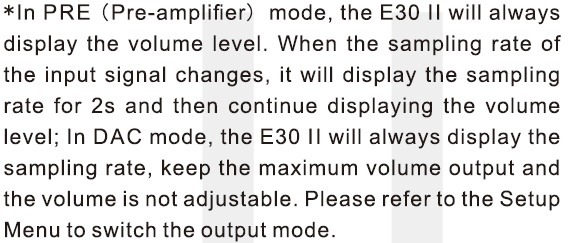

The manual says otherwise. From the OP's image it looks like it is in dac mode.Are you sure the pure DAC mode isn't strictly a DSD thing?
Thank you for your help. It appears that i misunderstood the user manual (which to my mind was really really really poor, I mean cmon it looks like it was chatgpt translated from Chinese and illustrated by a chicken with brain damage, not what I expected for the otherwise great gear quality and pricetag). In any case, problem solved, thanks!!!!
