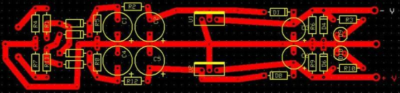

Anyway I have made a pcb design based on the http://www.hagtech.com/images/powersupply.gif image.

costiss said:
if u are intending to design a pcb for this, have the traces much thicker.. especially for the ground, you should build a ground bus ca 1cm thick, so that you dont have any stray- loop currents through your pcb..
OK, thanks!!

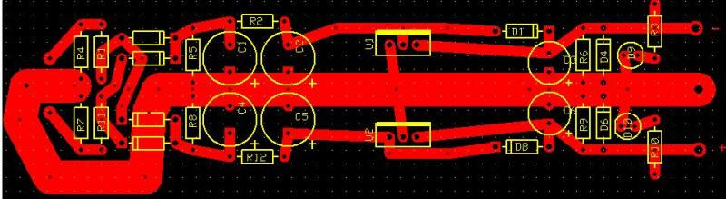

I have redone it with a 6.38 Ground, its the biggest expressPCB will do and if it was bigger it would be tricky to fit under the diodes.
