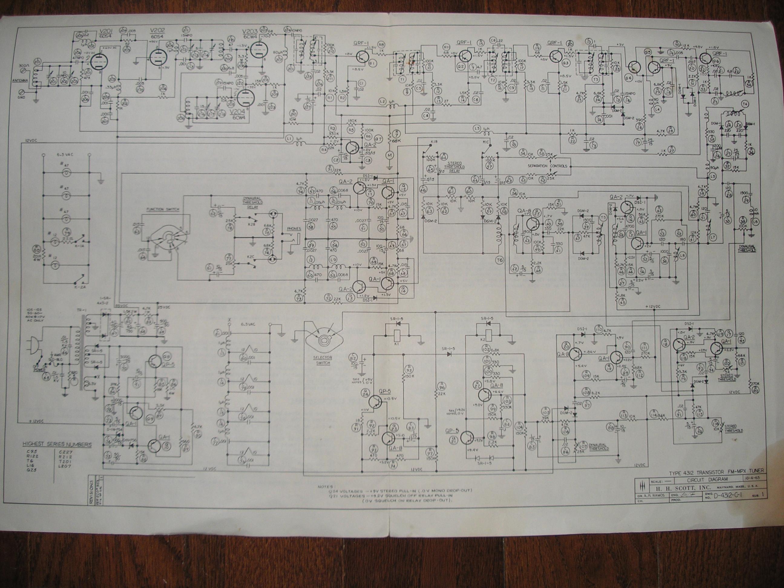

So the tuner was working fine, but now the left channel is weak. It doesn't appear to be the output stage. I am possibly thinking the addition/subtraction stages but these things are greek to me. Mono sounds great, just when I pickup Stereo the left channel is very weak.
Here is a schematic if anyone can point me to the correct section to troubleshoot and give me some tips. I'm not a tuner guy but I do vaguely understand the concepts.
Must be somewhere after the FM detector (area of T4) forward, in the multiplex circuit,
or audio output. I'd first try replacing all the low voltage electrolytics in those circuits,
they're due anyway. Don't mess with the alignment.

I would check the diodes in the stereo demodulator output T6 as well as the subcarrier recovery circuit T5. There may also be one or more errors in the schematic, C45 vs C43, and I believe there is supposed to be another diode in series with R62.
The DGM-2 can be replaced with schottky switching diodes if they are bad.
Despite the similarities to a TDM demultiplexer it's actually a balanced demodulator with matrix. The outputs are - (R-L) and +(R-L) which when added to the R+L signal give you respectively 2L and 2R.
I have not worked on one of these tuners so can't say for sure, but I would look at the audio levels at C43 and C45 with a scope, they should be approximately the same.
There are a number of electrolytics in the stereo demodulator C35, C36, C37, and C42 which at this point should be replaced - that's where I would start.

Check K1B and K1C relay contacts. I don't know which one is for the L or R. The schematic shows it in mono mode. In stereo, L and R outputs are taken from the diode matrix, the diode in series with R62 is indeed missing on the schematic.

Today I plan to check the diodes and caps around the stereo demodulator. I'll also see if the signal is the same at C43, C45 with a scope.
The signals to K1 are not the same in stereo, the contacts are good and pass the same signal going to it.

The signals to K1 in stereo won`t be the same, but the level should be fairly close for most FM stereo programs. If 1 channel is significantly weaker, it should be apparent at this test location.
Temporarily disconnect R54 and R55 to isolate R52 & R53 separation controls from affecting stereo separation. There is still some stereo separation even with them taken out of the circuit. We don't know the state of R52 and R53 so by taking them out of the circuit temporarily we can better isolate the problem. Just don't forget to reconnect R54 and R55 later.
If you have a 2-channel scope, connect one channel to the 38kHz sub-carrier present between R47 and R50 and use it as your trigger. Use the remaining scope channel to look at the diodes and resistors on T6's output. Doing this will show you the MPX switching action and confirm if any of the parts are good or bad.
I have no service manual for this thing but based on my experience with tuners that used similar scheme, Q25 is the 38kHz amplifier and the 2 diodes that precedes it is a full-wave rectifier which is the 19kHz frequency doubler. Q15 & Q16 is the 19kHz amp. T6 is adjusted for maximum audio level/stereo separation/minimum THD, T5 for maximum 38kHz at the diode cathode junction, L8 is adjusted for 19kHz level/phase/separation and L7 is part of the SCA trap adjusted for minimum 67kHz. The MPX topology is a bridge-type time division decoder, it's a TDM.
As you can see, each adjustments affects more than 1 parameter so without any test equipment, you are bound to be make things worse by adjusting any of them. I'm not suggesting that you adjust any of these but more for understanding the circuit and know what to expect when probing these locations.

Kinda, I replaced C45 and C46 and still nothing when connected. But when I lift C45 off the junction of R61 and R62 it comes back. Solder it back on and nothing. Weird.

Forget about the separation control, I asked you to take it out of the circuit for a reason. To simplify things and rule it out.
Make sure that C45 is not reversed-biased. Circuit board silkcreen can be wrong if you rely on them too much. Measure the DC voltage on the individual C45 pins reference to ground.
Turn off the unit and measure R64, is it close to 100k or appear to be shorted? Disconnect C45 and C46 when measuring R64 and leave K1 relay.
The K1B relay contact can develop tin whiskers and short the connection. It is quite common if the relay's flexible metal that holds the contact are tin-plated.

The amp doesn't have any circuit boards at all. It's all point to point hand wired. C45 is as in the schematic, negative to the 10k resistors and the + to the relay. I'll measure the DC voltage in circuit in reference to ground.
R64 measure 99.8k ohms. I'll Disconnect C45 and C46 and recheck.
I'll also recheck the relay for any sort of shorts, possibly suck all the solder off it and cleanly reflow.
