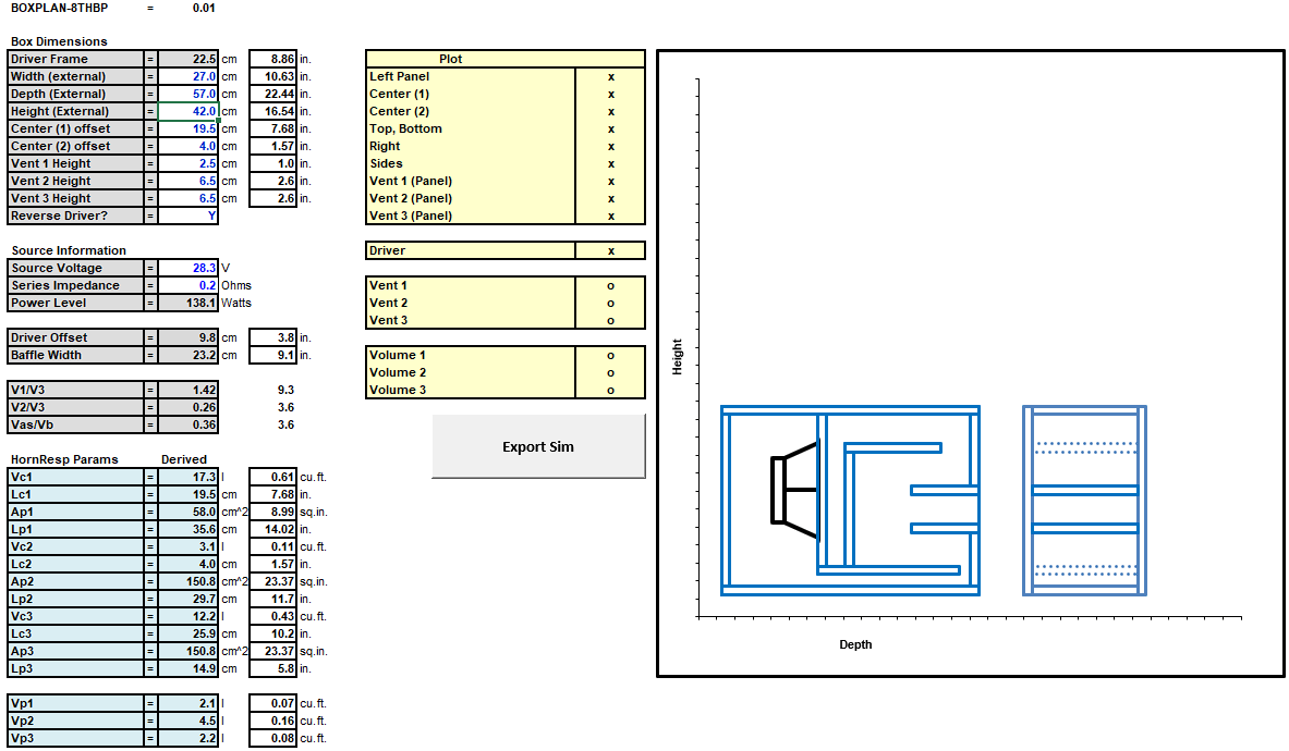

Hi David, how should I modify this record so it can be successfully imported into Hornresp? It's from a BOXPLAN workbook I'm putting together to help design an 8th order bandpass build.
ID=BOXPLAN
Ang=2.0 x Pi
Eg=28.3
Rg=0.2
Cir=0
Vc1=42.7
Lc1=18
Ap1=211
Lp1=60.1
Vc2=14.6
Lc2=7
Ap2=337.6
Lp2=51.2
Vc3=47.2
Lc3=47.4
Ap3=506.4
S4=0
S5=0
L45=0
F45=0
Sd=220
Bl=16.14
Cms=0.000217
Rms=1.42
Mmd=43
Le=1.7
Re=5.8
Nd=1
Vrc=0
Lrc=0
Fr=0
Tal=0
Vtc=0
Atc=0
Pmax=600
Xmax=7
Path=25.92768
Mass=0
Re'=5.87
Leb=0.61
Le=2.22
Ke=0.18
Rss=57.72
Rms=0
Ams=0
Comment=BOXPLAN-VBSLOT 0.01 - 2024-03-28 12:13:44

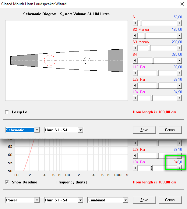

hello @David McBean
I just saw a strange behavior of the loudspeaker wizard in the TML offset port mode:
when changing to the "power" graph the L34 displays a strange number: multiplied by 10 and without the digit behind the decimal point.
for the rest everything works fine and whenever I change to another graph the number is correct again,
hornresp version 5530-240310
attached my record.
thanks once more for your great tool!
  • OP_record.txt
Hi Brian,
Required modifications:
1. Assuming that the port 3 tube length is 40 cm, insert the statement line Lp3=40 between statement lines Ap3=506.4 and S4=0.
2. Change the statement line Nd=1 to BP8S=1 for a BP8 series configuration, or BP8P=1 for a BP8 parallel configuration.
The attached BOXPLAN.TXT file contains the above changes and should import correctly into Hornresp as an eighth order parallel bandpass enclosure loudspeaker.
Kind regards,
David
  • BOXPLAN.TXT
  • Thank You
Reactions: 1 user

Thanks David, those changes made the difference. Hornresp can now read the exported sims from my 8th order BP BOXPLAN sheet.
Reactions: 3 users
You're not the only one, LOL. Since putting the workbook together, I've been trying to find a driver that the corresponding sims suggest would be a good match for the alignment, and I'm coming up blank. For decent bandwidth, going by the Bose AM5 driver specs, you need to find a driver with Q around 0.3, Fs about 1.3*Fb, Vas = 0.08*Sd (double that if looking at a single-driver solution) and a decent Xmax for bass duty.
The next update I'm going to be working on for the workbook is to allow for dual-driver alignments, and then try using it to model something like the AM5 Series II bass module (I have access to the bass drivers used in that module).

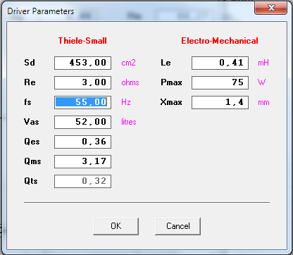

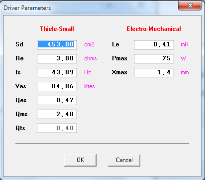

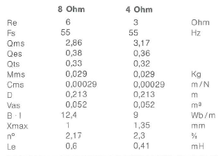

I am experiencing inconsistencies between the driver manufactures T/S parameters and what I can actually input in Hornresp.
Attachment 1 is a screenshot of the T/S parameters according to the manufacturer (4Ohm driver).
I Double Click on SD, and fill out the "driver parameters" pop up window (attachment 2)
CMS and BL are then automatically calculated but they don't match with BL and CMS figures according to the manufacturer.
Infact BL is 11.64 when it should be 9, and CMS is 1,78E-04 when it should be 2.90E-04.
If I input the BL and CMS figures from the manufacturer's (BL=9 and CMS=0,00029) all the rest of the driver paramaters are automatically updated and no longer match the manufacturer's (attachment3).
In other words, the BL and CMS figures as per the manufacturer's specs do not appear to be compatible with the rest of the driver's parameters.
This issue bothers me because it has a remarkable effect on the power response simulation.
I dont know which of the two simulations should be considered valid, the one where the BL and CMS are automatically calculated or the one after replacing those values with those provided by the manufacturer.
