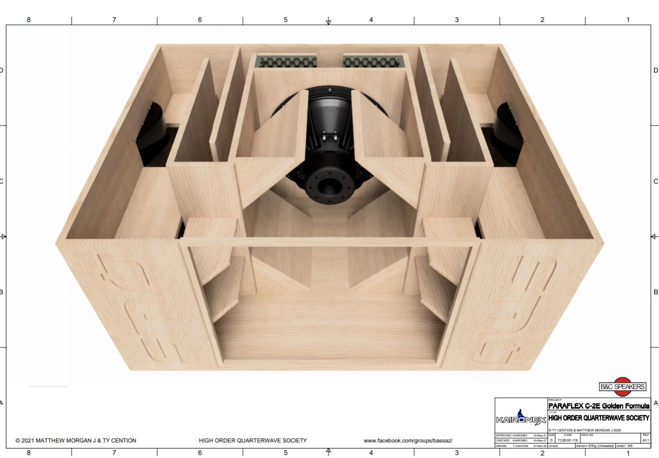

No built paraflex enclosure has a horn section that look like the CONical picture below.
I was not asking you to change the default horn profile. However, it would help new HR users learn the difference between what is modeled and what is built. It also prevents folks from accusing HR for their built enclosure not measuring right.
Good thing Filter Wizard doesn't default to Bessel! Bessel is before Butterworth alphabetically.

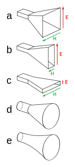

Having two parallel straight sides does not automatically qualify as being a PAR segment. If the two other sides (given a rectangular cross section) are also parallel, it doesn't matter what kind of segment is specified, because they all behave like straight tubes in that case. If the two non-parallel sides are straight and expanding, the segment will be PAR, but if they expand in a more complex way (i.e. not straight lines), the shape will be CON, BES etc.
No CONical horn profile has parallel walls. ALL square and rectangular enclosures are parabolic due to the 2 parallel sides.
B and C are the only 2 horn profiles that can be folded into a square or rectangle.
B & C = PARabolic.

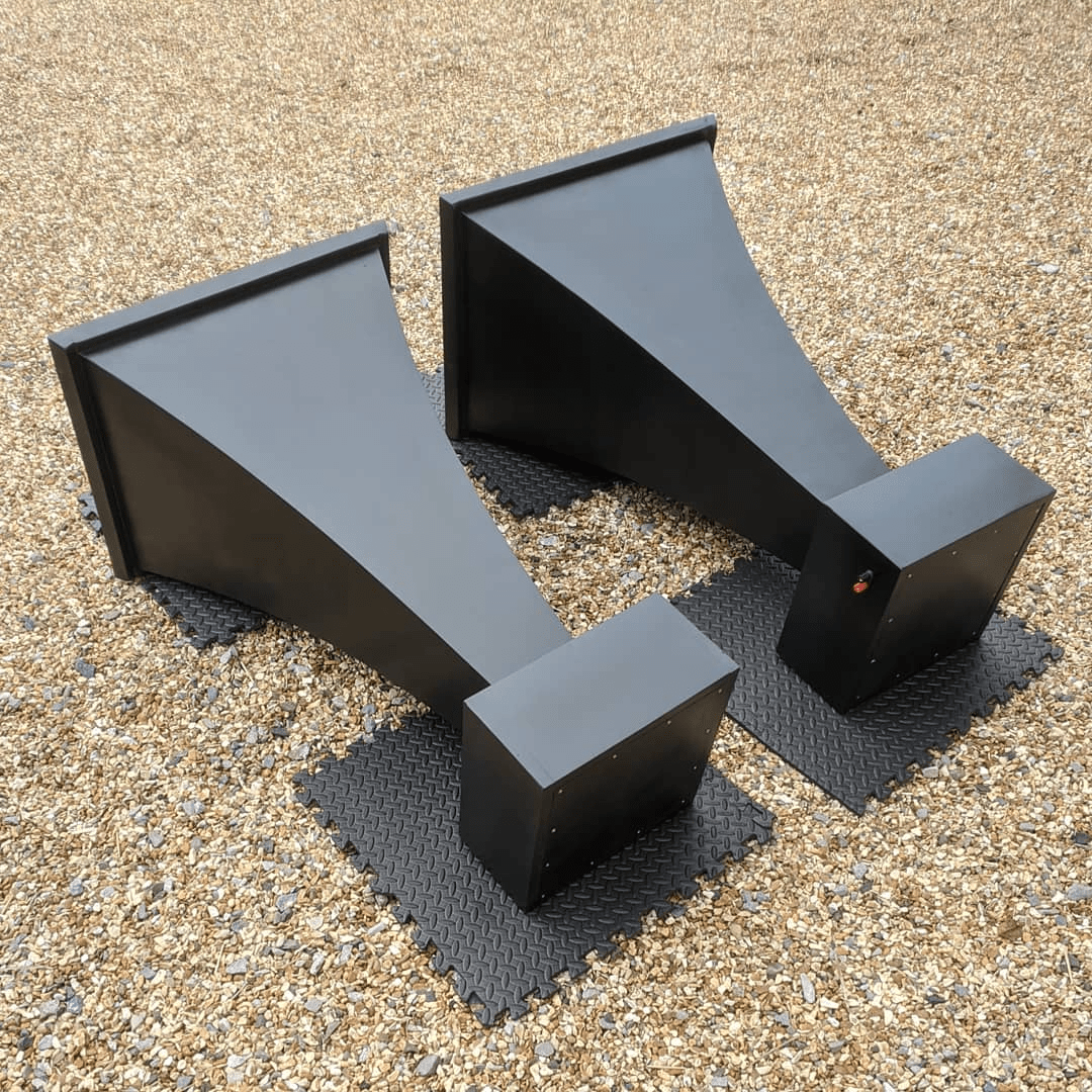

Just to clarify, your CONical picture shows two exponential horns, not conical ones.
The paraflex horn designs that I am aware of would be modelled assuming cylindrical segments, so either Con, Exp or Par could be used.
The image below shows an exponential horn with two parallel sides in a rectangular enclosure. It could just have easily been a conical horn.

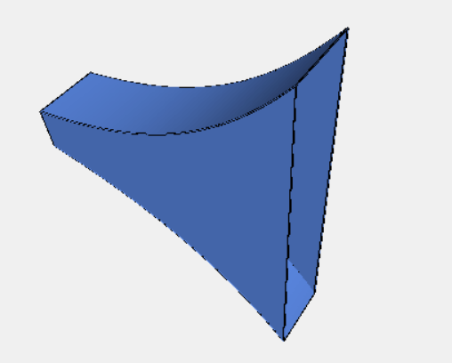

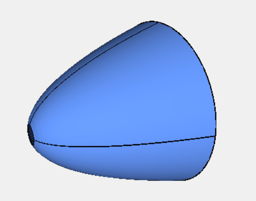

If we're talking about the geometrical axisymmetric conical horn, I agree, it does not have parallel walls. If we're talking about a horn having the area expansion of a conical horn, it can have parallel walls. As can any other expansion law.
A rectangular enclosure is only parabolic if it has two parallel sides and and the other two sides are expanding linearly, i.e. the area expands linearly with distance. In the low frequency domain, the only thing that matters is the area expansion. It so happens that for a geometry like your figures B and C, the outer part of that geometry has an area that expands linearly with distance, and the appropriate model for such a segment is parabolic. The inner part has no expansion, and the type of segment does not matter, because all types will behave the same when there is no area expansion. They basically default to straight ducts.
This is not about defining types of enclosures, but about using the mathematical model that best describes the geometry you have. I.e. simulating what you actually build. For instance, the horn in the image below has exponential area expansion, but two parallel sides. It would not be accurately modeled by a PAR segment. You could either use an EXP segment, or a series of PAR segments. (But in reality, this example expands so quickly that you need to take the curvature of the wave fronts into account when modeling it.)
BTW, did you ever wonder why it is called a parabolic segment? Because if you make an axisymmetric version of it, the walls have the shape of a parabola. See image below. :) You can see that in the Hornresp schematic too, which displays the axisymmetric version of the design. So the name indicates that PAR segments are not limited to rectangular enclosures with two parallel sides.

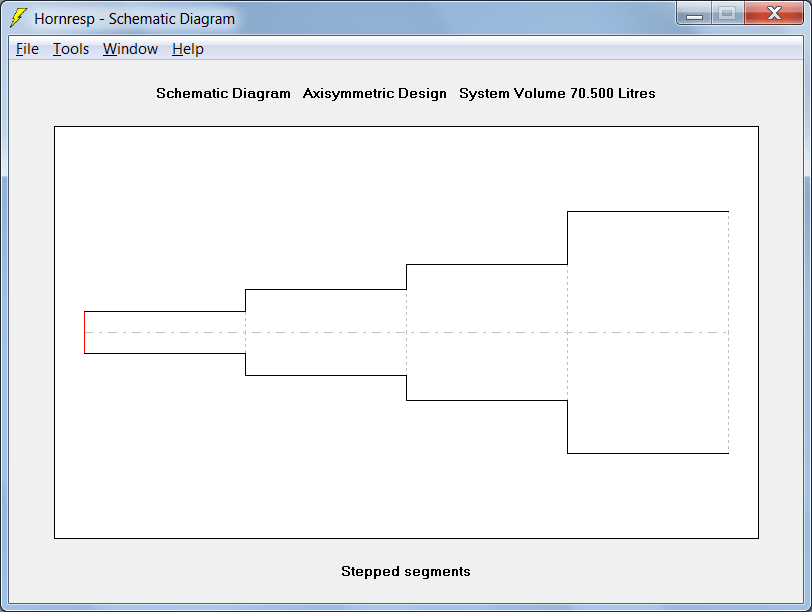

See typical example below:
Are you saying exponential because the spread between stepped segments could be
S1-S2 = 2" width,
S2-S3 = 4",
S3-S4 = 16",
S4-S5 = 256"
in that enclosure?
Reactions: 1 user

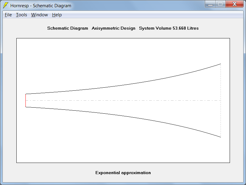

Four stepped cylindrical segments as shown in Attachment 1 can be simulated using either Con, Exp or Par. Because the segment throat and mouth areas are the same, the flare rate for each segment is zero and Hornresp doesn't care which profile is specified. My personal preference is to simply use Con in such cases.
The four stepped cylindrical segments could be roughly approximated using a single exponential segment as shown in Attachment 2, if required.
