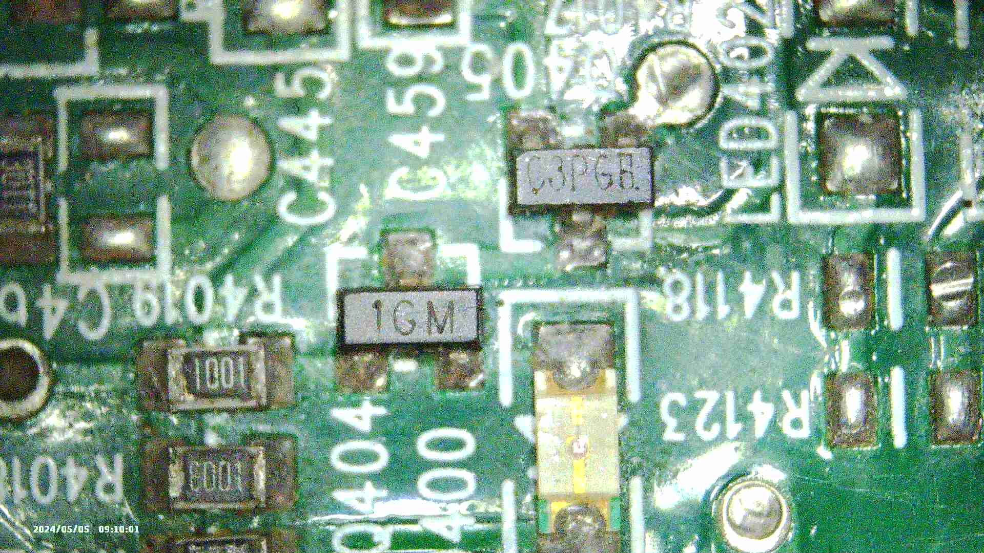

That FET is used to clamp the input of the optocouplers and the 6500 doesn't use optocouplers to drive the outputs. This looks like the 7801 board (there is a 7801 page in the tutorial if you didn't find it already).

I found a bad transistor/diode? the marking on the pcb is D400 and the marking on the transistor/diode is I5H T.

1. I looked under "Diodes" in your book but it didn't list this type. (if it is a type diode)
2. How would i test it? I said it's bad because it's open on all 3 points.

The mark is actually: 5H
They used different diodes but what's important is that you have a diode connecting the base and emitter of the top A42 in the diagram.
The datasheets are under:
MMBD4148.-datasheet.pdf
Diode marked 5H - MMBD701.pdf
