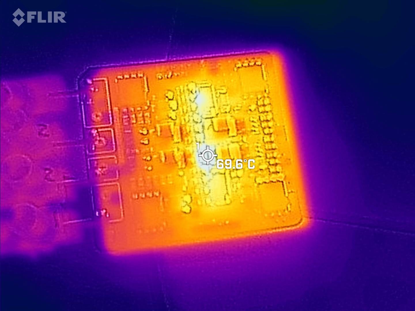

Saligny Universal tested - over the specs - at 90Vac in, driving a 1150W load. 127Vdc out and 9A continuous.
Internal regulator start to get hot. Mosfet transistors, located in board corners, are cold.

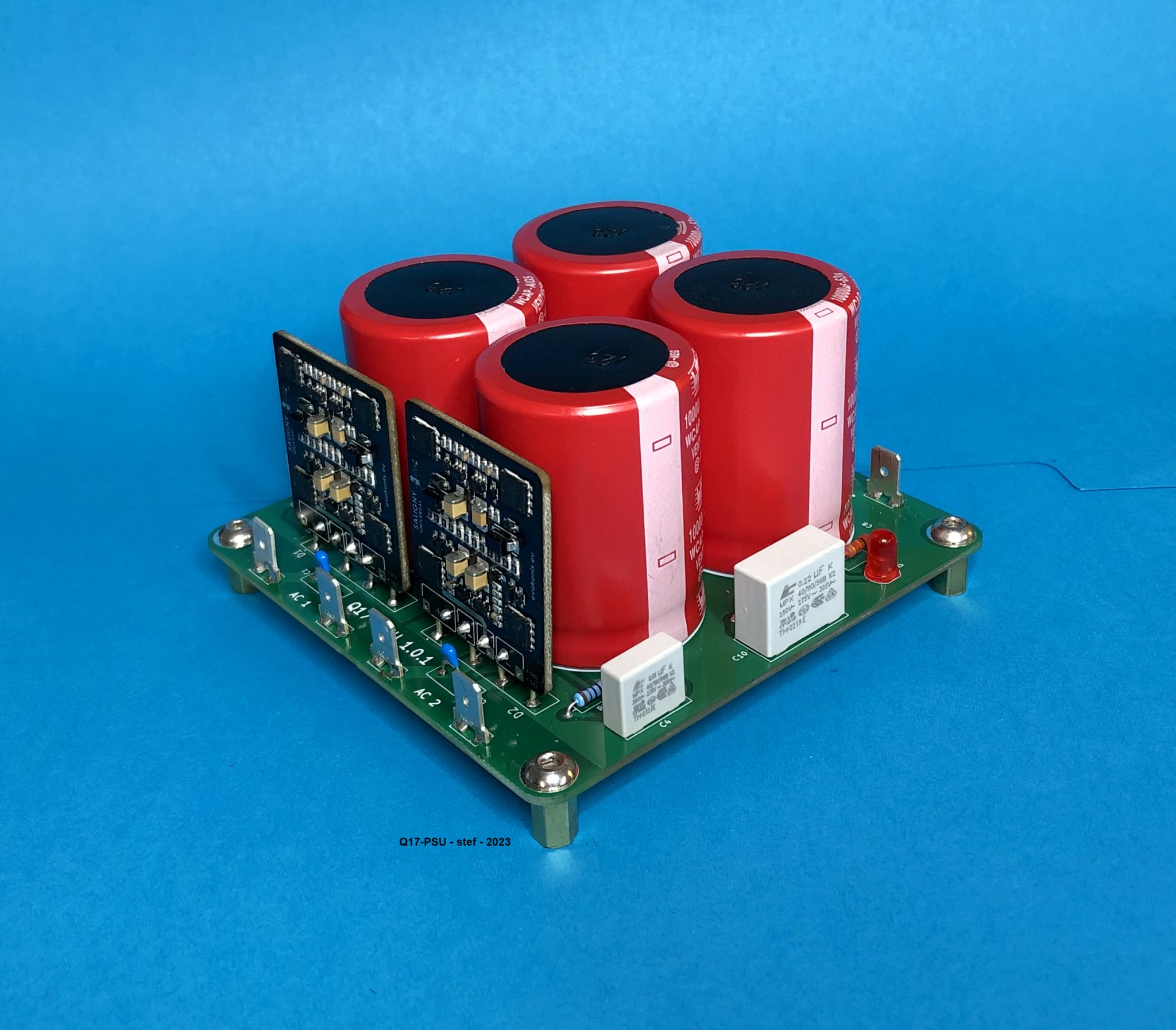

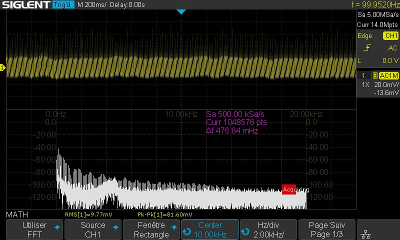

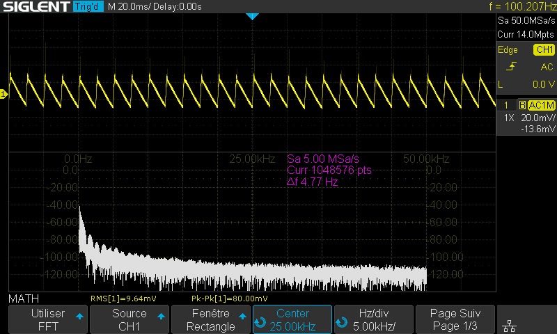

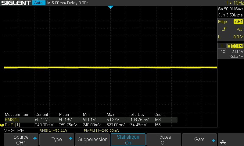

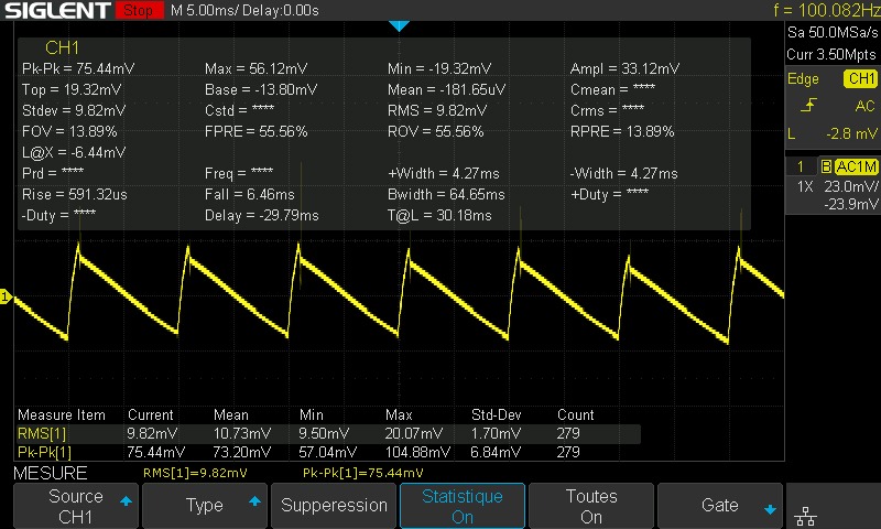

Hello,
I made some measurements of the Saligny Universal bridges mounted on a board that I developed for Class B amplifiers.
The power supply outputs 50Vdc with 1.5K Ohms resistor load.
Stef.

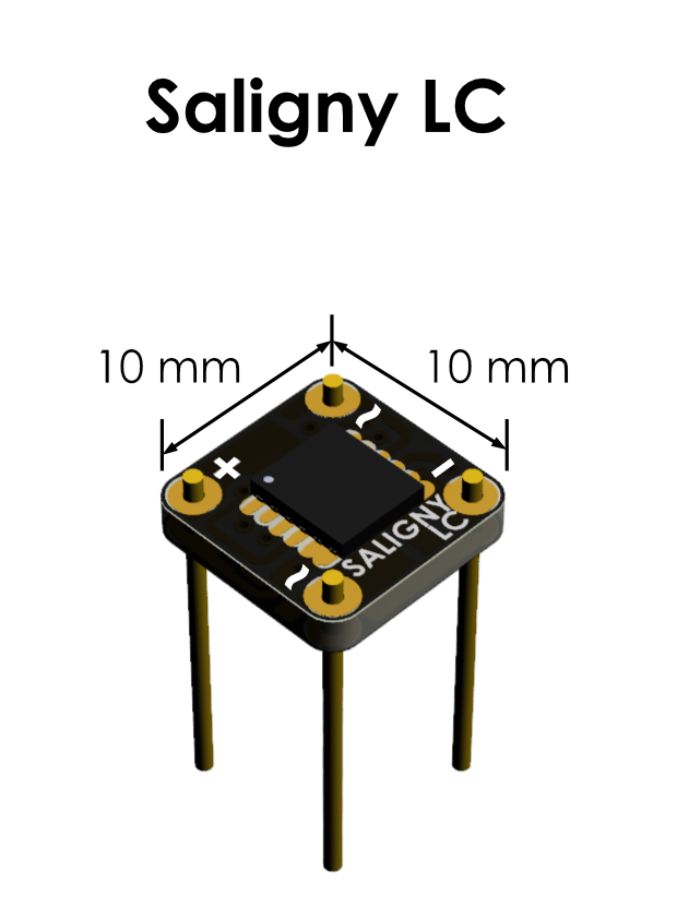

@iTiberius
I installed a Saligny LC but I have a problem under load.
I use it to feed an LM317 and at no load I have 9,7 Vac at the rectifier input and puts out just over 13 Vdc.
When loading the 317 with 0,5A the transformer drops to 9,3 Vac and get only 9,2 Vdc out of the rectifier.
I know the LC is specified as 6-50 Vac so my 9,3 Volt should be sufficient.
To limit the heat dissipation on the LM317 (need 5 V out) I already installed 2 resistors after the recitifier for some voltage drop but when I only get 9 Vdc under load I could bypass these resistors.
My questions are:
Can the component tolerance at the LC have the 6Vac requirment being higher in real life like > 9,3 Vac ?
If this creates a dimming effect and the conductivity of the LC drops the 12 Vdc to 9 Vdc will it still have the same benefits in reducing the noise and ringing etcetera ?
If so I will bypass the resitors and be happy anyway :)
