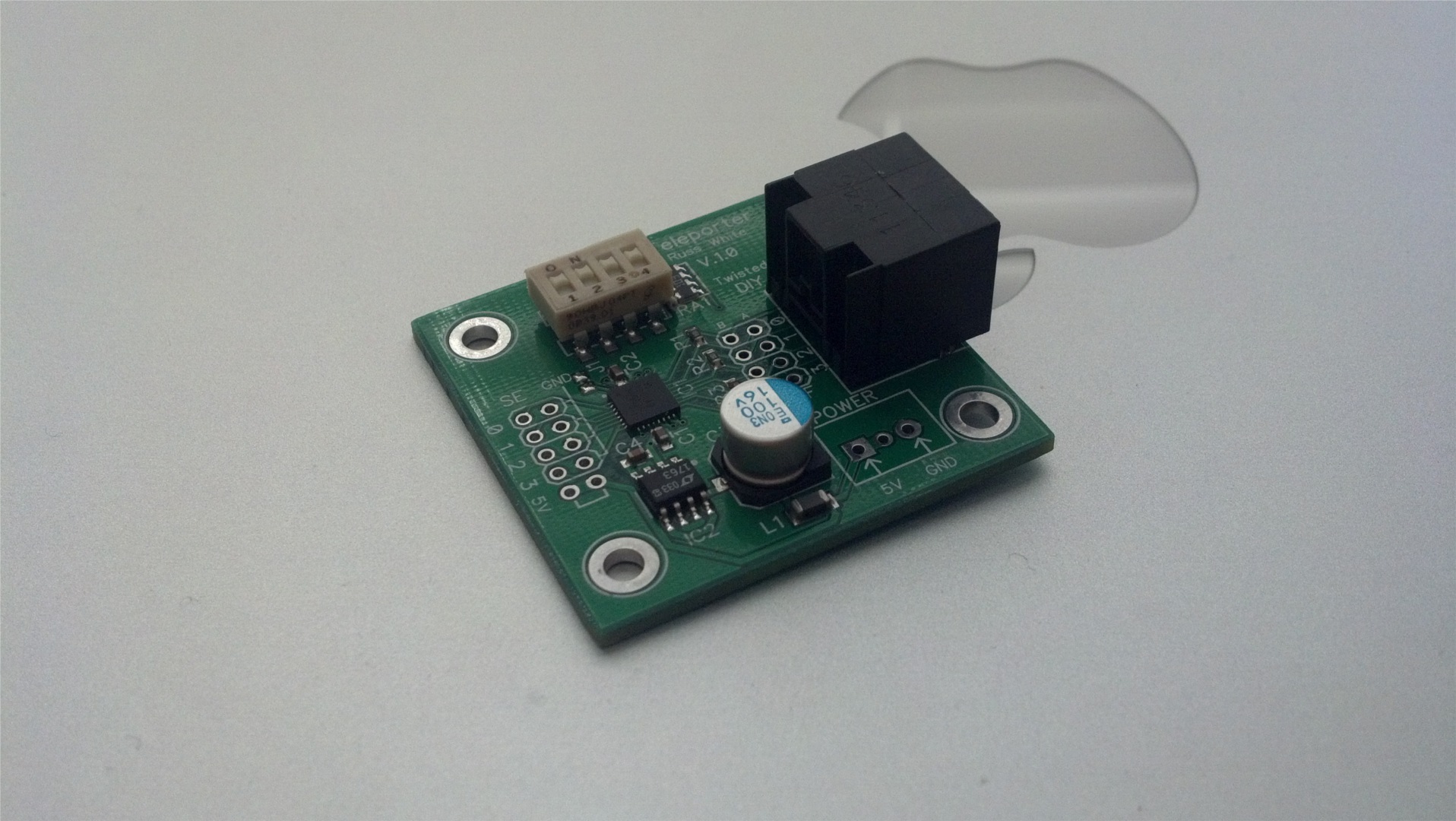

Hello folks.
As many of you know I am working on a killer USB board and one of its features will be LVDS output of the PCM signals.
Well to support that I needed to test that it would actually work at the very high frequencies I was using. Well I am happy to report it absolutely does work, and extremely well!
In the process I created a little module that is also useful for many other applications. That module is call "Teleporter" and here is what it does:
  • It is a LVDS transceiver. It works in LVDS mode1 and mode 2. The LVDS channels are properly terminated.
  • It has both a .1" header and RJ45(for CAT5) connector.
  • It has an on-board low noise LT1763 regulator.
  • It has 4 independent LVDS transceiver channels that can each be configured as a transmitter or receiver.
  • Each channel either has TTL input (in transmit mode) or TTL output (in receive) mode.
You use two(or more) of these modules for a complete application. One at the source and one at the DAC or some other receiving device. They are designed to be panel mounted using 90deg tabs on the PCB. We will probably proved some with the kit.
NOTE: Please install (or short with solder) J1 for normal (type 1) operation where two teleporters are used as transmitter and receiver. Omitting J1 allows for type-2 receiver mode.
See section 3.2.3 here:
http://www.ti.com/lit/an/slla108a/slla108a.pdf
Here is how I have used it so far:
Also if your board has a J2 position - that jumper connects the jack shield to GND. It is recommended to close J2 if you use shielded CAT5/6.
- DSD/PCM output from a modded Denon SACD player to Buffalo III.
- USB audio to Buffalo III. (up to 384khz tested so far with 256fs master clock)
I have tested it carrying a signal up to 100Mhz(master clock) and it worked flawlessly so far. It *should* be able to handle up to 125Mhz, but I have not tested that yet.
We will be making these available very soon. They will be fairly inexpensive but I do not know the price just yet. Brian and I need to work out the costs.
I am listing to an XMOS prototype at the moment with all of the PCM signals including the master clock being fed to the DAC via the interface. :) It sounds awesome. What is more incredible is that I have been using as much at 100ft of CAT5 with absolutely no detectable ill effects.
Now there is an inexpensive and practical solution to moving PCM/I2S/DSD bits around from device to device without SPDIF or having to use expensive HDMI cables (which may not come in the length you need). CAT5 is much easier to work with and make custom lengths.
It also provides isolation in that there is no shared ground wire. You actually could use HDMI cable if you wanted you would just need to build an adapter, but there would be no advantage to doing so.
I routed the CAT5 connector so that the CAT5 twisted pairs are used for each discrete signal. This allows for more ideal noise rejection.
Now I need to beam up some more music. :)
Cheers!

Now I can get started on taking the DSD signals out of the Denon player I have sitting around for a long while. My main concern was the length of the wire from the player to the DAC.
Other similar implementations seem to use a GMR isolator (NVEs il715). Did you figure there was no need? That would add $20 to each board though...

Not any need for it at all. As I said, it is already isolated. In fact adding something like that would be more harm than help since there is no GND to complete the circuit between source and the target. It is completely differential signal. Also because it is LVDS it is completely immune to latch-up issues that most isolators can be prone to.
It works wonderfully in the DSD application. I can imagine many more people modding SACD players now.
One key fact is that the intent is not simply isolation. Isolation is great but the key is being able to reliable transmit and receive signals up to 250Mbps(125Mhz). The NVE il715 for instance is only a 110Mbps part. That means it is really limited to about 55Mhz signals. Not nearly fast enough for what I want to do. Or rather what I have already done now. :)
