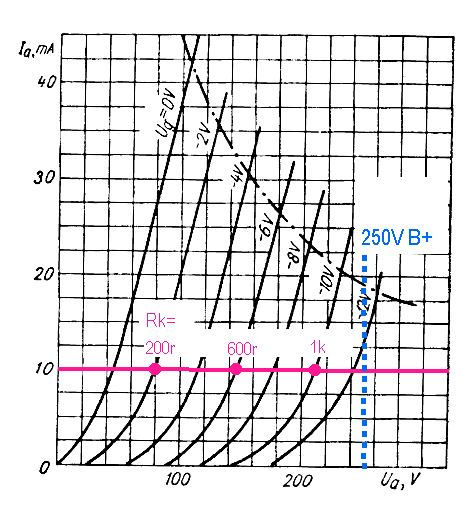

No, I mispoke. I meant 10 ma and -6 volt bias. I do have another question. I know I need to use the cathode resistor to set the bias voltage so the tube will conduct. Do I then set the CCS to the same current, 10 ma? Or should it be set to more for some headroom?
mr2racer,
For your triode with a CCS as the plate load: Set the CCS to 10 mA (many CCS use a single resistor to set the current, calculate for 10 mA, and use that resistance). Connect the grid through its grid return resistor to ground (0V) Calculate the cathode resistor, 6V/0.010A = 600 Ohms. The self bias resistor is 600 Ohms, connect the cathode through a 600 Ohm resistor to ground. Turn the filaments on, and the B+ on. The voltage on the cathode Will Be 6V (600 Ohms x 0.010A) Done.
You may or may not want to use a bypass capacitor across the 600 Ohm self bias resistor. The cathode impedance is as high as it ever can be, because the plate is loaded by an extremely high impedance (CCS). The grid resistor of the next stage is quite often lower than the impedance of a good CCS plate load.

It *really* helps to work this out on the tube curves.
I have found that most tubes rarely match the curves. High Gm triodes like the 5842 are worse case, that's why there is a pot in the cathode on the TSE amp. Every tube is different.
As said previously, the CCS sets the tube current. A 10M45 wants about 330 ohms for 10 mA, but there is a pretty big variation among these guys too. The cathode resistor sets the plate voltage. Start with something around 600 ohms, then tweak for lowest distortion, or maximum headroom, whichever is most important for your application.

On the curves a trial-solution is clear. *Assume* the "10mA" is a Given. Plot 10mA line. There's always a limit how high B+ you can get, plot that limit. Each grid voltage curve implies a plate voltage. Since a hi-fi line amp is not a big-signal thing, we can set idle plate voltage low, or high, but generally mid-way is best (and gives more leeway for bad data). Any of the RK values plotted will work.
