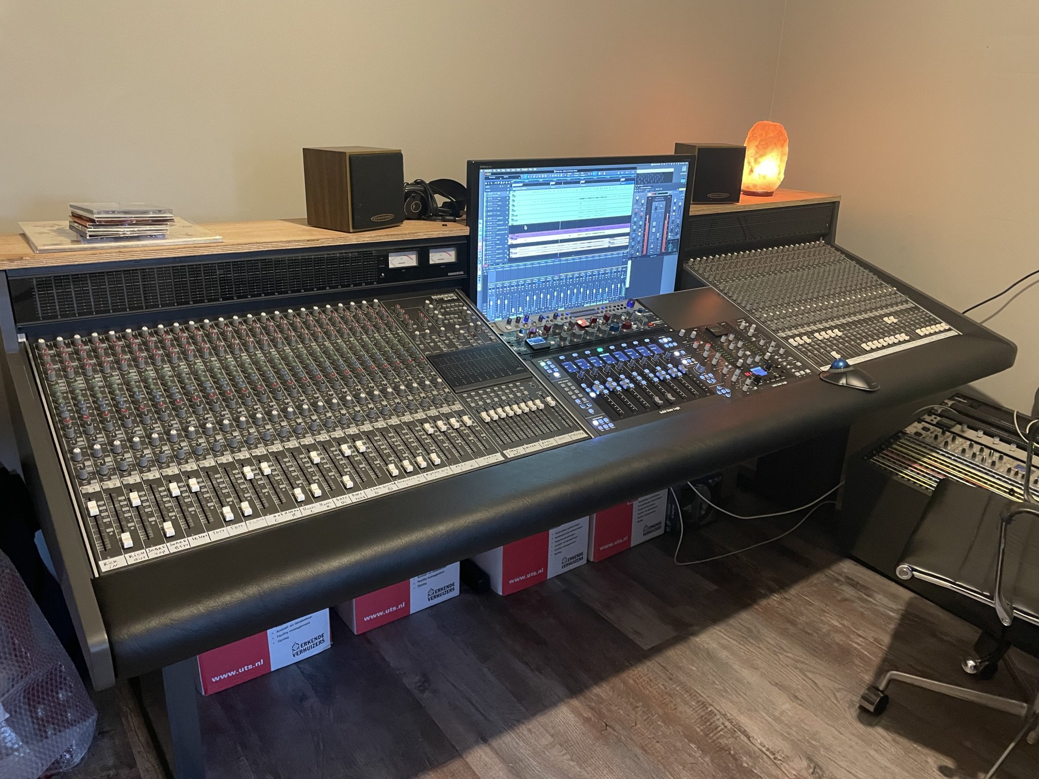

I am having a home studio Hybrid mixing desk (48 channels mixing desk combined with a Mac mini and analog converters) to mix multitracks (studio recordings) as a hobby and now want to go for Dolby Atmos (5.1.2 format) so 8 analog line level signals to 8 powered loudspeakers (Genelec 3010A).

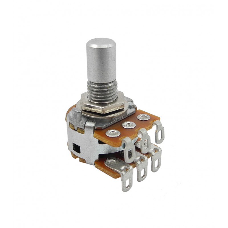

This potentiometer is a very simple solution, just the potentiometer between the output of the analog pre-amp (line level) and the input of the Active loudspeaker (line level). Would I need impedance matching before and after this potentiometer so both the pre-amp and the active loudspeaker "see" a fixed impedance? Also, I could add a switch connected to ground as a mute function for all signals (maybe best with a 8 gang relay to ground).

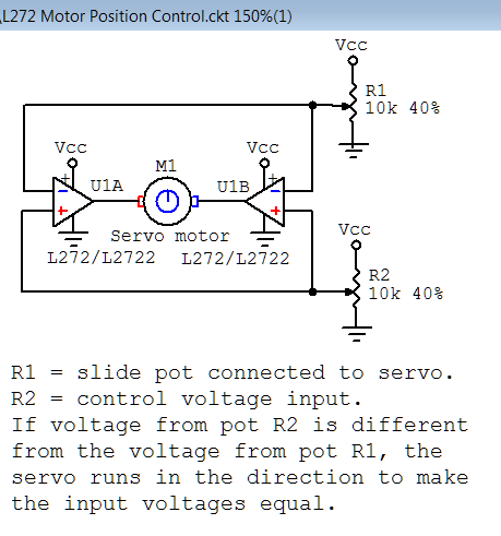

Might be i have simple solution for you, there is 6 gang motorized potentiometer from Alps. It's avaliable here https://www.conrad.hr/hr/p/alps-rk1...a-prasinu-stereo-0-05-w-10-k-1-st-442068.html
If you have 2 of them (20 euro each) and dual power opamp like L272 that costs very little, you can sacrifice 1 gang of each pot to be input voltage for opamp. I don't have exact schematic written but it's quite simple and basic diagram is in L272 data sheet.
When you manually turn one pot, opamp will turn other one until resistances of 2 sacrificed gangs are matched. I did it for 8 channel preamp and it works fantastic with only part of second delay for second pot (my hand is faster than motor).

Hi again, I found the diagram, its as simple as this. R1 and R2 are "sacrificed" gangs from 6 channel Alps pots (one from manually turned or master, second from slave). M1 is motor on slave pot. Solution will be some 40 Euro heavy... might be 50 with P&P. Gain matching is of course subject to Alps tolerances, which are not too bad as I measured under 10 % difference in resistance on different angles of the pot. That will translate in very few db differences.

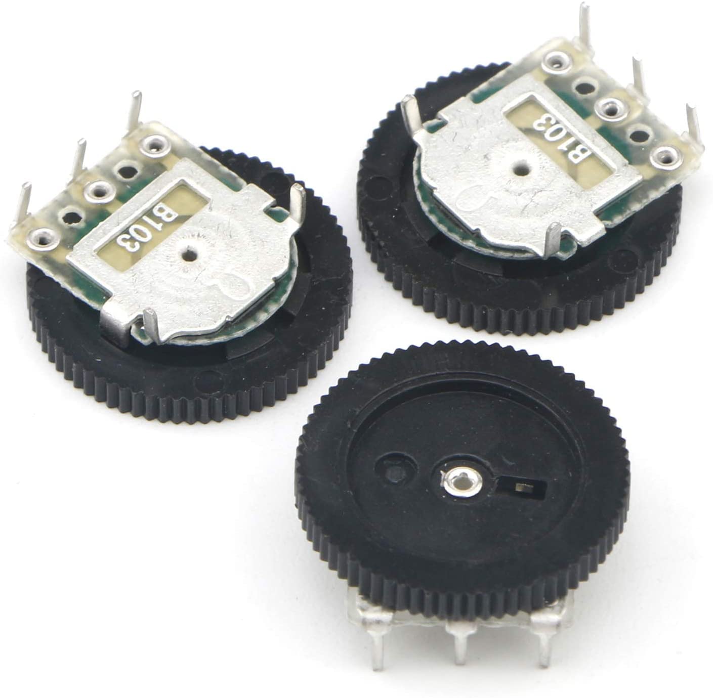

Maybe 8 pieces "Dial Wheel Potentiometer"?

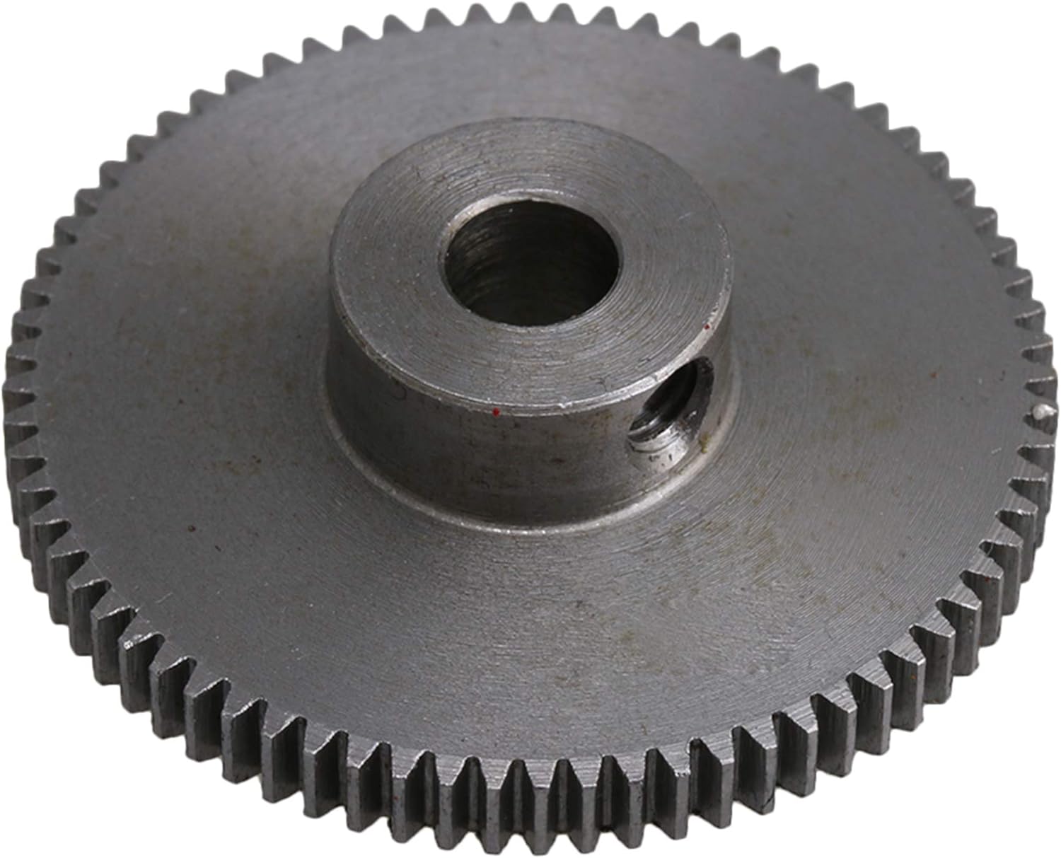

4 pieces "72 Teeth Steel Pinion Gear 6mm Shaft Hole" mounting with dual gang potentiometers.
