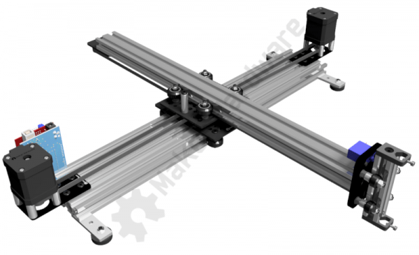

After seeing Tom's prptotype it made me think of a different approach to how the movement could be accomplished.
I now like the idea of using a Core XY belt system (like is used in drawing robots), just more sturdy and reinforced in the up down axis.
The in and out movement could use a very similar setup with linear rods as the weight of the mic is low. The mic would be attached in place of the pen.
This keeps the motors on the fixed parts of the chassis and wiring would be mostly fixed in place.
So a motor on the bottom near the floor, a motor on the top and the mic boom gets actuated back and forth. You can get high lubricity plastic bearings that slide well along those rods if you want to 2D print the rest.

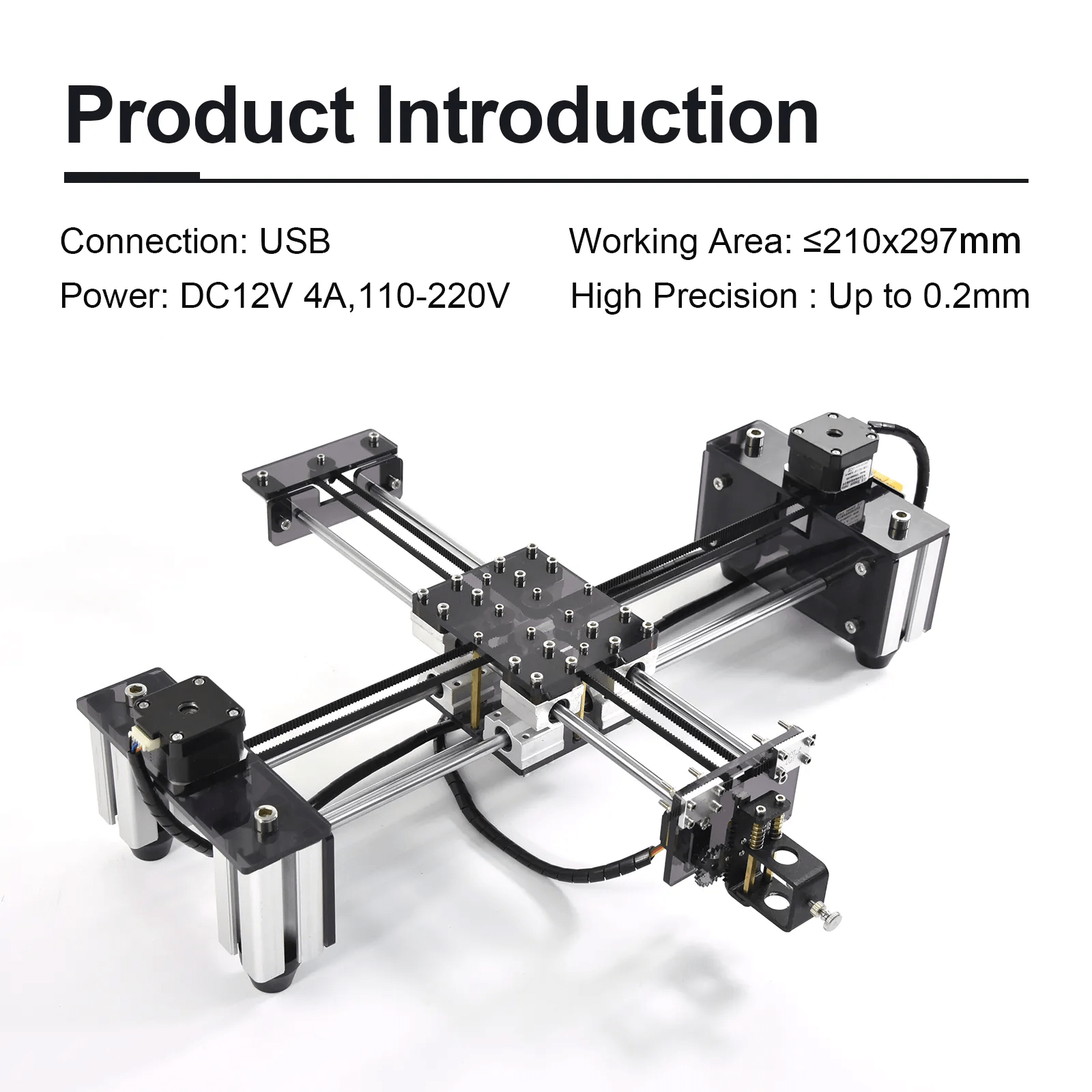

Yes, depending on which direction each motor is moving changes the motion from up down to left right or some combination of the two. Core XY is supported by GRBL as well so it should still fit within the same setup as Tom has been using.
Here is a version on a pretty low budget, I would prefer to make something more rigid, there are off the shelf linear rods and aluminium housing ball bearing slides from the usual CNC vendors.
https://www.instructables.com/Dual-Task-CoreXY-DrawBot/
There are already many designs using off the shelf parts that could be followed or altered. The scond link is about as simple as it could be.
https://makerhardware.net/wiki/doku.php?id=manuals:drawbot_v1.2
https://cs448m.github.io/assignments/tbot/
