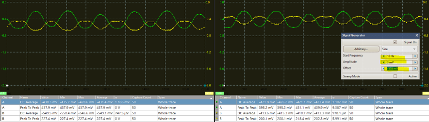

I am actually not using the signals from the servo PCB, there are 4 simple I/V converters on the rear side of the servo PCB (as said, all inspired by your work .. don't want to say I copied all your ideas :) ).
I am using the servo PDB only for the reference voltage for the I/V amplifier (power by single 5V) and the driver for the focus lens. Here I added a signal (from my USB scope) that I can change in offset (lens position) and amplitude.

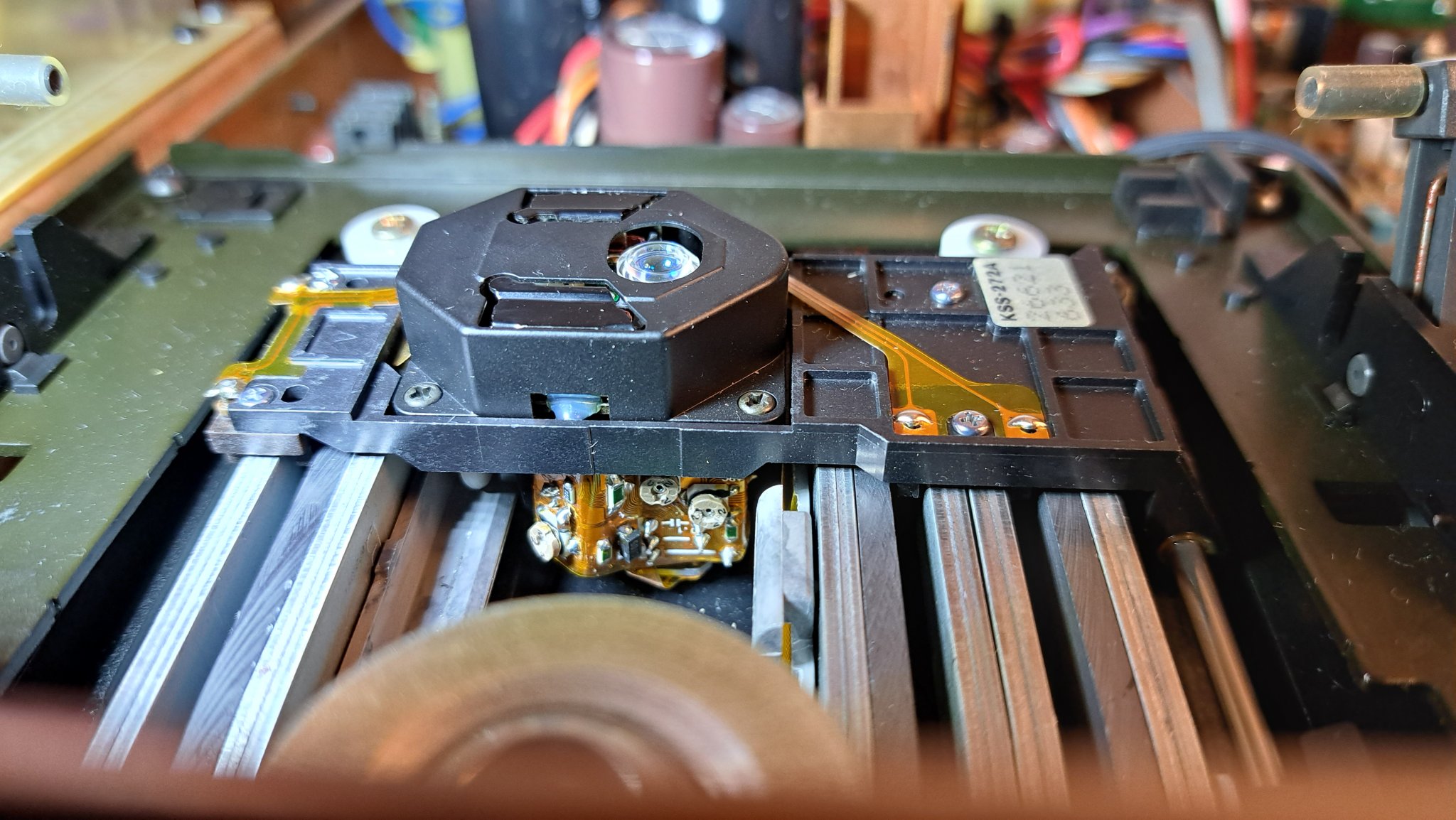

I have installed an original pickup (not 'touched' earlier) and have adjusted the 'mirror' (which was a DVD before, but it's now a real mirror glued on the DVD). That is my reference (see 2nd picture).
Now the problem really seems to be to get all signals in the center of the diodes, which is an adjsutment in the µm range. I need to improve the setup.
Anyway, I see that the signals in one direction changes differently than in the other. Not sure if this is now an adjsutment done by the cylinder lens. Need to try, but as said .. everything is so delicate to touch and to adjust.
To be continued :)

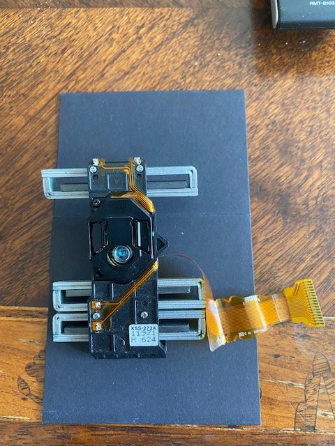

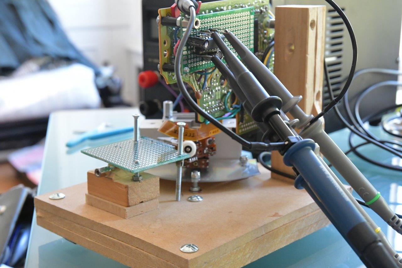

Hello. I've tried to know how to change the laser diodes in the CDs laser pickup and today finally I've changed a diode in a KSS-272A successfully.
As in other thread about the KSS-190A I said, I tried to change the diode laser and to adjust it, but it don't work. It works in KSS-121A and BU-1C, but no in KSS-272A.
For to adjust the KSS-272A, and others I suppose, you have to adjust the position of the Photodiode array IC. This is main trick.
This is the process.
1) Remove the diode, remove all the glue, clean it, blow with air under pressure.
2) Then place the new diode, type M (both diodes with common cathode), I put a Rohm RLD-78MA. Put glue, I used glue of two components. Wait until the glue is dry.
3) I change all potentiometers. Original are right, but are very hard for to manipulate. All are 2k2.
4) In the photodiode array Ic, remove the glue
5) Place the laser pickup in the mirror, with the 2mm pcb with a hole for the light to the laser.
As I said in the other thread, you force the laser ouput, extend the laser cable and cut the focus conection. In focus conection you conect a power supply(no more than 1 volt) and a low frequency generator.
6) Conect the A-B-C-D-E-F to a signal amplificator, six amplifiers in fact, and conect it to the oscilloscopes.
7) Place a piece of plastic in the fotodiode array with soft glue. It is used for to grab the fotodiode array with care.
8) Conect all, power up the CD, and find the signal. The first signal in appearing are the E-F signals. They are very usefully for to find the signal. In my case the power supply is 700mvdc and the signal generator between 21 or 23hz and between -4dbm or 0dbm.
9) Then you try to find the point like in the pictures appears, where A and C and B and D must be in phase, but 180º disphased between AB and CD. You must build a device like mine with a screew for to lock wheh yo have the right signal.
10) The signal is right and the screw lock the photodiode array for it can't be moved. Now you put glue where you retired the original factory blue. Wait until the glue is dry.
11) Now, without the screw lock the photodiode, you must confirm the signal is right.
12) Install the laser pickup and and ajust power laser and focus. And yes, it's difficult, for this in the point 3 I changed the potentiometers.
The laser power at the output for 1,5Vpp are 204uW.
There's only one problem, in my case the focus potentiometer is all at the left, the signal is clean but I think it could be more clean. I think it's due the RLD-78MA diode is different than the original, and the tolerance is at the limit.
I hope do the experiment again with other diodes that I've purchase and are on way. I want to do the experiment with a KSS-151A too.
I don't have any KSS-190A, but the process must be equal like KSS-151A.
Some pictures. I know, I'm not a great photographer, and the workshop is mess but, what workshop isn't?
KSS-272A June 2020 - Google Photos

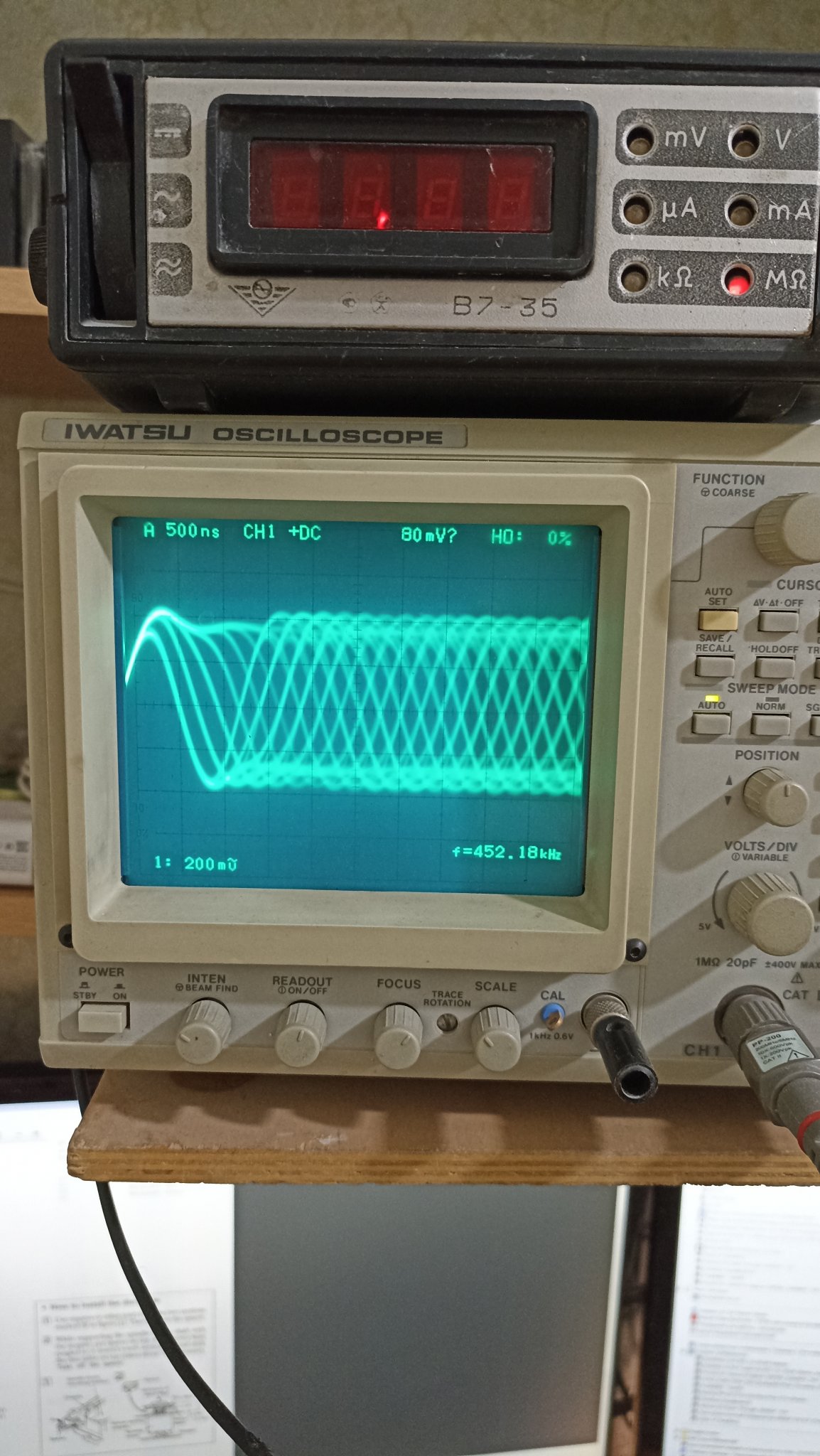

Hello to all,
Since this thread is about KSS272A and I have 2 Sony unit equipend with this laser pick-up (339ES and 559ES), I need your support and advices regarding one of those 2. I bought the 559ES a month ago as not working (read TOC, but failed to play tracks). After many research, I tried to adjust the pots located on laser unit. First the tracking balance (TB) - no result - back to factory setting/position, than AFC - also no result and back to factory setting/position. Finally, I tried the Focus balance and the results begun to show. The factory position of FB pot was at 12 o'clock and I turned left to 9 o'clock. The unit reads now the cds without problem, but the pickup is a little noisy, some how. As I don't have an osciloscope, please tell me if the settings I made are somehow correct and how much they influence the life of laser diode? Any other advices/recomendations?
Many thanks
Cristian
Hello to all,
Many thanks
Cristian

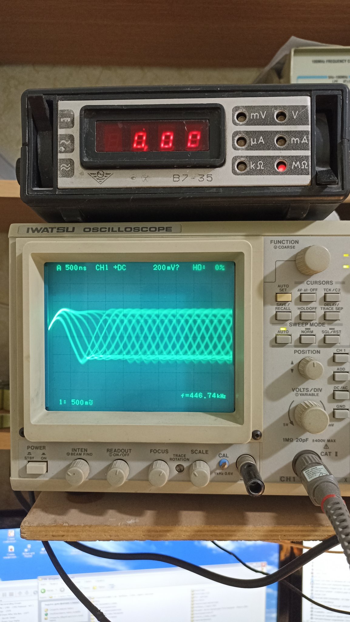

Greetings! You need to start with a complete cleaning of the laser unit, from the outside, from the inside and guides. A very important point is the condition of the lens, look carefully if there are any scratches on it? Even micro-scratches in the center greatly affect the quality and level of the RF signal. Check the backlash of the spindle motor, this is very important, especially at the beginning of the reading, where the rotation speed is maximum. In order to find out the state of the laser unit, it is useful to acquire an LD radiation power meter (this is a necessary device), an oscilloscope and a millivoltmeter, using them in combination. If the output power is normal, the current is normal, and the RF level is weak and blurry, then this is an indicator of a problem with the lens or severe contamination of the laser beam path. This is what the picture on the oscilloscope should look like. This is exactly the case where I replaced the lens, the signal became clear and rose to the normal limits.
Thanks for reply. I already cleaned the lens and tha guides. The lens looks ok, no scratches. The player looks clean inside, no dust or smoke. I replaced some capacitors on BD and spindle motor boards, otherwise everything looks ok. The only pot I adjusted is the one responsible with focus balance. After that, the unit plays fine. I don't have the skills to clean o replace what is inside the laser pickup, I'm affraid to damage more... My question is if the adjustment I made influences somehow the power of laser diode, in terms of life span. I will check the RF level in the future.
Btw, during the adjustment, one SMD components (ceramic capacitor) came loose from its place. I tend to believe that it was partially unglued before, which led to the improper functioning. After the piece fell, the laser continued to work as it did after the adjustment. I tried to glue the part back, but nothing changed after that.
For the moment, I'm happy how the player works, but I need to know how the adjustment I made influences the lased diode in the future....
This adjustment will not affect the state of the diode in any way, it affects the stability of the servo system (in simple words). APC adjustment affects, it is undesirable to touch it!
