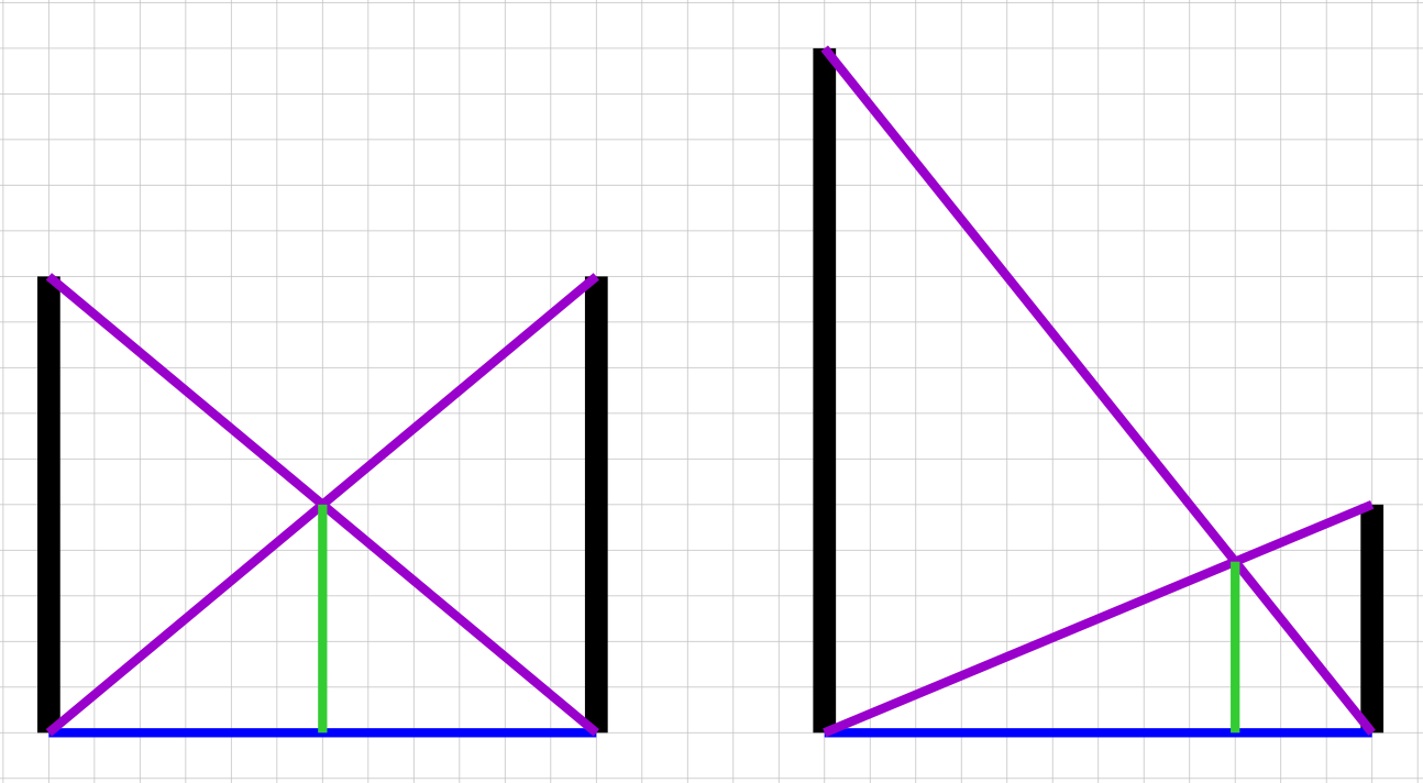

It is quite easy if you understand what's happening here, please see the example I've painted:
attachment.php
Take a piece of paper, and draw two parallel vertical lines of the same length (black).
Now draw a line from the bottom of the first to the bottom of the second line (blue).
Then a line from the top of the first to the bottom of the second line, and a line from the bottom of the first line to the top of the second line (purple).
Search for the section point of the two last lines you've just drawn, and draw a line from that point perpendicular to the baseline (green).
The length of the green line is the resulting resistance of the two parallel black resistances.
As you can see, the resulting resistance is always lower than any of the resistors alone.
In the special case of paralleling two equal resistors, the result will be exactly half the resistance.
As you make one resistor bigger and bigger while keeping the other value unchanged, the result will get closer and closer to the smaller of the two values.
I hope that helps a little...
