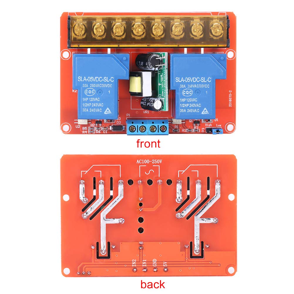

You can use an optocoupled relay module that requires DC power supply.
Schematic, Optocoupled Relay Module
If your SMPS required higher current contact rating, you can use a 30A relay module.

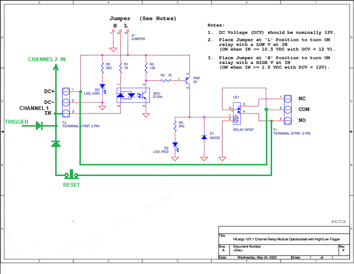

With the simple relay circuit you are suggesting , once the system powers down and the DC disappears the NC relay would close and the larger circuit power up again.
If the appearance of DC is a fault then you'd want to have a circuit that latches off until you reset it.

I think the auxiliary DC supply for the relay module must be connected before the switch.With the simple relay circuit you are suggesting , once the system powers down and the DC disappears the NC relay would close and the larger circuit power up again.
If that's the case, things get more complicated and maybe a DPDT relay with a reset button is needed to latch.If the appearance of DC is a fault then you'd want to have a circuit that latches off until you reset it.
Yeah, the presence of DC would indicate a fault so it would need to latch off after it's activated. Also I'd rather have a solution that doesn't require a power source other than AC from the wall.If that's the case, things get more complicated and maybe a DPDT relay with a reset button is needed to latch.
Does the item you linked latch off? Also, I can't tell if it's normally open or normally closed.

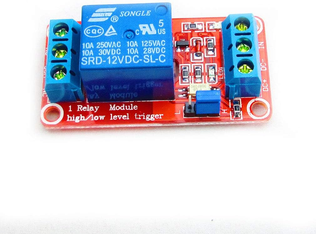

Thanks. What's the official name for a "reset button". Tried to look it up at Digi-Key but I don't seem to be finding anything. Got a link or a part #?The linked module is actually a 2 channel SPDT relay module with built in power supply.
My idea is to use the first relay for latching and use the second relay's normally closed contact to connect to your circuit.

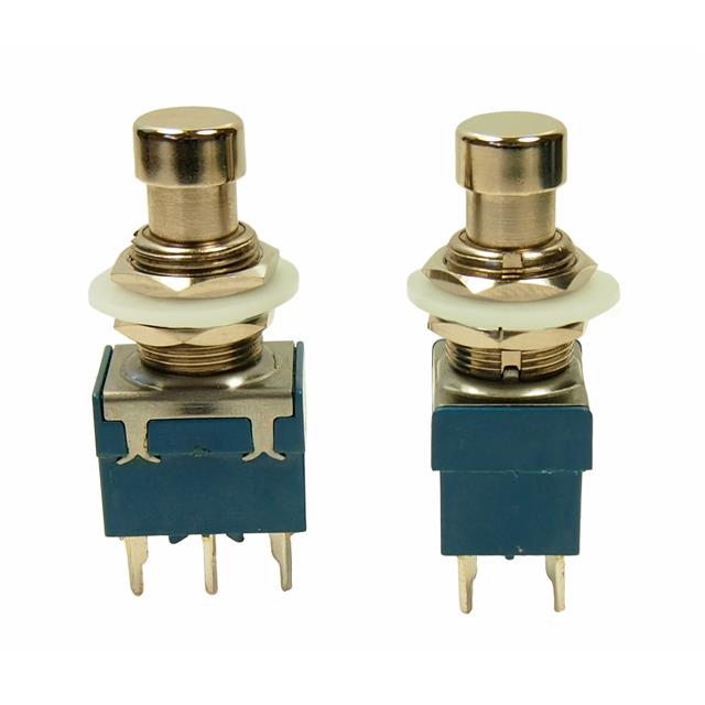

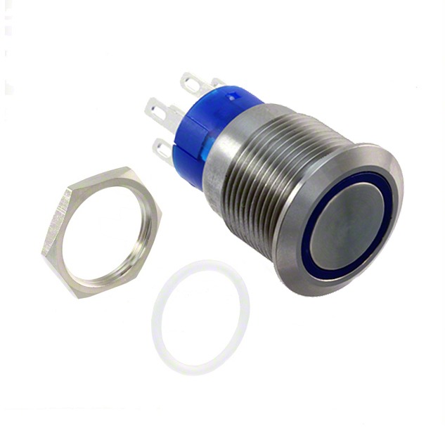

Yes, any push button momentary switch with NC (normally closed) contacts should work.
Here are some examples of Digi-Key:
https://www.digikey.com/en/products/detail/cliff-electronic-components-ltd/FC7106/20416297
https://www.digikey.com/en/products/detail/te-connectivity-alcoswitch-switches/AV1910E712Q04/6043787
