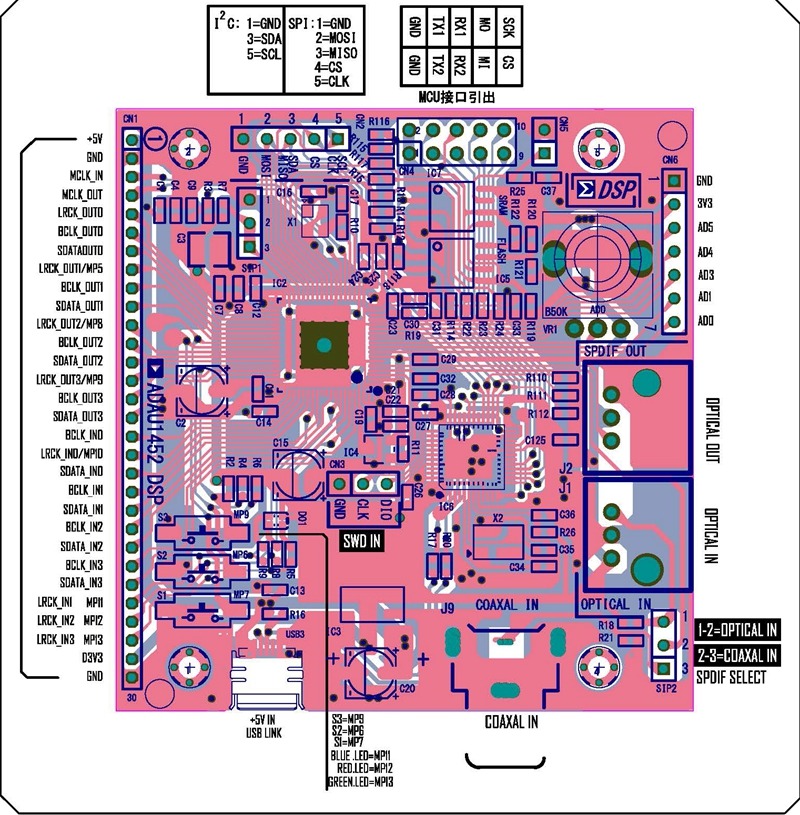

So I also found the GERBER view from the top layer online;
According the datasheet, we are looking for pin 34 at the DSP IC:
So following the traces from pin 34, it goes trough the SIP1 header and than R7 to (I assume) 3V3.
So this part seems to be correct.
For the 2nd issue, we have to focus around IC5.
The write protect is on PIN7.
According to the datasheet of the EEPROM;
Pin7 from IC5 is connected to R120 and R121.
R120 is a resistor connected to 3V3.
However, R121 doesn't seem to be populated!
In other words, according to this picture and GERBER view, the EEPROM is in always write protect mode.
Shortening the pins of R121 will put the EEPROM in write mode, needed while writing.
Or one can just solder a little wire from the connection between R120+R121 to bottom leg of jumper CN5 (the one with the number "9" next to it).
According to the information I have, it seems they populated the wrong position, they should have populated IC7 instead, which is directly connected to the write protect jumper CN5.
No idea if this will solve problems, but purely on paper, this shouldn't work as it is now.

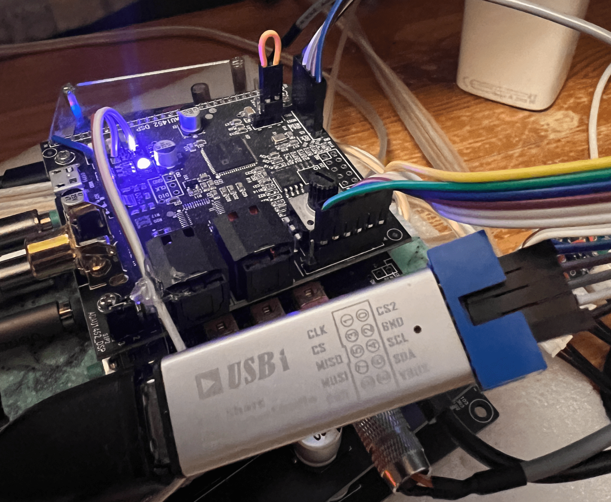

First time posting here, I thought I'd share my experience with programming the nvarcher v2 ADAU1452 board as snippets of a number of the posts here have helped get my board working, so, many thanks to previous contributors for the help. I can't vouch for any of the other USBi interface boards but I use the one supplied with the DSP board available on Ali here.
As a precursor to using the ADAU1452 I started out with a few ADAU1701 Wondom boards so had previously installed the USBi drivers. I'm not sure if it made a difference in my case but there is a pretty detailed video on installing the USB drivers from YetAnotherElectronicsChannel on YouTube. USB installation from 5:20 here

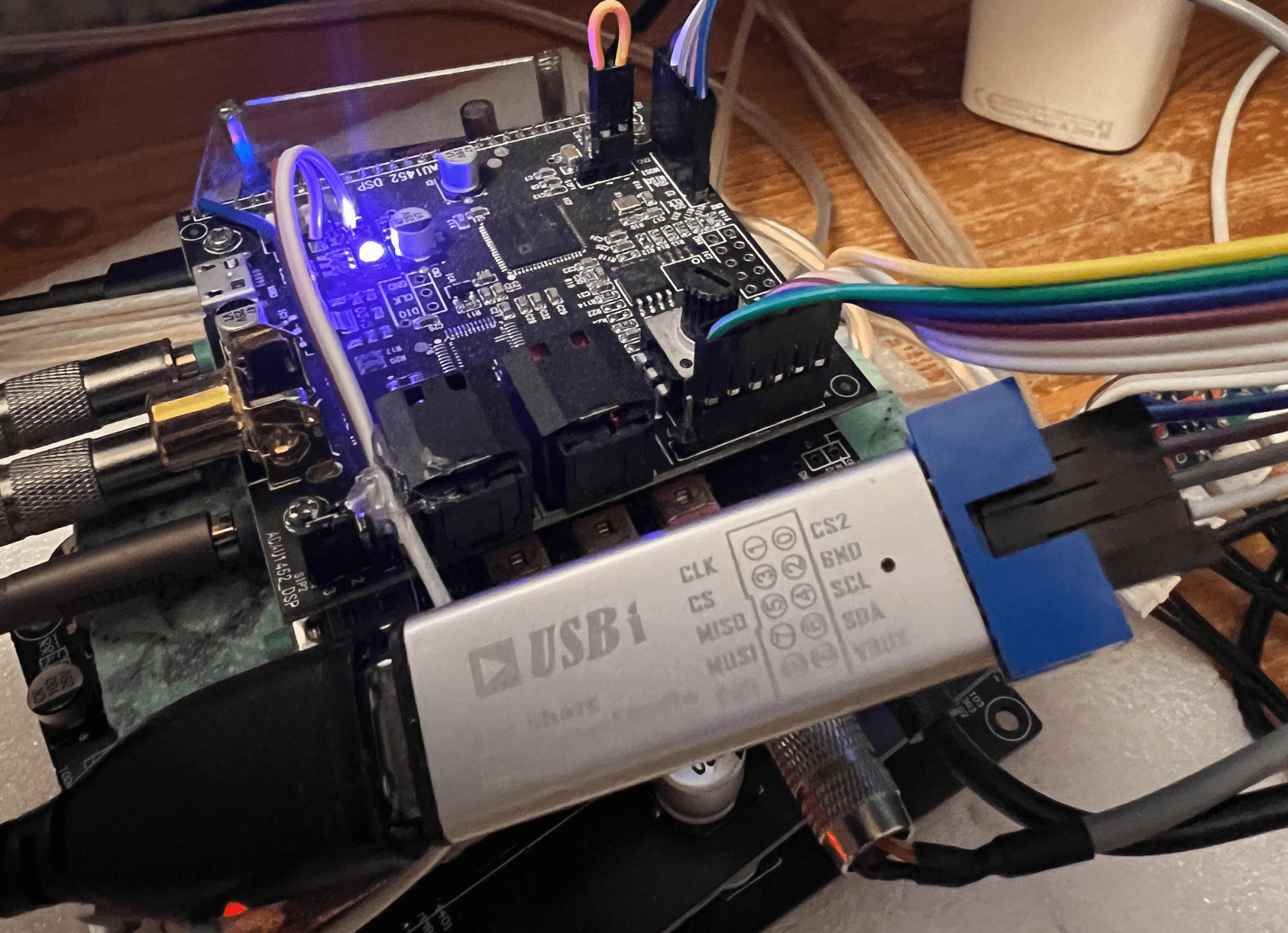

Firstly, connecting the USBi to the ADAU1452 board must be done using the SPI pins for the V2 board.
The board arrives with the SIP1 header unpopulated which was the first hurdle. I soldered some header pins to facilitate a jumper. connect 1-2 for programming and 2-3 to run once EEPROM is loaded. This has been covered by a few but the sequence of operation seems to be important, so I'll run through what works for me. To start, the USBi must be disconnected from the ADAU1452.
1. Open Sigma Studio and load project.
2. Connect USBi to computer (sometimes my USBi isn't recognised if I plug it in before opening Sigma Studio??) USB block should turn green. This is where I'm not certain whether the driver installation is crucial?
3. Start with ADAU1452 powered off bridge SIP1 pins 1-2.
4. Power on ADAU1452 (on board LED should be blue/green)
5. Connect USBi to header pins for SPI (1, 3, 5, 7, 9 on USBi).
6. Link Compile Download in Sigma Studio and the LED should turn purple. Sigma studio should show Active:Downloaded in the bottom right corner.

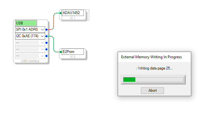

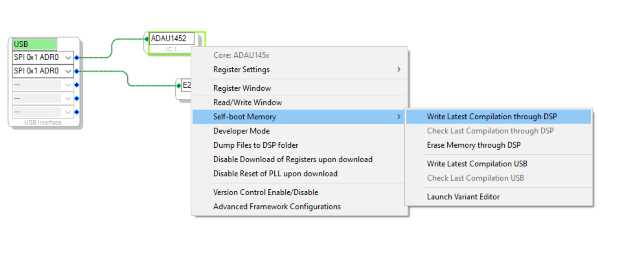

7. Write Latest Compilation through DSP, again through SPI.
8. Change SIP jumper to bridge 2-3 and disconnect USBi.
9. Power off/on ADAU1452.
Again, this is what works for me with the USBi interface I have. I tried using the Wondom ICP3 USBi interface but this doesn't work as it used I2C.

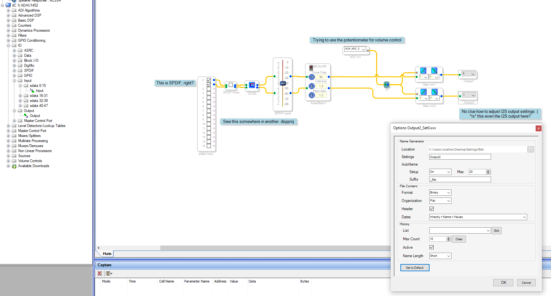

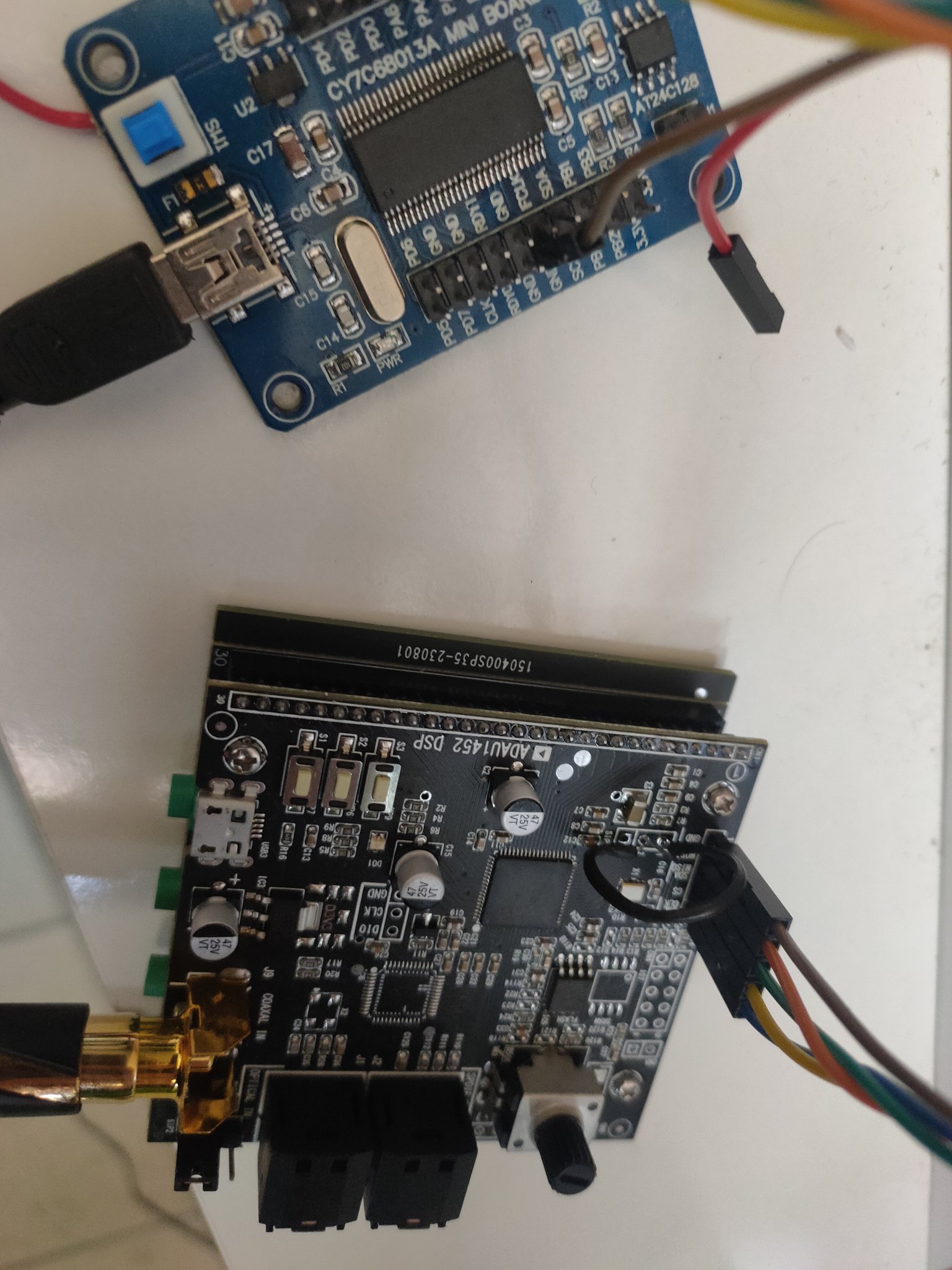

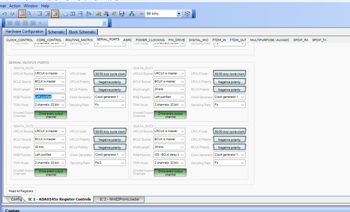

Hi all! After a bit of experimentation I have the cheap ADAU1452 board discussed here working with a CY7C68013A board flashed with freeUSBi. As in, I can compile & upload in SigmaStudio. I'm having quite a difficult time learning SigmaStudio though. For the moment, all I'd like to do is route the SPDIF input to one of the I2S outputs and have it working with a DAC (the one built into the MA12070, specifically). For this I'll have to set some I2S settings. Basically I'm struggling with two questions at this point:
  • What is correct and what is incorrect about what I've done so far (see attached)?
  • Where do I adjust output I2S settings such as left- vs. right-justified, etc.?
A good quick start guide for programming the ADAU1452 is the EVAL-ADAU1452REVBZ User Guide below. A few notes:

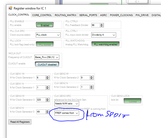

  • The SPDIF input always needs to be routed through an ASRC if going to the DSP for processing. The same goes for I2S inputs unless your I2S devices are slaves (they use the DSP’s master clock and have the same Fs frequency). So normally your SPDIF and I2S devices go through ASRC’s.
  • The name of the Asrcin1 block confused me at first. It’s actually the ASRC’s outputs to the DSP core. From the DSP core’s view it’s an input.
  • Setting the Fs frequency in the schematic only sets up the filters and other components to operate at that frequency. It’s your responsibility to set up the clock system so the correct Fs frequency is generated for the DSP core. You do this in the clock control tab in the register window. See the “Clock Generators” section in the ADAU1452 datasheet and Figure 18 in particular.

See attached for what my sketch/program/circuit now looks like (what do people call these visual programs?)
This is after following your instructions as far as I understood them and reading over the datasheet's Clock Generator section.

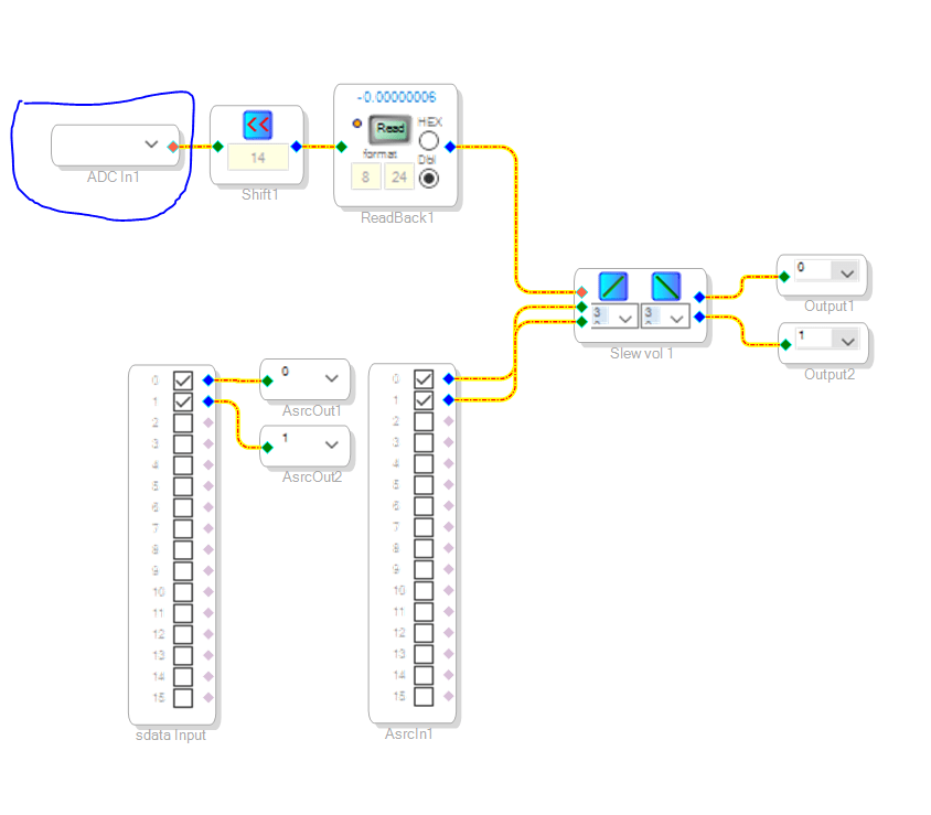

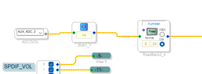

Unfortunately, different from last time, something seems broken now: in the ADCIn1 widget, it's not possible anymore to select which input (according to the schematic, I would have to select ADC2 in order to get the potentiometer)
F7 output doesn't show any errors, the USB widget is green and "Write Latest Compilation through DSP" is working just fine, too. Completely stumped now :(

Schematic was posted 2-3 years ago, everything could happen during this time, but it was just a suggestion :) . Readblock shows 0V which means that no voltage is connected to pin no. 10. But there is something wrong on your picture, AUX_ADC block should look like this:
on your schematic the block is "empty".
