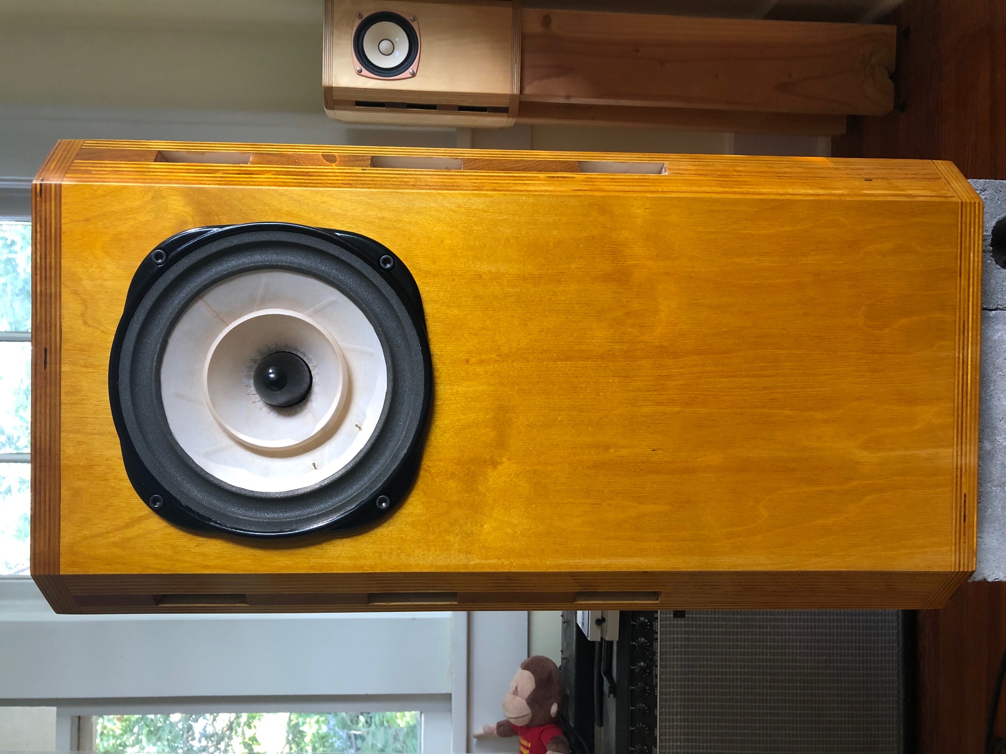

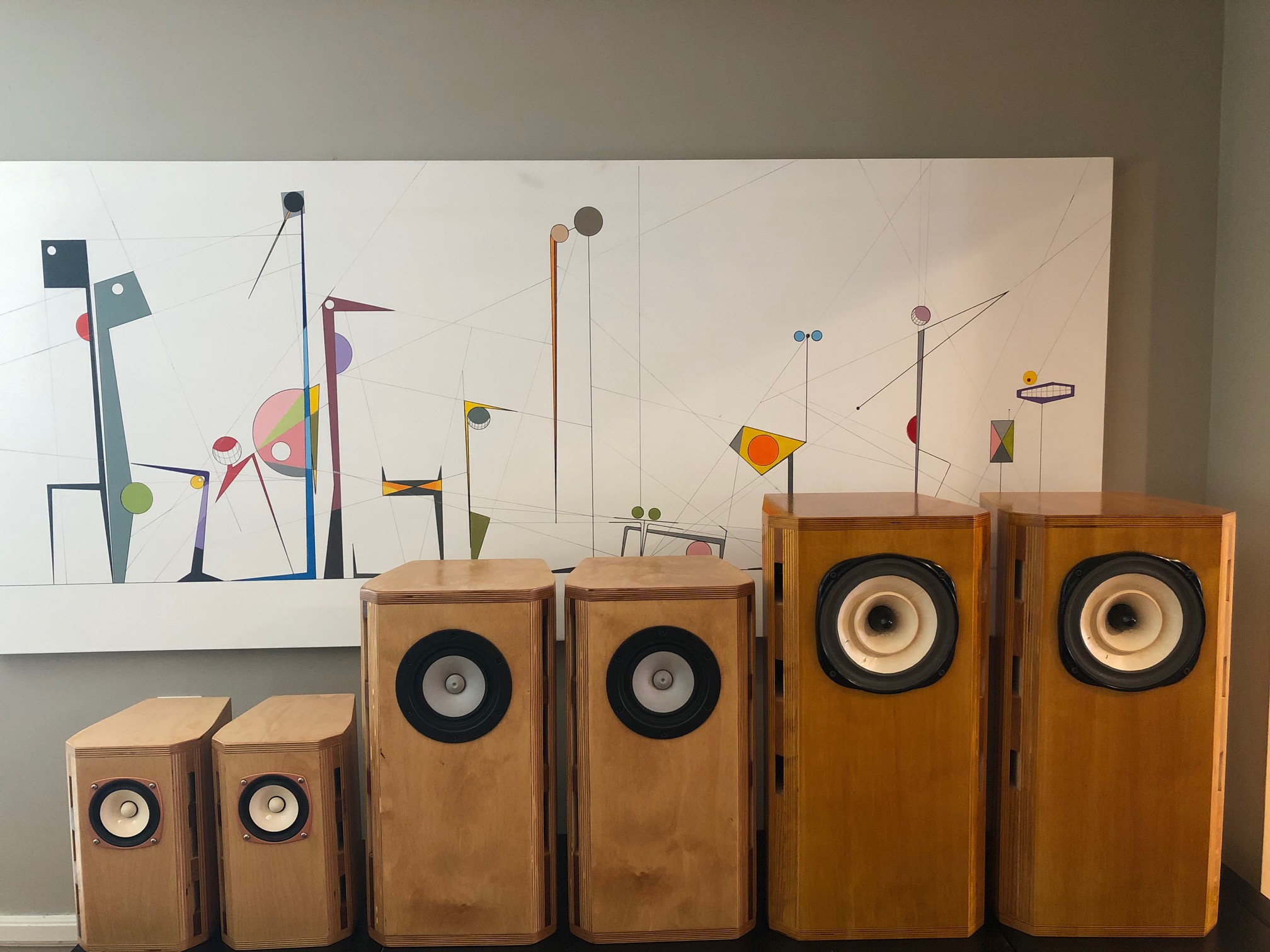

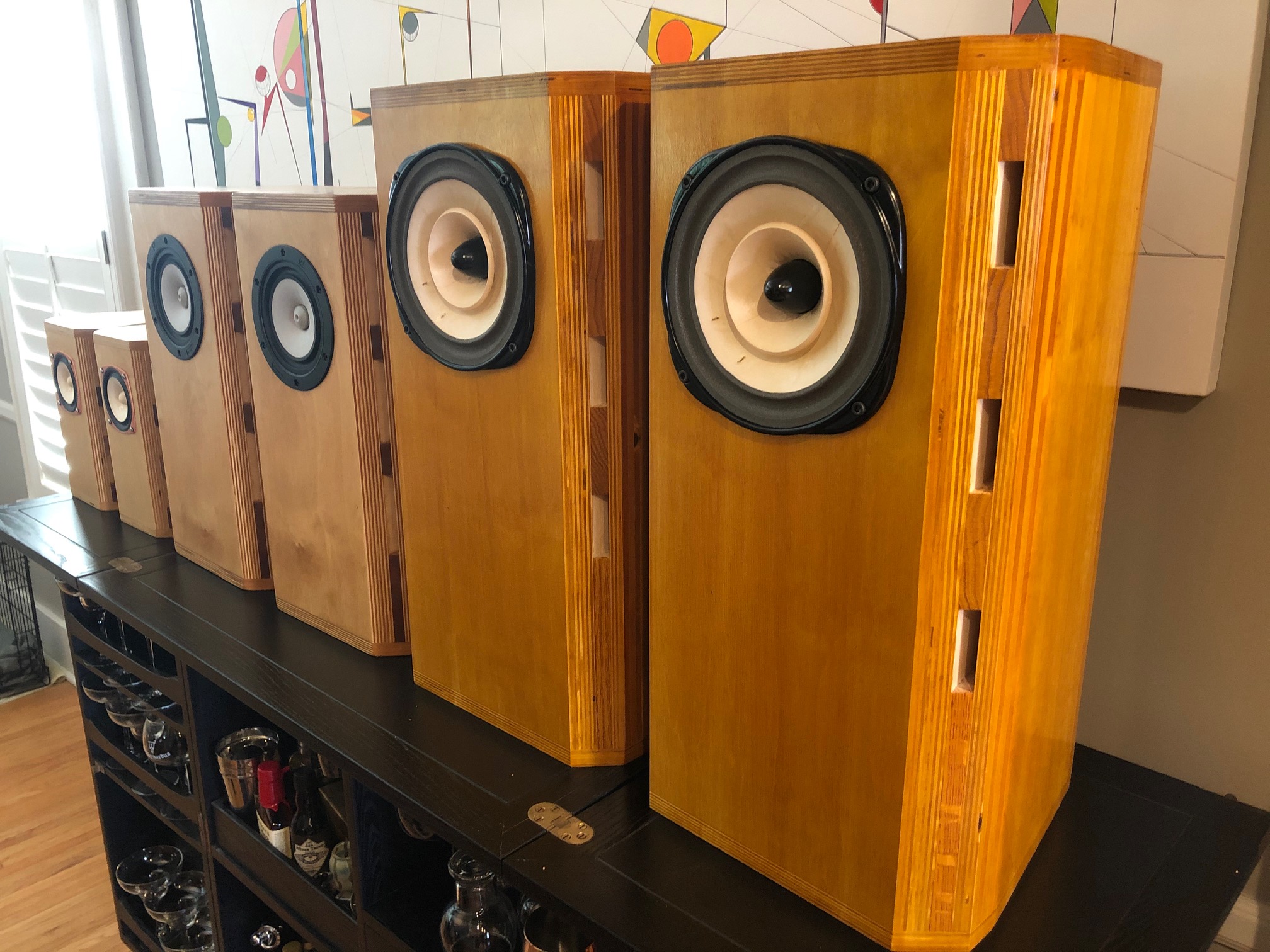

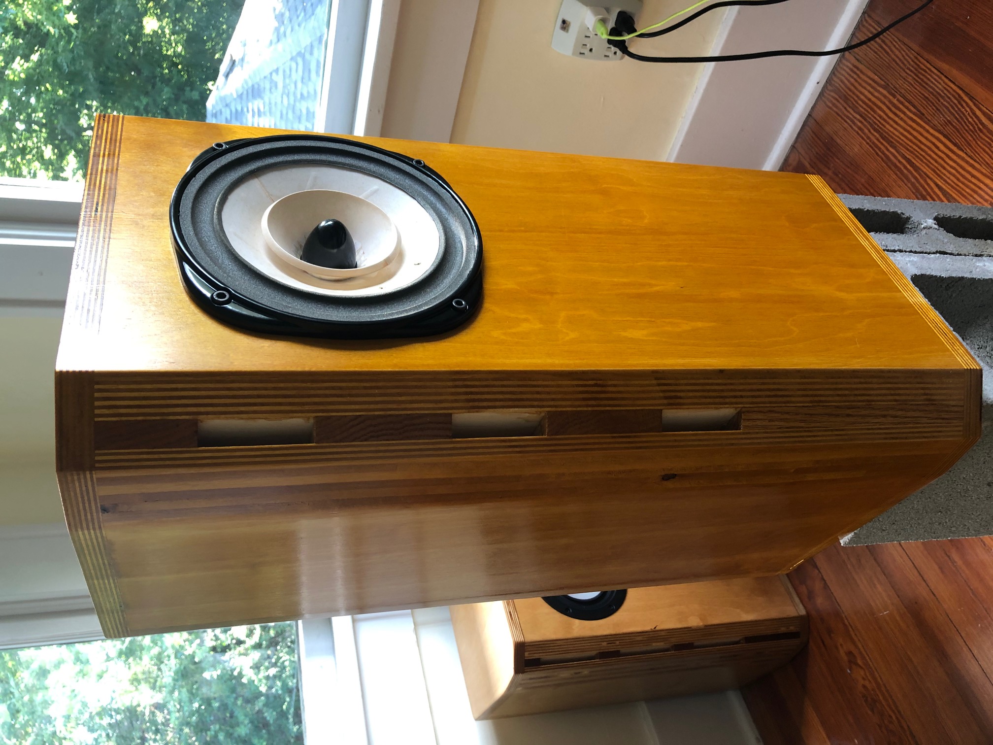

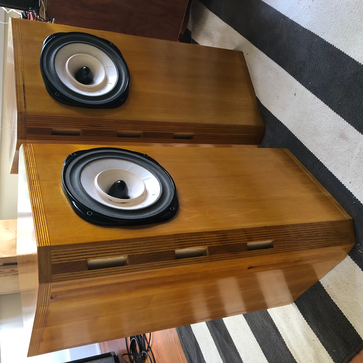

I wasn't able to post in the Planet 10 picture gallery, so here are the trapezoidal Onkens for Lowther PM6A. Special thanks to David for the bespoke design. I've only listened for a couple hours but they sound superb.

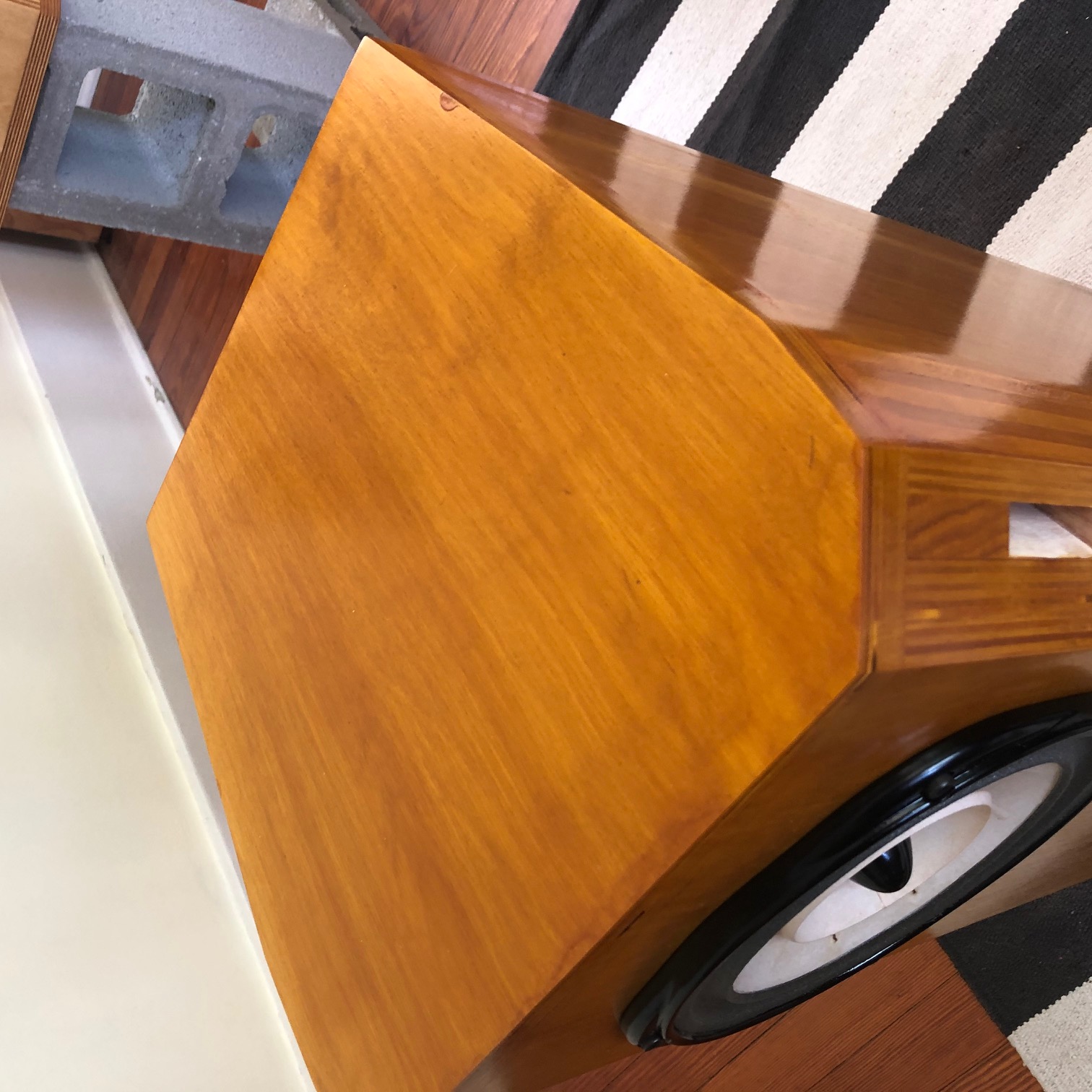

18mm Baltic Birch plywood with solid red oak vent spacers. Finish is 12 coats of amber shellac and a top coat blend of orange oil, beeswax, and carnauba wax.
Also pictured are mFonkens for Fostex FE103Sol and MarkAudio Alpair 10P.
Some thumbnails appear sideways but are corrected when you click to view the larger version.
Those interested in more pics as well as thoughts on build process and creativity can follow me at Instagram: @boisetverre.

Jeff,
Thanx for the email with the pictures, these are gorgeous.
With positive initial comments i am eager to hear what you think of the sonics as they break in. Enclosures for Lowthers that are not big horns are rare and hopefully this design challenges that notion.
Since there is only one, it is called a Low-Ken or Low-KenPM6T, if more follow it may well get a longer designation.

Thanks! I will definitely report on the break-in process as noticeable changes occur, with a thorough review at some point. I'll say right now that these by far present the most "air" or "sparkle" (or other audiobabble synonym) of any speaker I've heard. Also percussion -- the hi-hat and cymbal in bebop: Wow! Otherwise they're just so musical and involving, with microdetail that's almost kinda scary.
Timbre of acoustic instruments and jazz guitar is gorgeous.
Also they handle complex passages remarkably well.
These will become a family heirloom.
Bass extension is very adequate. It's musical and detailed. Not quite the umph of the A10P in Mar-Kens, but I certainly don't feel like anything is missing. There is no "shout" at all. The frequency spectrum is beautifully balanced without an overemphasis on any one part of the range. I've heard DX4's in a pair of transmission lines that were definitely tilted toward the treble, but not harshly so. In contrast, the PM6A in Low-Kens are perfectly balanced, to my ears.
I really do wish we lived closer so that you could hear them.
Bass did seem to fill in over a couple hours last night as I listened to jazz and funk (Jimmy Smith, Medesky Martin & Wood, Miles Davis) as well as contemporary rock/electronic (Atlas Sound, Grizzly Bear, Beach House). As of right now the Lowthers don't even have three hours on them, though.
I'd guess they're strong down to 55Hz but I haven't measured. Maybe it's time to break out the measuring microphone I ordered years ago but have never set up. Any suggestions on how to take measurements in-room would be most welcome. My instinct is to put the mic at the listening position to measure real-world frequency response, but maybe there other suggestions?
