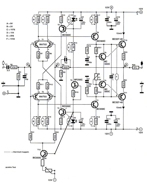

MAT02, 03 Elektor preamp schematic

Maybe BF245C or BF545C, or a BF245B (or BF545B) with reduced source resistor (about 390 ohm), or even a BF245A or BF545A with no source resistor at all.
Merci Marcel, i found cpl of BF256C...in a small shop in France, Now Fairchild/On semiconductor recommendation for replacement is the J111

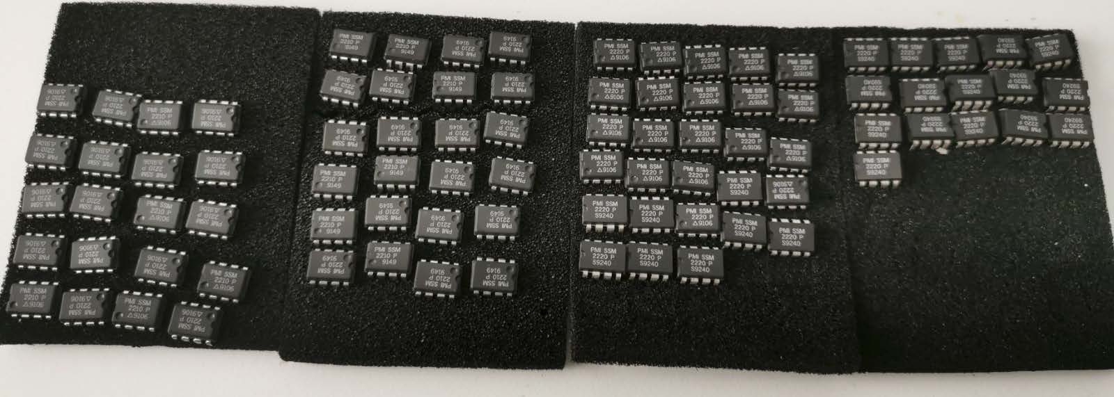

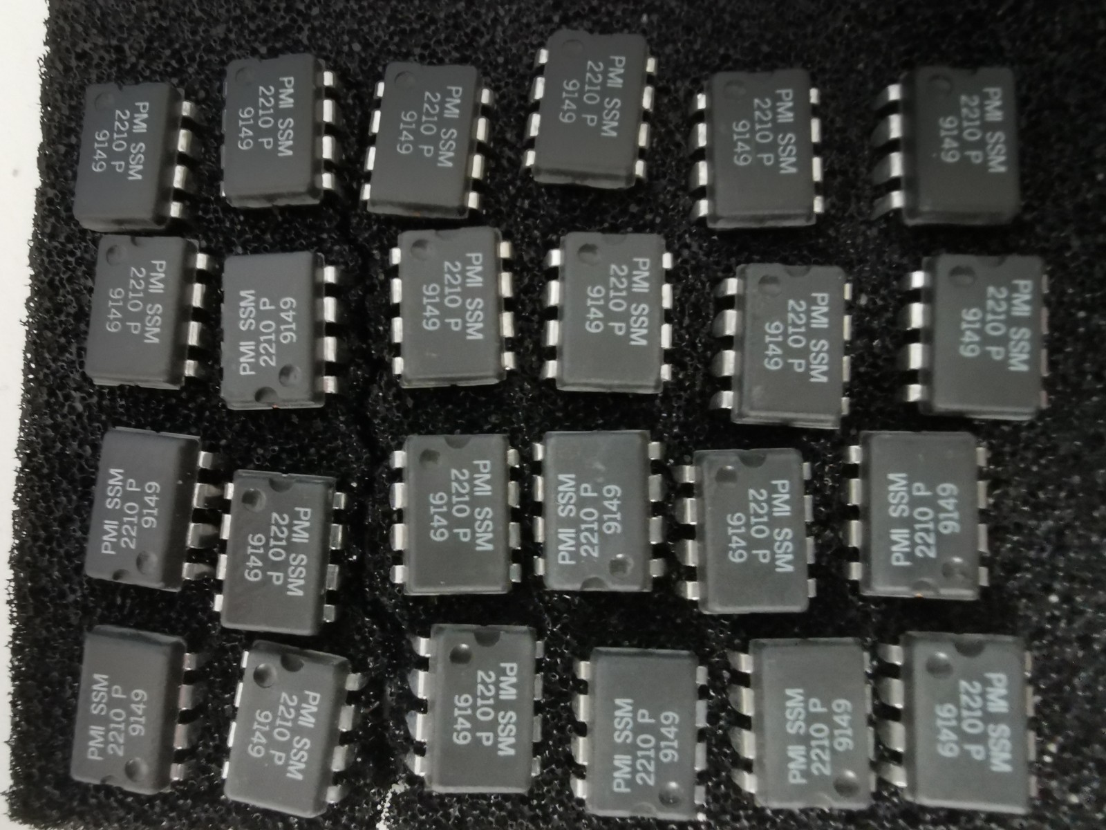

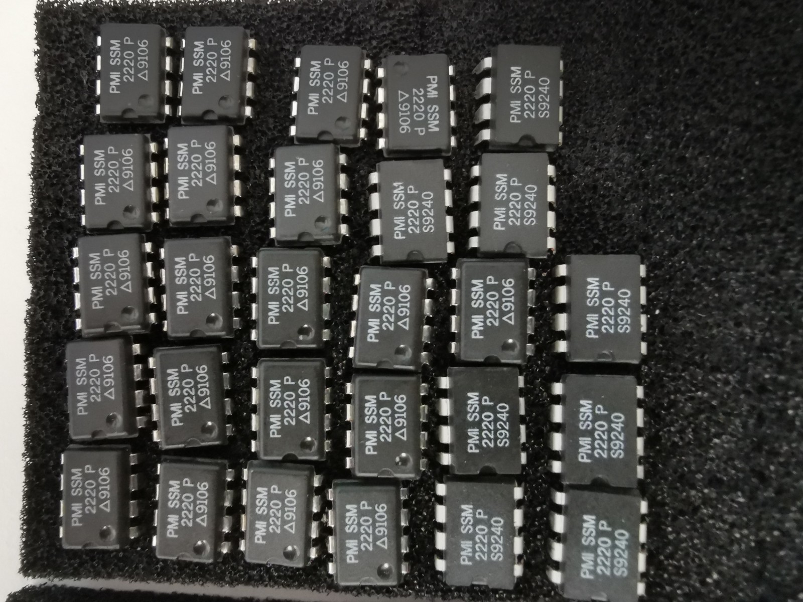

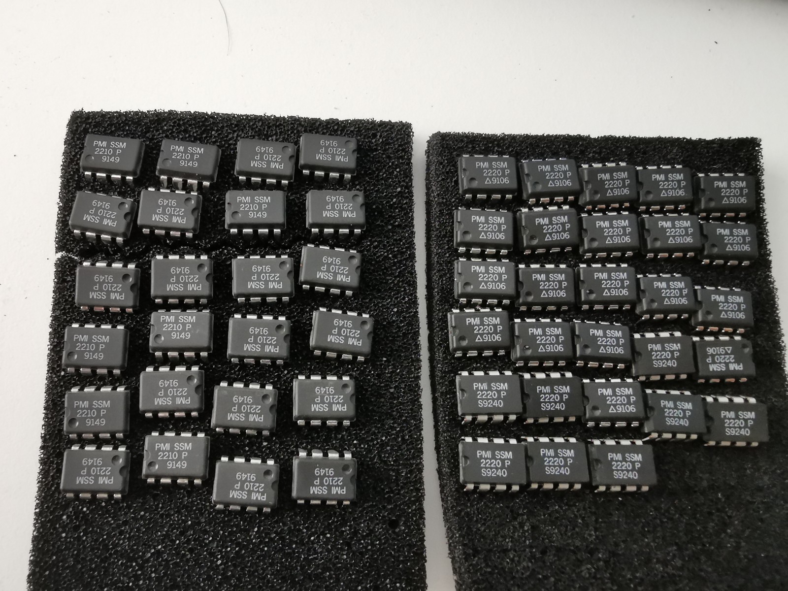

Elektor preamp SSM2220 & SSM2210
For sales SSM2220 & SSM2210 (DIP-8) they fit for the PCB above and they are the best available replacement for MAT02 & MAT03 Dual Transistors.
I bought the PMI in 1991 from Spoerle Electronic a German distributor se at the DATA Code.If you buy more than 12 pair I will not charge 4% PayPal fee. Sales only NPN & PNP pairs. I ask for 3,50€/piece plus shipping from Finland + 4% PayPal fees. Contact me if you are interested.

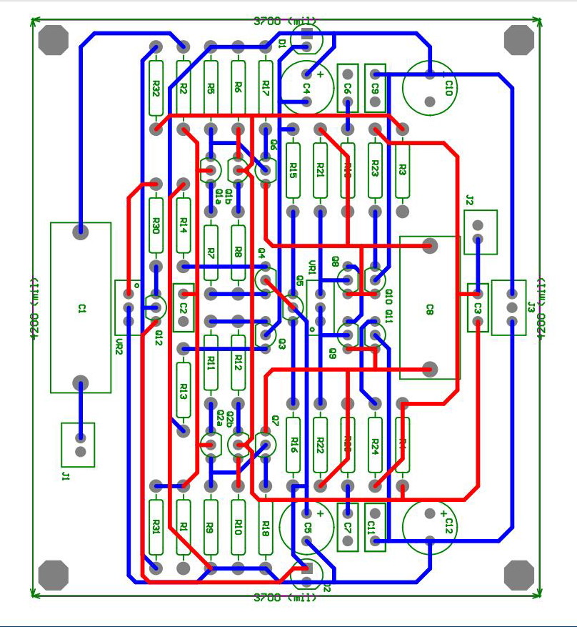

Old thread, but seams like a good place to aske about this preamp.
I've had my eyes set for building this preamp for quite some time now.
It's hard to find any further information besides from this thread. And very helpful reading. I don't have MAT02/03, but loads of BC550C/560C or KSA992F/KSC1845F if these will do if properly matched.
As for the BF256C I have purchased Onsemi J111 as replacement.
But two questions:
-The volumepot, how many Kohms should I use for this preamp?
-For the PSU I'm thinking of a 20VA or so regulated power supply with 2x6800uf. What did Elektor recommend as PSU for this preamp?
Thanks:)
