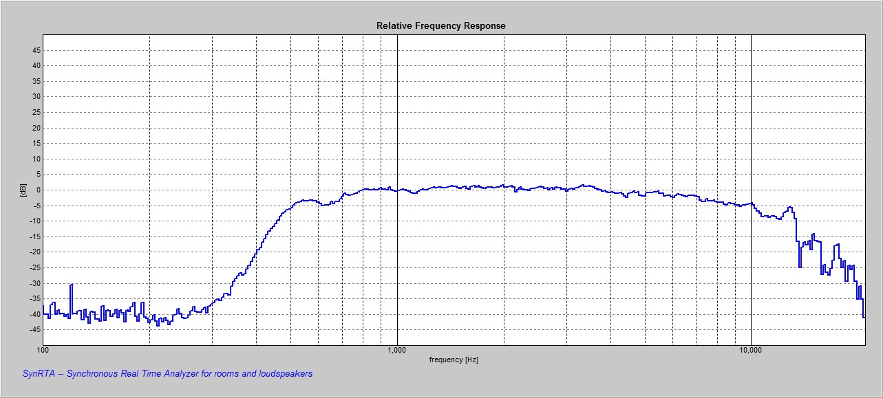

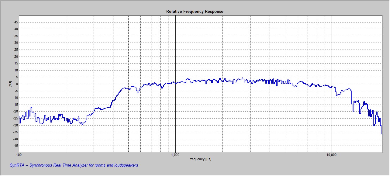

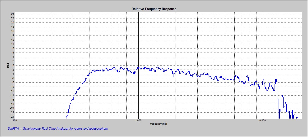

One can sort through POOH's HLCM thread and find scads of excellent info on mating Altec 288's to various horns.
The following pics are of POOH's Altec 288G's mated to 3 different horns.
- This 288G was fitted with a brand new GPA diaphragm.
One can see that the 288 dies after about 13K ( but is good to about 500hz depending on the loading of the horn ).
I listen through Altec 288-8K's / EH500 radials ( I have for about 15 years now ) and don't plan on changing any time soon.
I run a Fostex tweeter ( once in a while ) when I think I need a bit more UHF ( though I can't hear over 13K ).
Your ancient 288C's would need to be remagged ( as well as have new diaphragms properly fitted ) to be playable.
