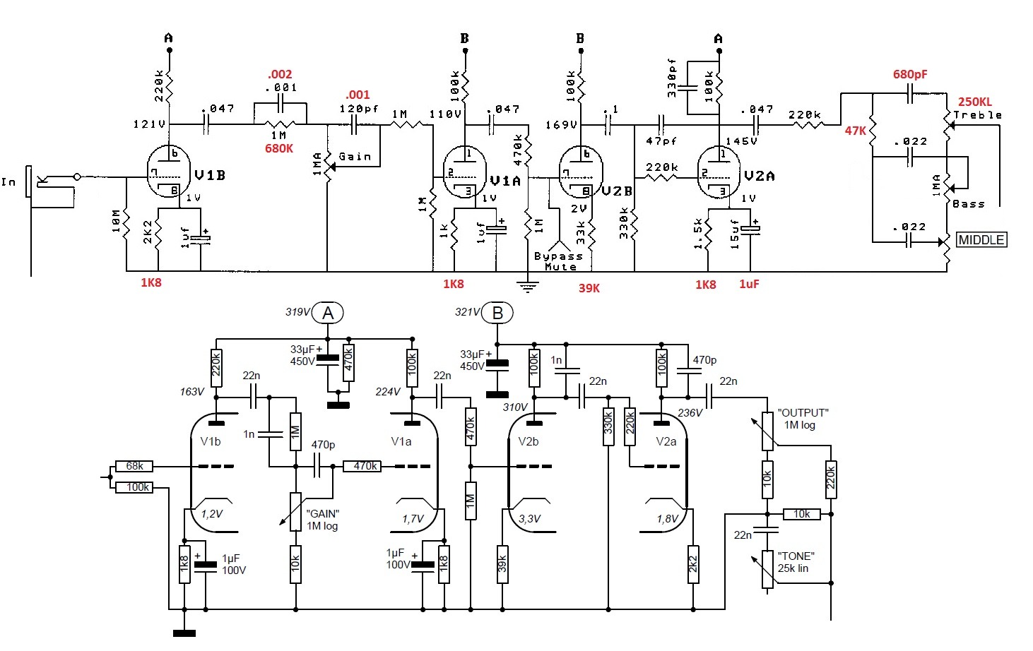

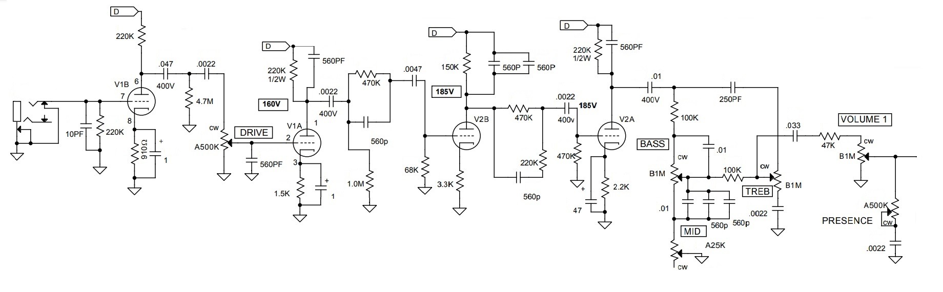

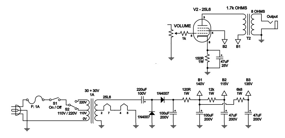

Just build an AX84 project, the simplest one, one EL84 + 1/2 12AX7.I would like gain only in the pre-amp section, in the power part a single ended output, class A. In the style of the amplifiers on the AX84 website.
You need only one triode to drive EL84.
