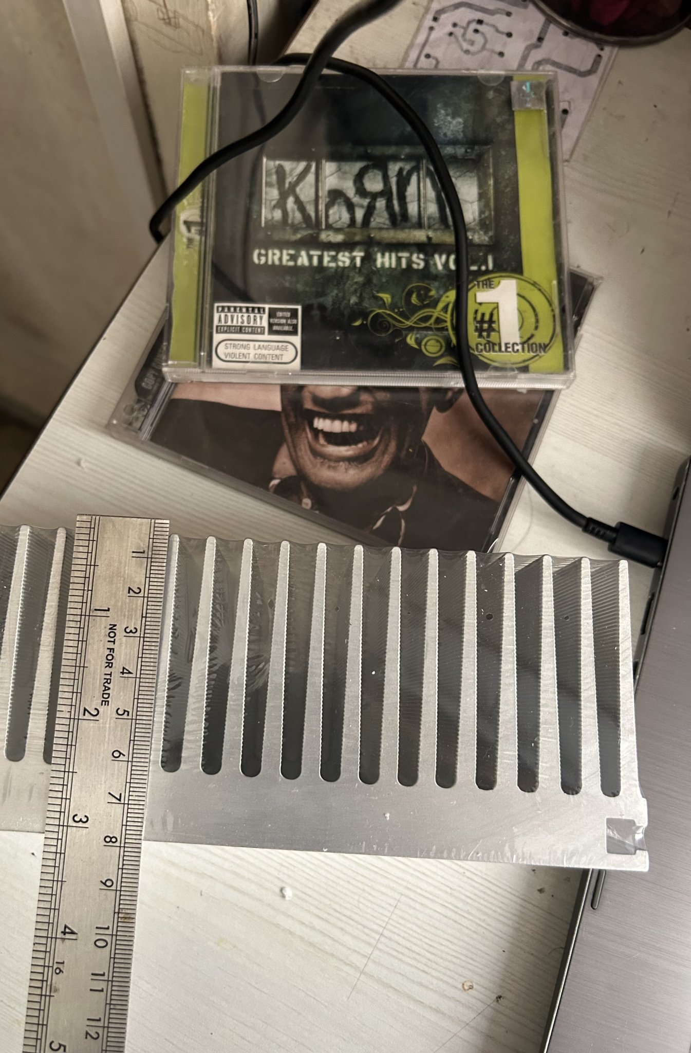

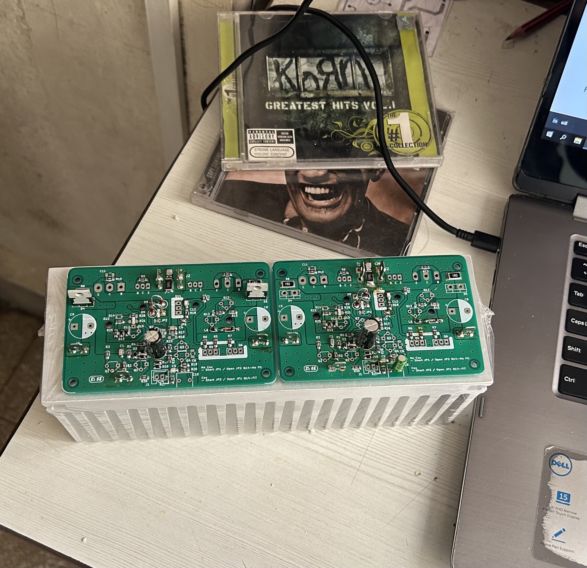

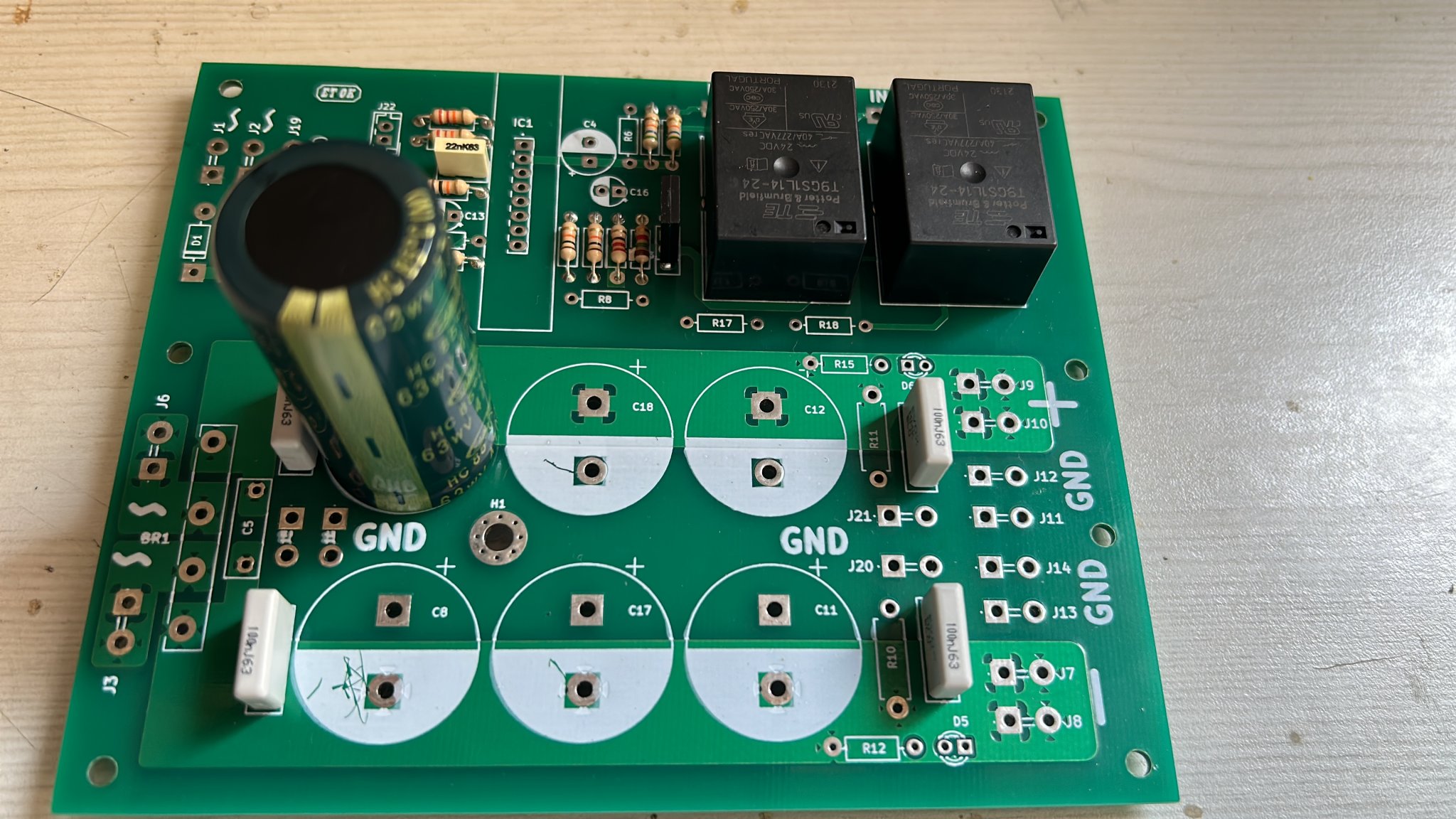

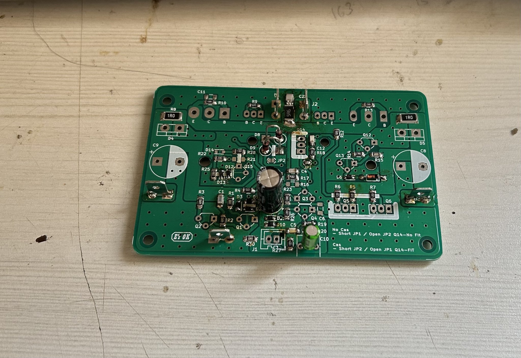

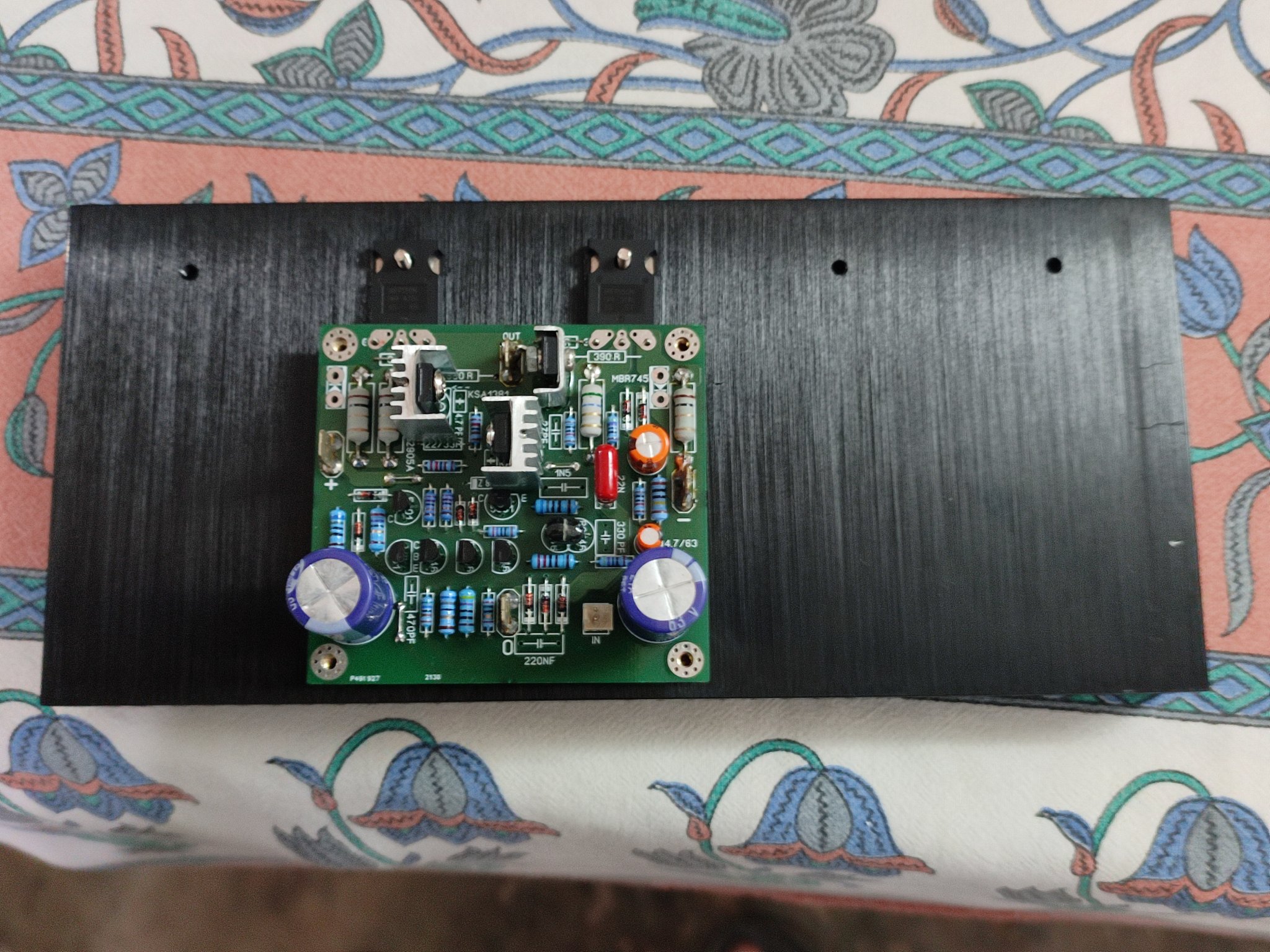

Progress on my boards, awaiting 215mm x 75mm x 75mm heatsink. After which the holes and tapping will need to be done (coming Saturday hopefully)
Also need to get 60 or 70 watt soldering iron since my old 25watt is not able to solder the power caps with the massive ground plains
Need to test the speaker protection section.
Funny thing along LM3886’s, MJL21194G, MJL21196’s it seems 5mm pitch MKP wima 4.7uf’s, Nichicon UES (Muse) are not there on Digikey, Element 14, RSComponents.
New dilemma now caps
Note: pcb’s needs a cleaning

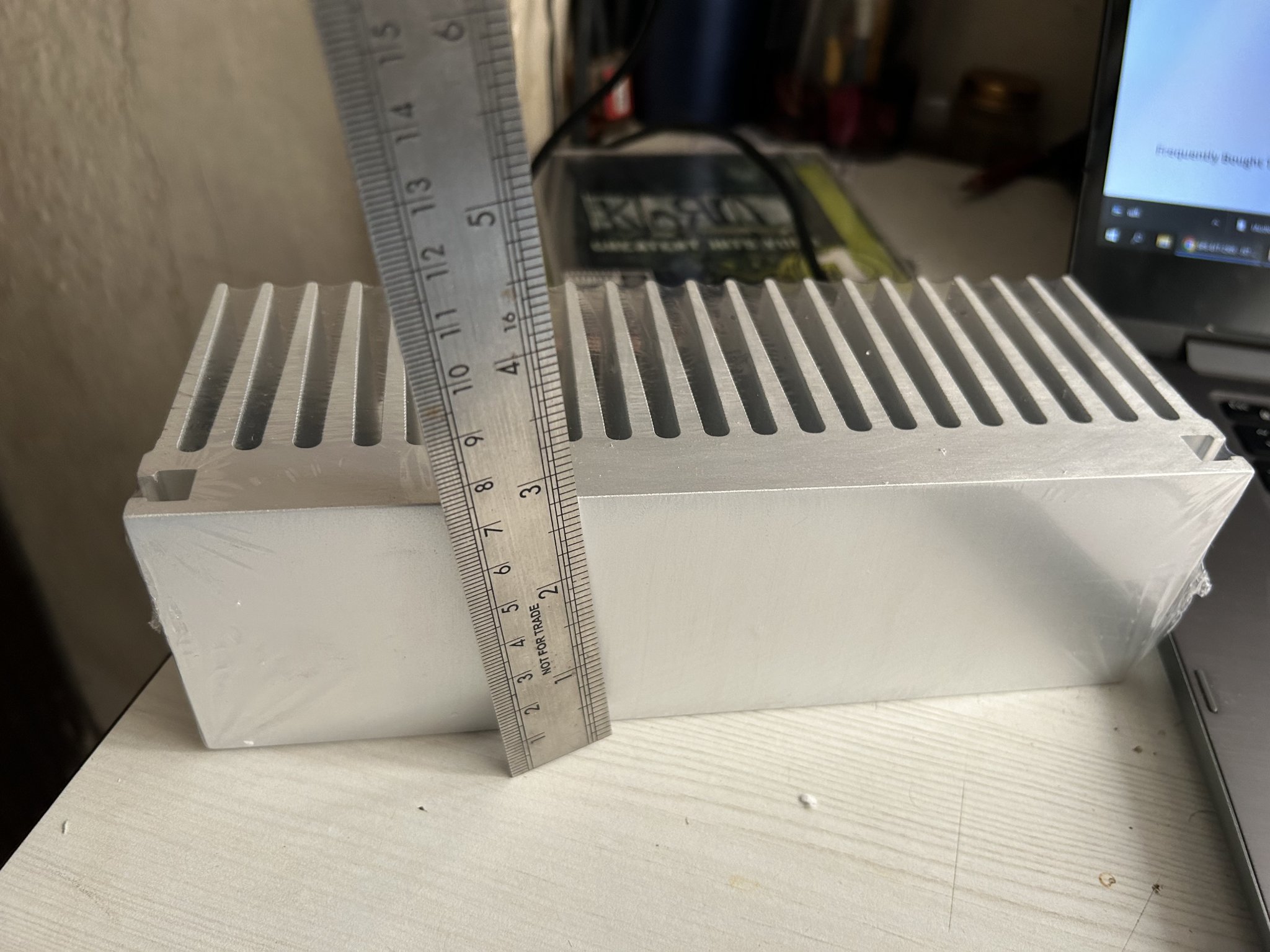

Further progress and work cutout for the weekend
It’s going to be 2 mono blocks on one heatsink sized 215mm x 70mm x 75mm rated at 0.5k/w

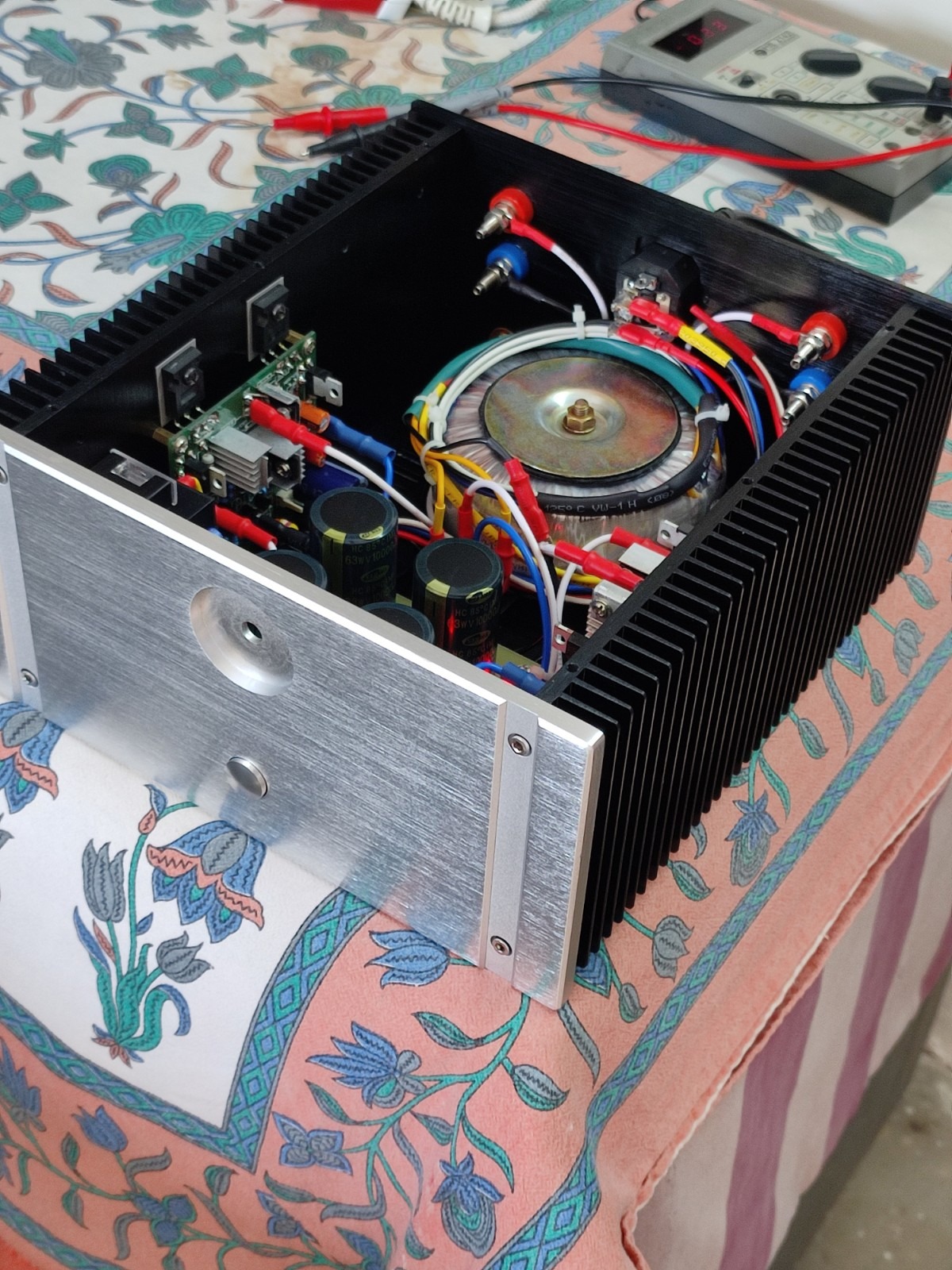

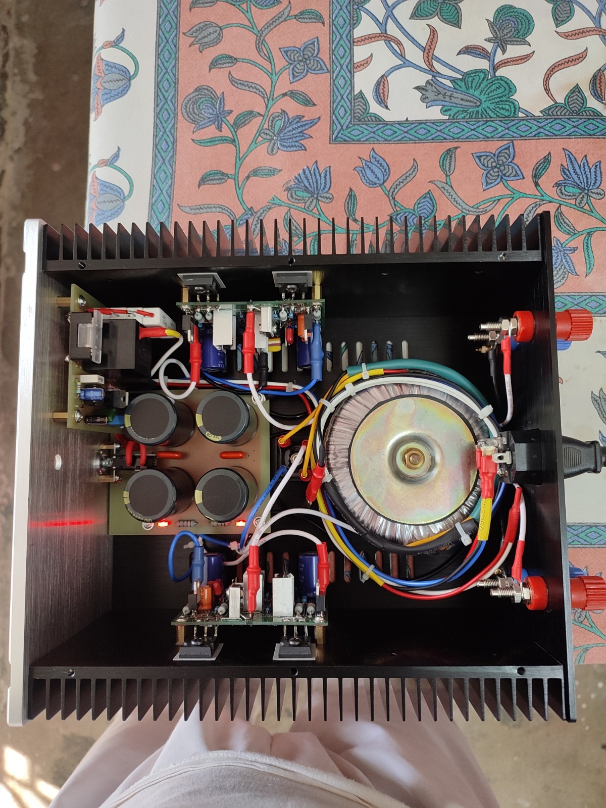

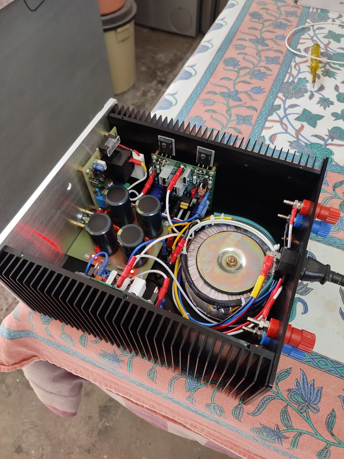

The excellent performance of my previously built MOSFET Circlophone prompted me to build another Circlophone but this time on a proper Class A all aluminium chassis. The last one was built of a salvaged metal cabinet where in I could not fit large heat sinks for output devices. Even with inadequate heat sinks the amplifier is working very well till today.

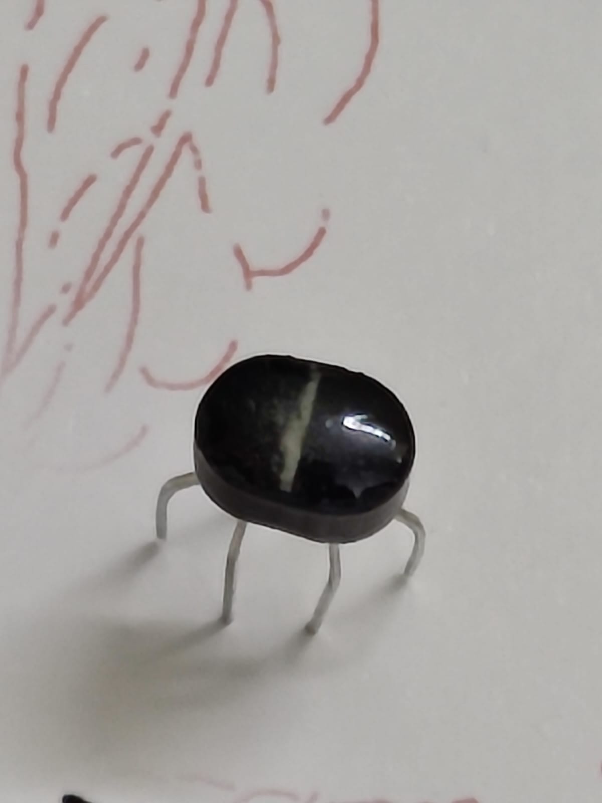

This time I have checked all components like resistors, capacitors to their actual value and even matched input and VAS transistors on component tester. I have glued input pair transistor BC546B with heat sink compound and bonded them with Araldite. In this build I have used Cascode transistor KSA1381 instead on Zener diode.

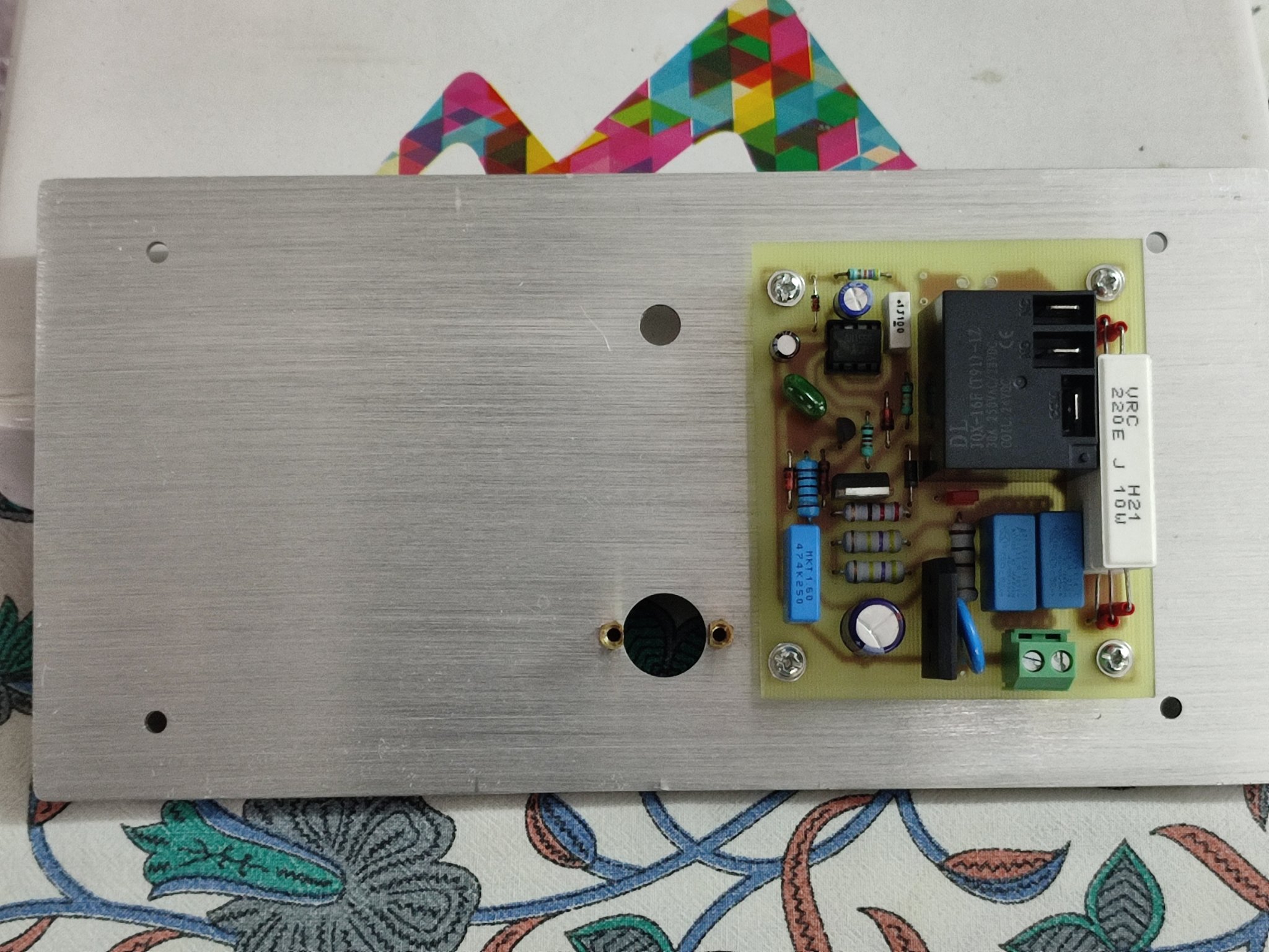

I have used soft start circuit to prevent inrush current.
Although this chassis has a provision for Volume Control but I will not use it since putting volume control at the input increases distortion even with a low value of 5K pot.
The build has following parameters;
1. Rail Voltage - 32V
2. Offset Voltage - between 3-4 mV (Both Channels)
3. Quiescent Current - ~164ma (input short)
Components Used
1. Transistor BC546 - CDIL India
2. Transistor 2N5401 - KEC
3. Transistor VAS KSA1381 (ON Semi)
4. Transistor Cascode KSA1381 (ON Semi)
5. Transistor CCS - MPSA42
6. Power Schottky - MBR745 (Taiwan Semiconductor)
7. Signal Schottky - BAT85
8. Output MOSFET - IRFP240
9. Current Sensor Resistor - 1Ohm MOF
10. Other Resistors - MFR
11. Toroidal Transformer - 24-0-24 5 Amp
12. Rail Capacitors - 2 pair of 10000MFD 63V (Samwha)
Both channels are silent with no input.
Again thanks for your excellent schematic design.

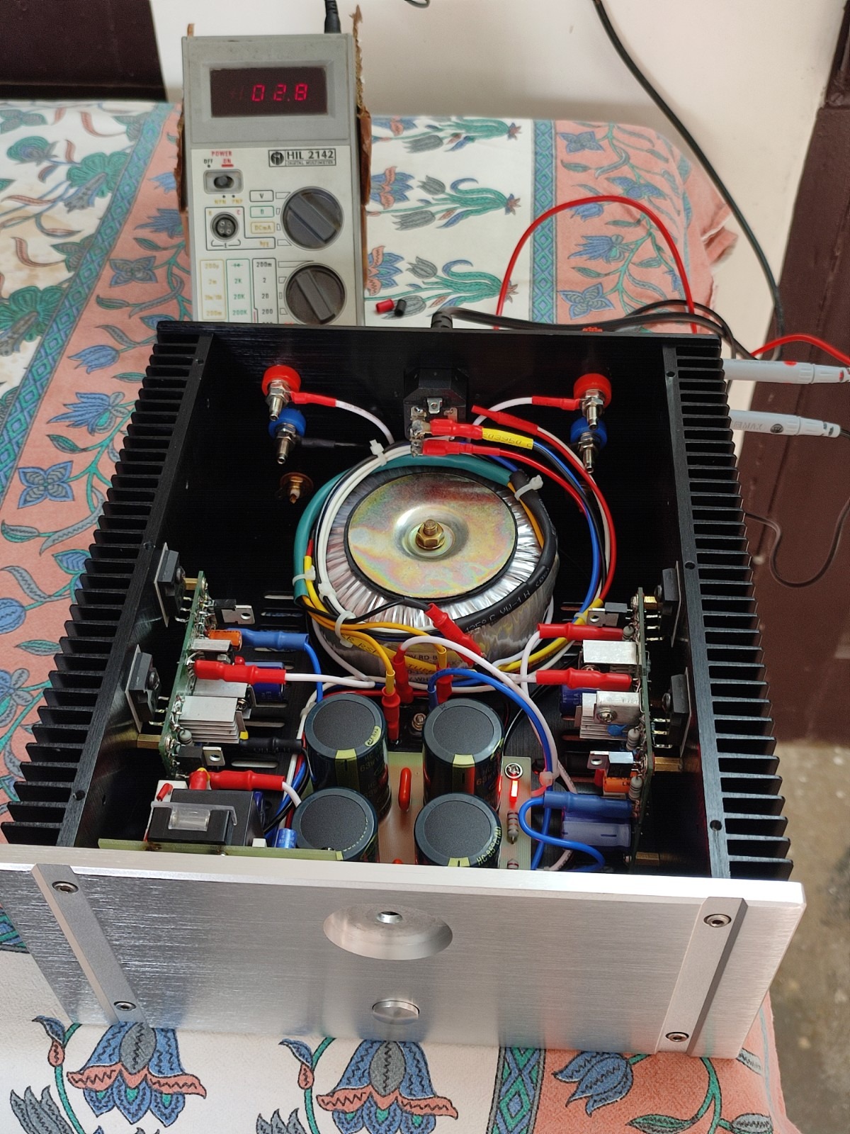

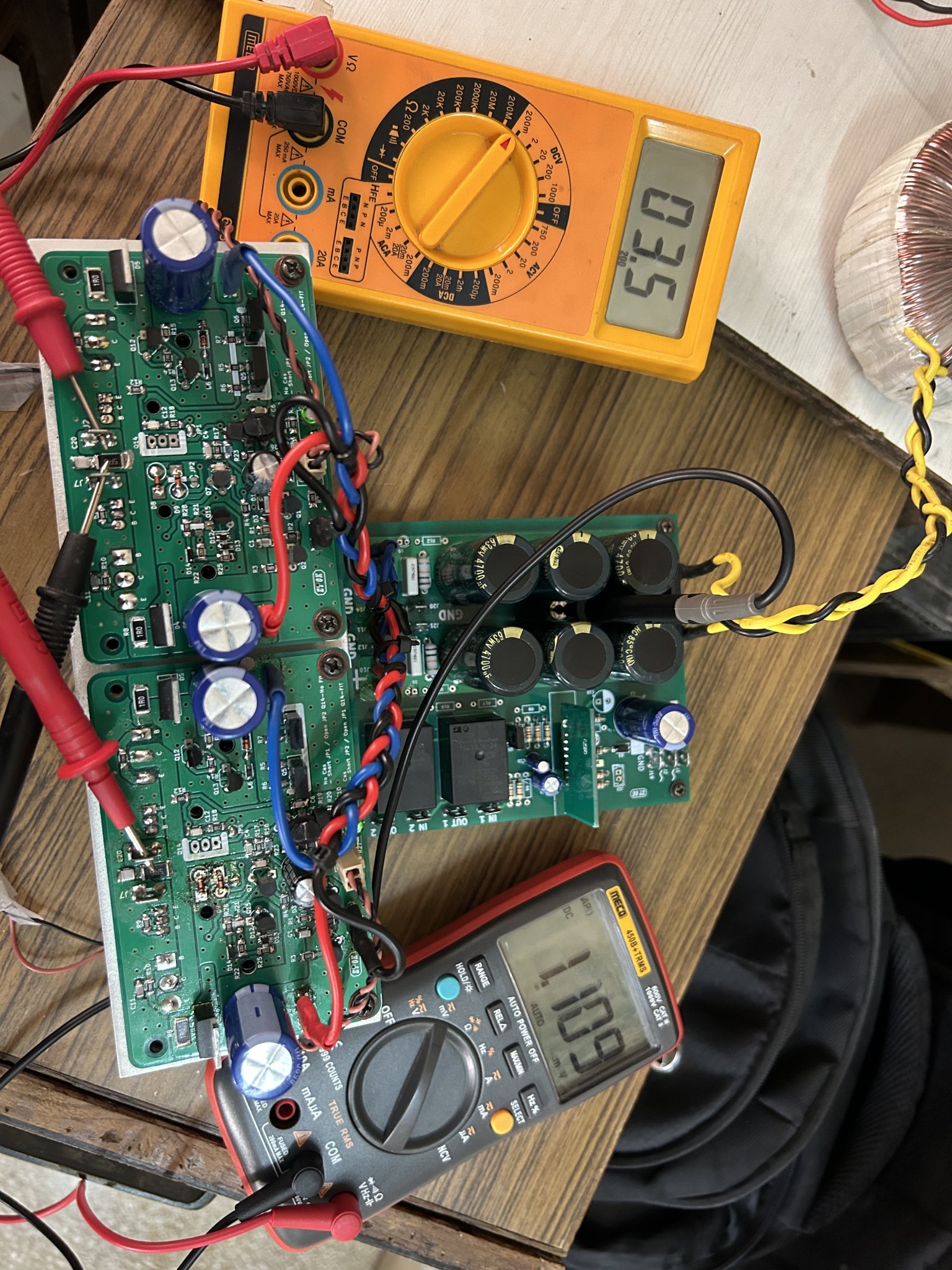

Hi Guys,
Ok so I have assembled both boards, and powered by +/- 21 DC,
1. Rail Voltage - 21V
2. Offset Voltage -
Orange meter Left channel 3.2 to 3.6mV
Red Meter Right channel 0.9 to 1.3mV
3. Quiescent Current - ~150mA (input short)
4) Heatsink Temp after Half hour - ~ 40
degree centigrade.
5) I will be checking the outputs on scope once I can manage one. Currently my meter’s frequency counter does not show any oscillation. ( not the best way but still).
Components Used
1. Transistor BC556B - Philips
2. Transistor 2N5551 - On Semi
3. Transistor VAS - KSC3505 + 4.7pF (ON Semi)
4. Transistor CCS - MPSA42
8. Output Transistor - 2SC5200N
11. Toroidal Transformer - 16-0-16 4.5 Amp
12. Rail Capacitors - 3 pair of 4700MFD 63V (Samwha)
Problem - how to make left side offset similar to right side.
