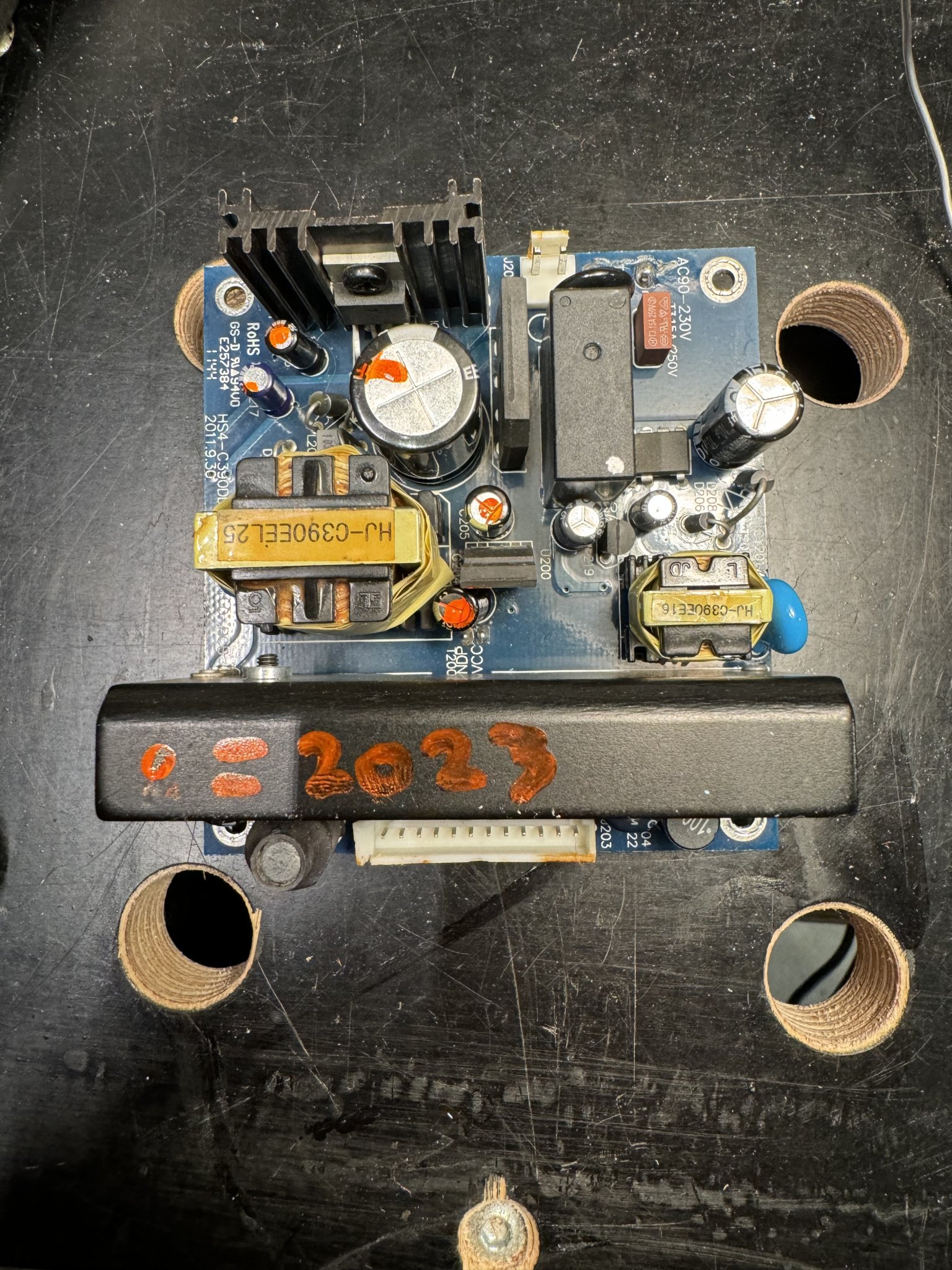

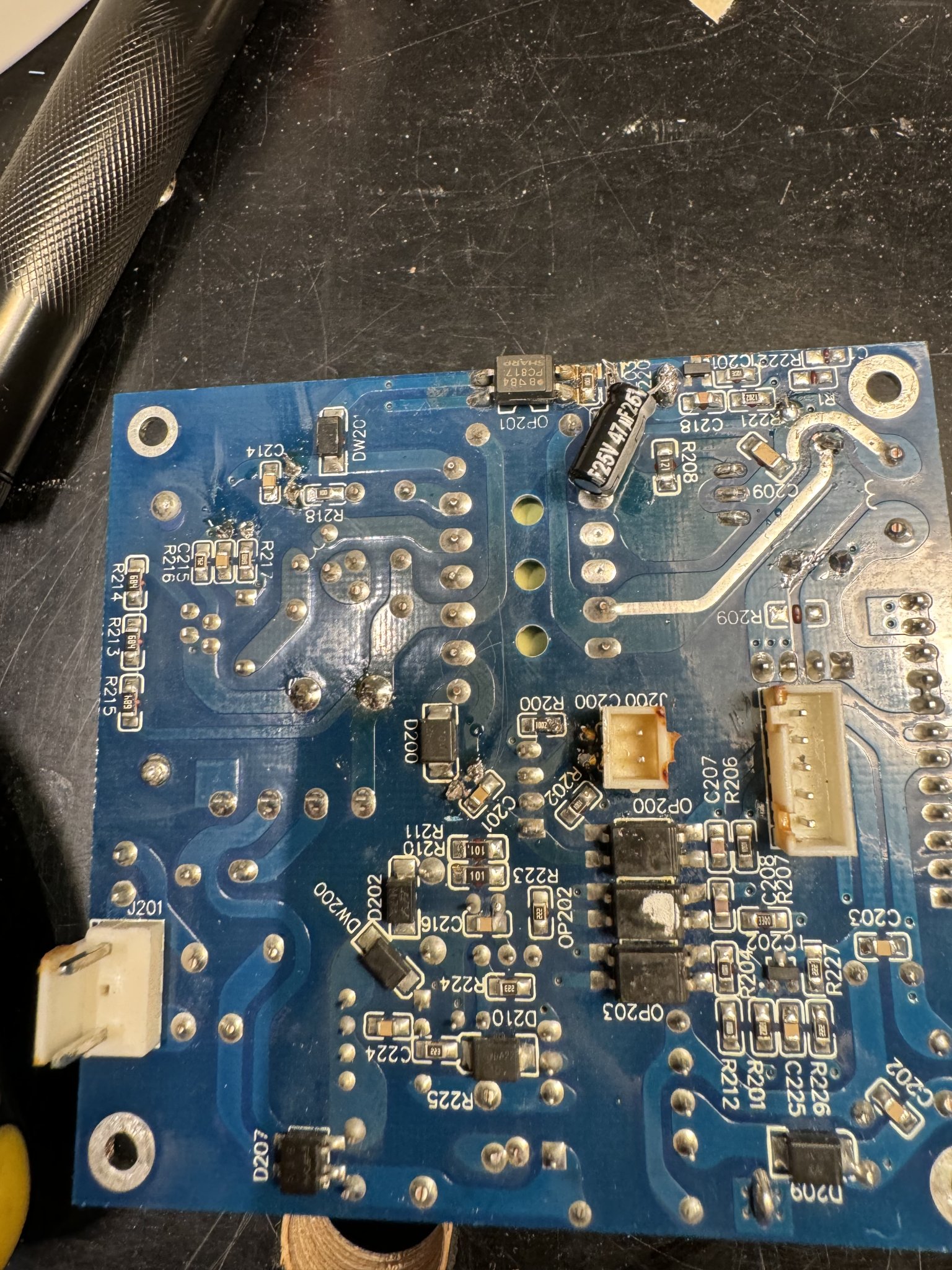

Thanks for the advice Johnips. I’ve just fitted a 10uf 25v capacitor in the suggested location, still no success. The 5V is present but measuring at the output plugs of the psu b board the 12.5V is definitely not starting up. I pulled the MDC cards in case the fault was there. No dice.
Photos for reference.
Pulling the MDC cards is a bad idea, and I experienced it beeing a cause of not starting up once. I would opt for a larger cap than 10uF as this is right on the threshold, but should start any way. Have you changed the caps around and including the high voltage one?
